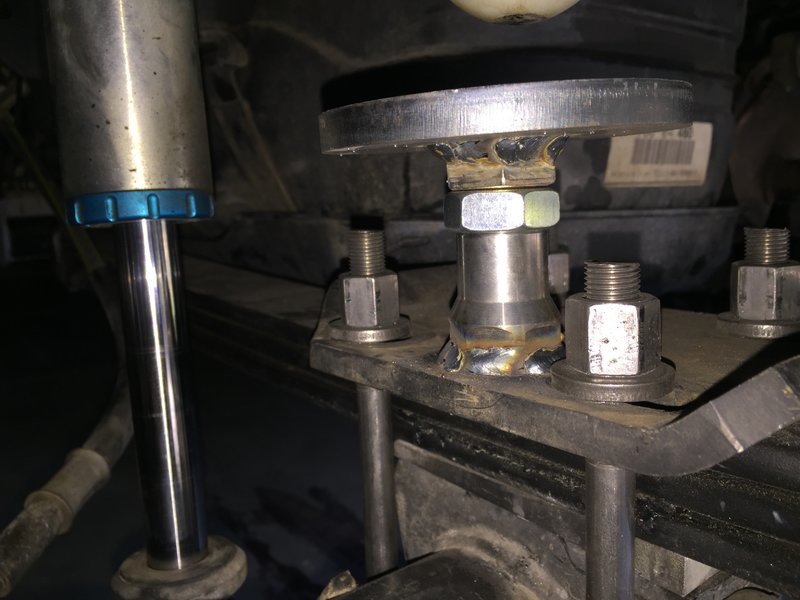

    Wow, looks awesome dude! Super jelly of those air bumps! How much space at ride height do you have before contact?

    Thanks man. I have about 4" before contact. I have about 5 1/4" of up on the shock. I had to make a adjustable bump pad cuz I would bottom out the shock flexing before bump would touch.

    Looks good. So 4" Fully bumped so you have 2" of untouched uptravel before the air bumps start working?

    4"untouched, then 2" of bump stop shaft. I'm left with about 3/4-1" of shock left when fully stopped. I need to adjust psi on bump cuz I feel it contact when going fast over speed humps.

    Oh damn... Lots more uptravel than me :jellydance:
    I'm unsure of what to do at this point thats easiest. Add to my leaf pack or get a longer shackle.. I really don't want to cut and move my rear shackle mount.

    Yeah, before I did the swap, I had no up travel with the shock relocation. So, I basically set the height based on having more up travel. I set mine at 6" of up, knowing it would settle, which it did. Ass sits a lil high, but I'm fine with it.
