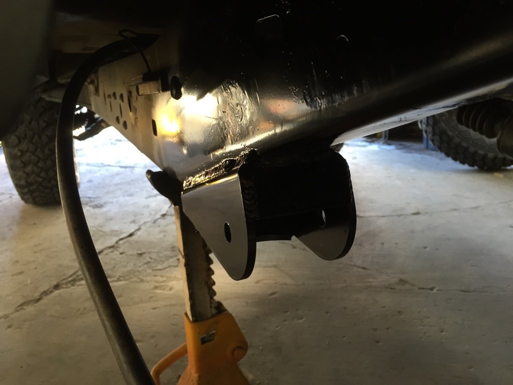

    Sorry if this is already been brought up, gave up while scrolling through the pages.
    The OP pics of the front ruff stuff spring hanger... isn't this backwards? Shouldn't it be like rattletrap's on page 5? I'm a first gen, but this is a fantastic write up swapping leafs one the less.
    Thanks for the detail.

    @dakotasyota I think @Een has you on that one buddy.

    I can't find his pic.... now I'm not sure of anything lol. I always thought the fronts were placed the only way they could go?

    Here's the correct orientation.

    Welp.... :anonymous:

    It hasn't appeared to affect anything?

    :rofl: Now you have to 3 link the rear!
    Don't worry about it. The wedge front is supposed to protect the leading edge of the leaf, but it shouldn't affect how the truck works.

    Lmao. That's still the plan!! Ok cool.... haha doh

    Shouldn't really affect things but your more likely to hang up on a rock, the ramp should help you slide over obstacles.
