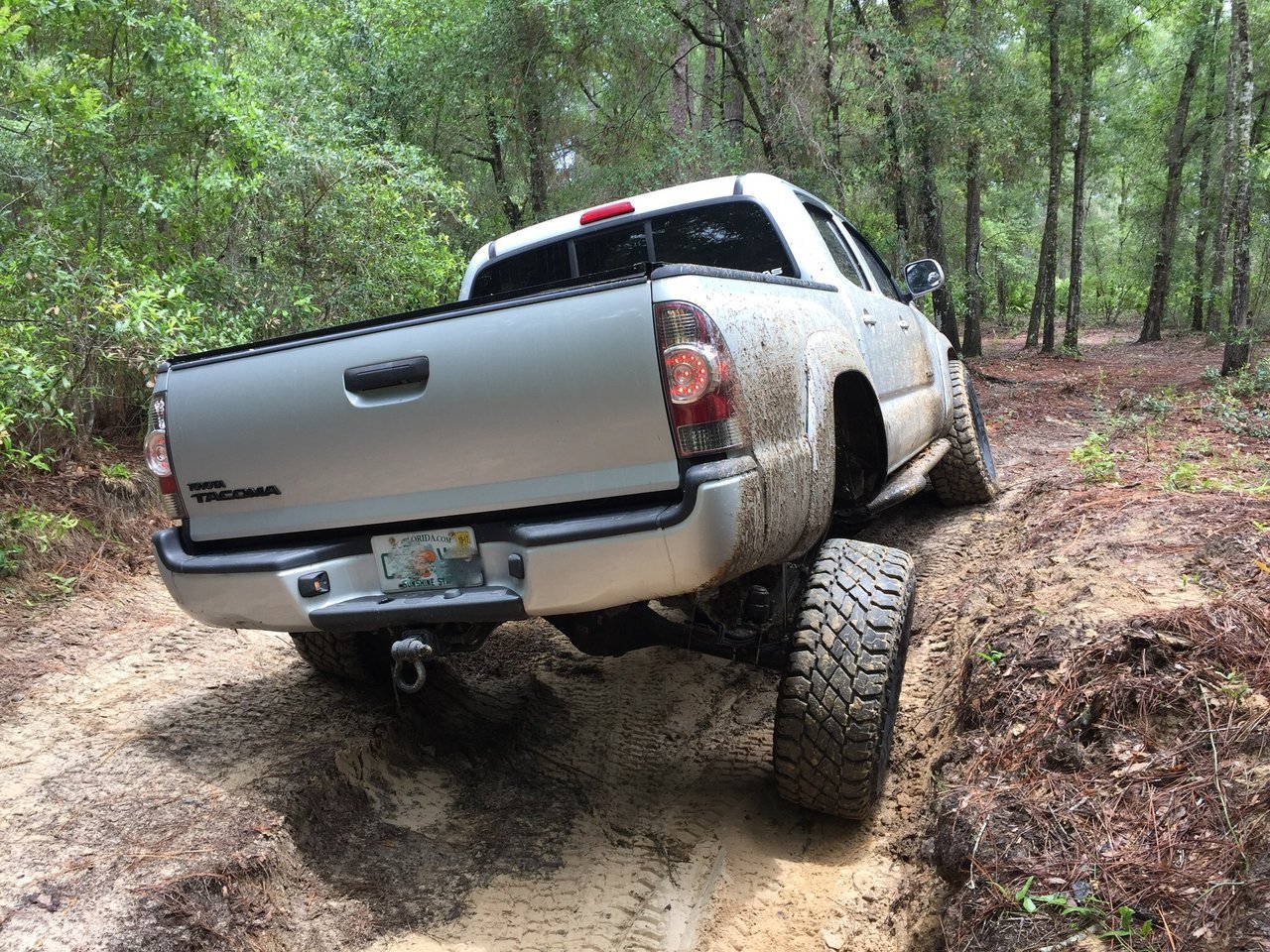

    That drop. :headbang:

    I wish I lived in Florida! That rear set up looks badass! CA is a long way from Florida!!!

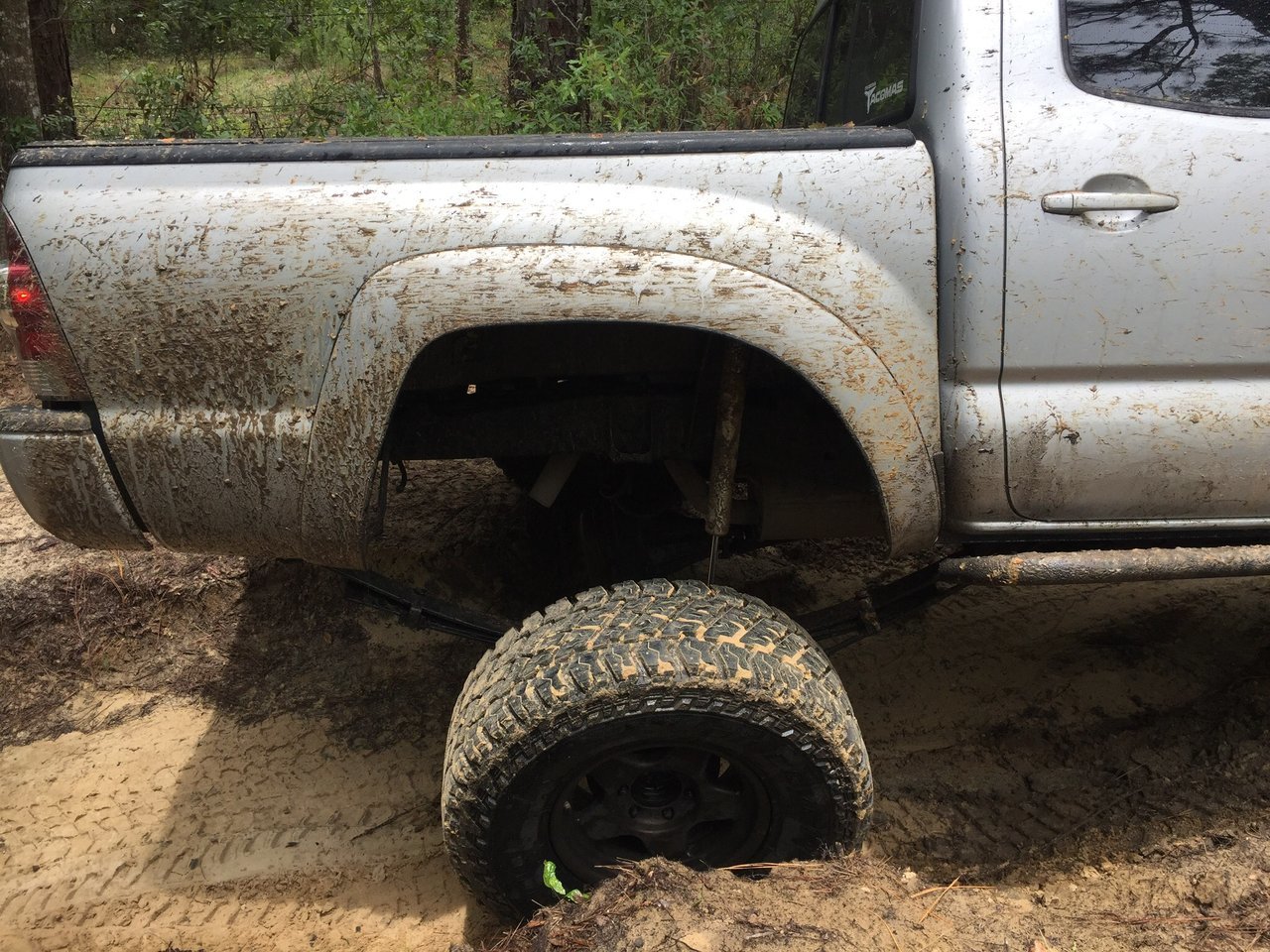

    Did you just move the shock hanger a couple inches up?

    It was moved up higher

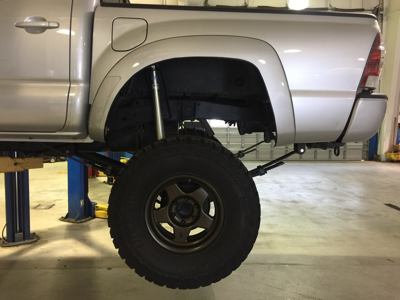

    What's your free uptravel and then your bump travel?
  13. Jul 8, 2017 at 1:10 PM
    #373
    Timbo's Customs
    Timbo's Customs Well-Known Member
    Aug 8, 2013
    #110078
    7,227
    Timothy
    Lakeland FL
    2019 f250 6”lift 37s deleted 1997 T4r, tons and 4ds
    1997 t4r has super duty axles, 5.13s locked front and rear. 3 link front with 14" kings. Rear 63s.
    Shock is set at 5" up bumps will hit at 4.5. He has spacers for the bumps if needed.

    Yall crammed a 2.5" in there? I'd like to fit a bypass in there if I could get 5" of uptravel
