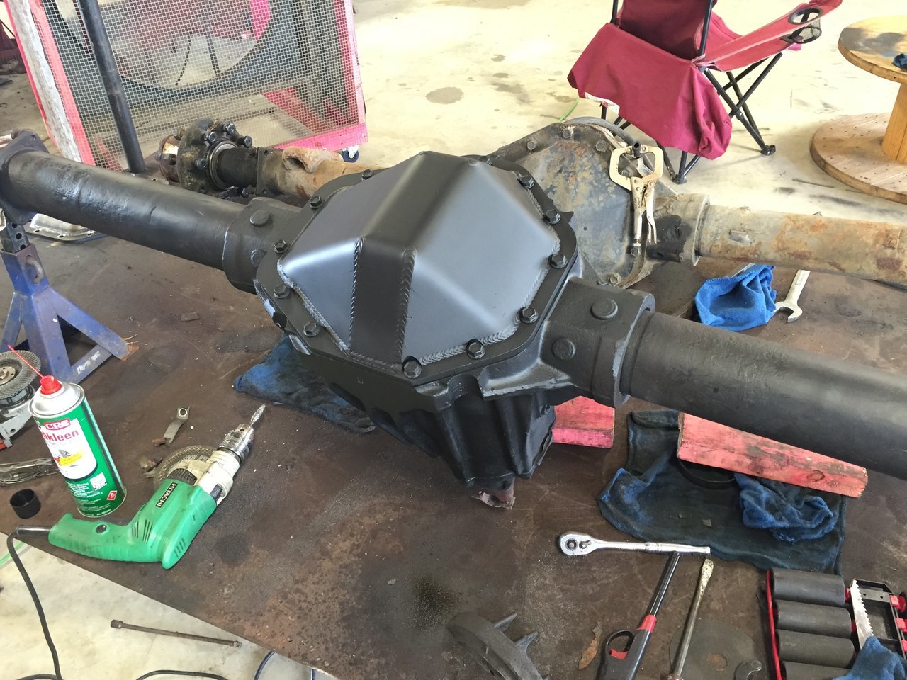

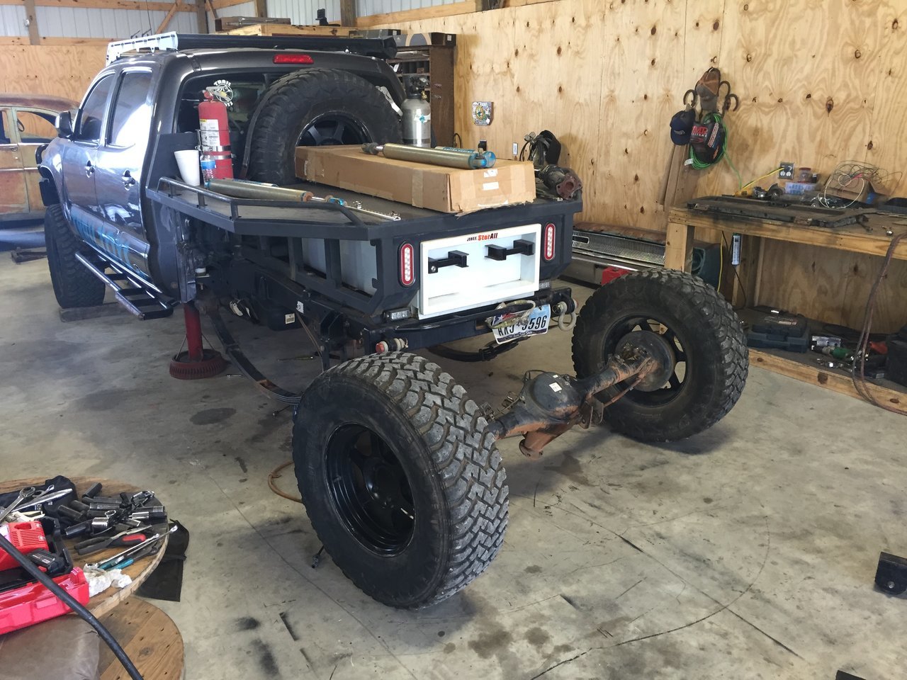

    My 63's are prepped for the new axle. :D

    Holy shitballs, the flatbed is badass

    Yeah it is! That thing looks way easier to work on the rear suspension with. :)

    Do you mind sharing where?
    What's the new axle going to be?

    14Bolt

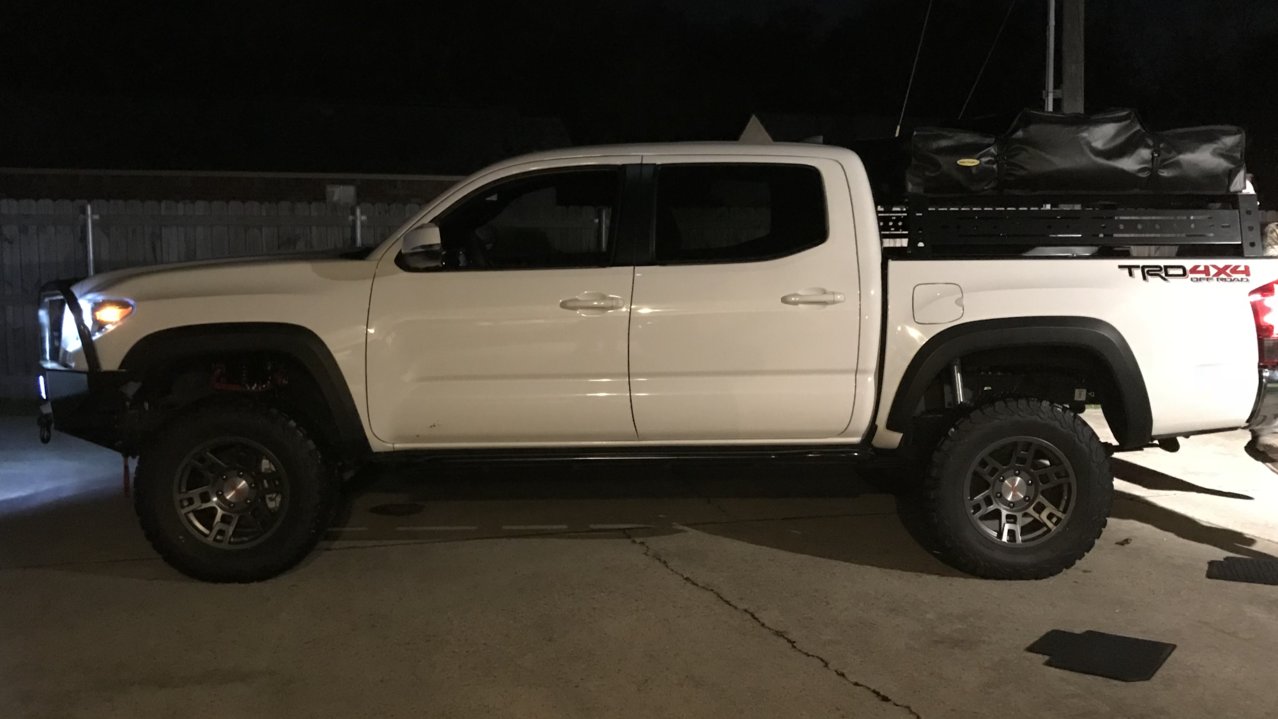

    Got mine finished today :bananadance:
    Ass end is sitting way high right now. I’m hoping it settles at least 1 1/2”.
    My dad and I were sitting on the tailgate in this pic.

    How's the ride quality now?

    The ride quality is absolutely awesome. I have a slight vibration when accelerating up to about 15 MPH. It isn’t bad, but there’s no mistaking that it wasn’t there before. Hoping that’s something that will go away once the springs settle? I did do a carrier bearing drop.
    Other than that, every little rattle and knock has me paranoid that I forgot to tighten something. Lol

    What length shackle did you end up using? If you want to lower the back end you'll most likely have to put a shorter shackle in.
    Your vibrations are coming from the driveshaft. If the springs settle in or you put a shorter shackle in that vibration will most likely go away.

    Mine did that too. It'll go away.

    Yeah, I knew the vibs were coming from the drive shaft. I’m just hoping it settles enough to correct itself. I have 5” shackles. Sounds like all I need to do is wait.
    It’s just when you take a truck that’s not even a year old and start chopping/welding on it, every difference in sound and feel...
    well, let’s just say there were a couple of times I asked myself “WTF did you do?” Lol
    I just can’t get over the ride though. It’s like a Cadillac.
