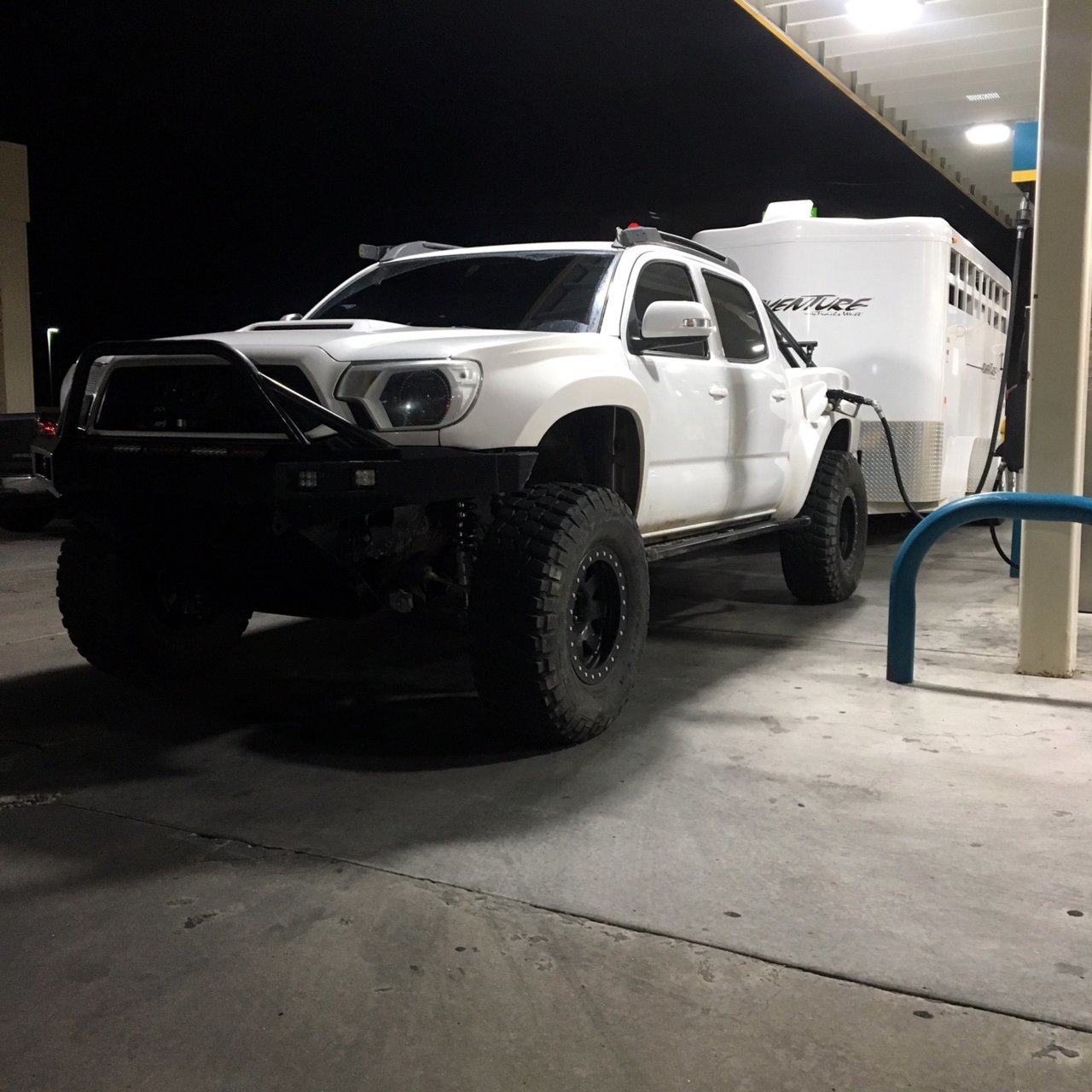

  19. Apr 13, 2018 at 9:18 PM
    #439
    Ariyan
    Ariyan Well-Known Member
    Mar 3, 2014
    #124459
    500
    NM
    4x4 TRD Sport
    SAS, 40s, and some armor.
    3 leaf pack with no over load. My 18' horse trailer full when we moved. definitely squatted
