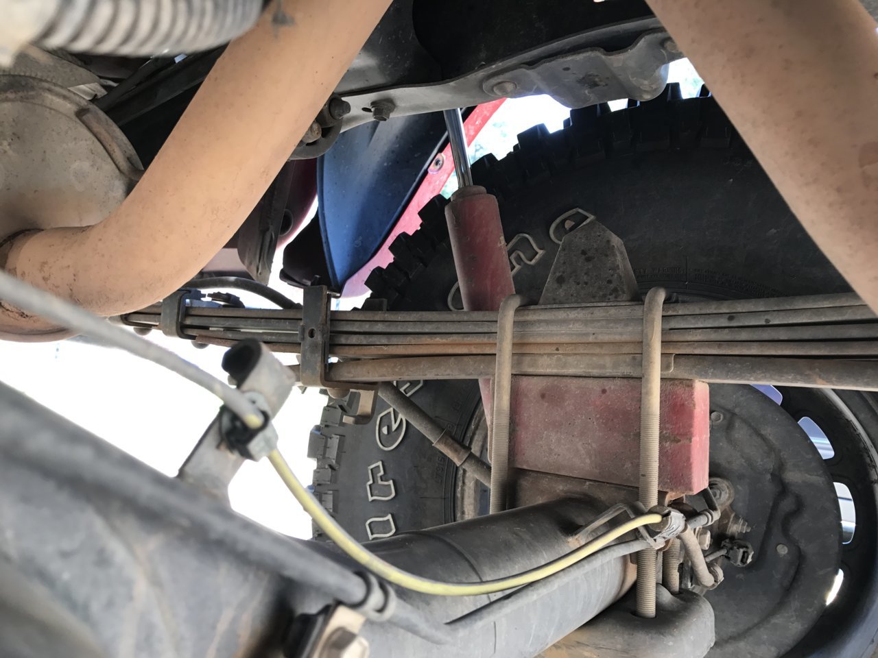

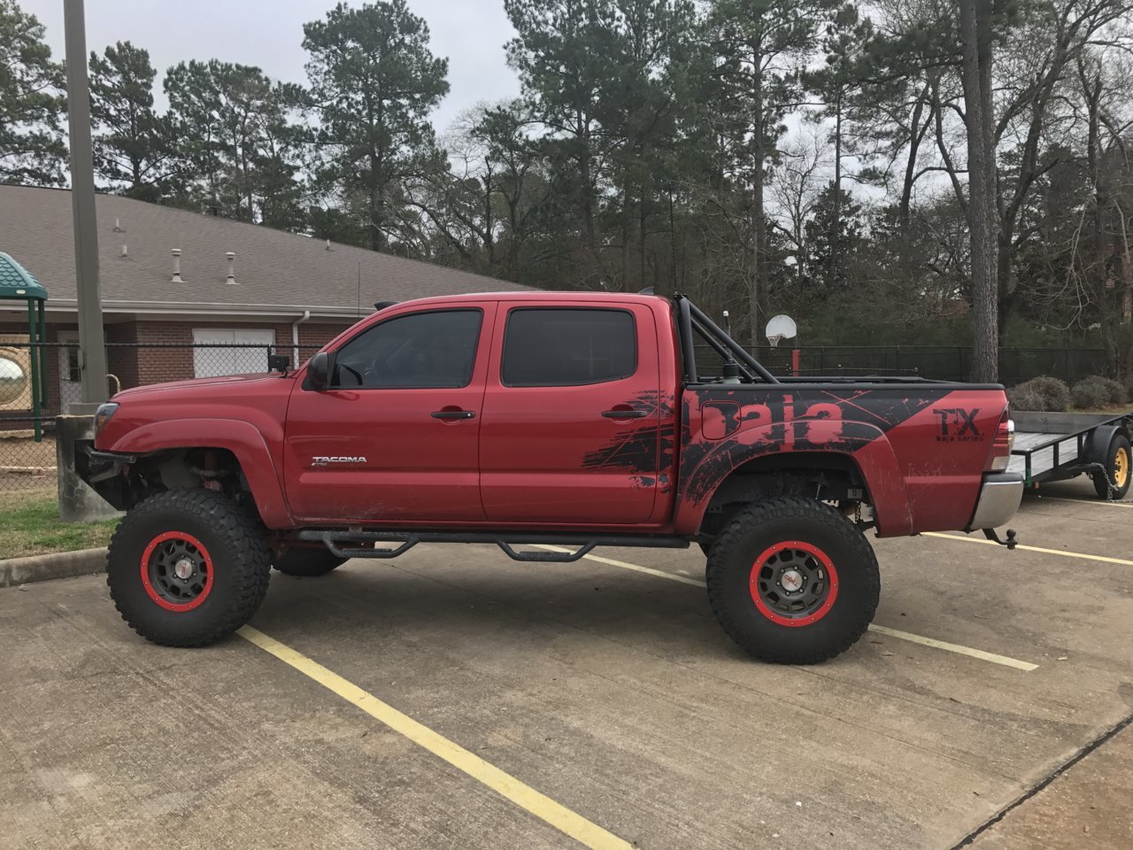

  18. May 3, 2018 at 6:35 PM
    #458
    Bebop
    Bebop Old fashion cowboy
    Feb 11, 2016
    #177835
    4,407
    Nick
    Castle rock Colorado
    2012 Toyota Tacoma baja
    6inch lift sitting on bilstein coilovers. Lexus is300 studs in front to keep stock wheels, general grabber red letters, nfab front bumper.
    Most of the time she is a pavement princess. My big thing is weight, with both motorcycles in the bed and the yxz on the trailer I’m damn near bottomed out.
    NABeast[QUOTED] likes this.
