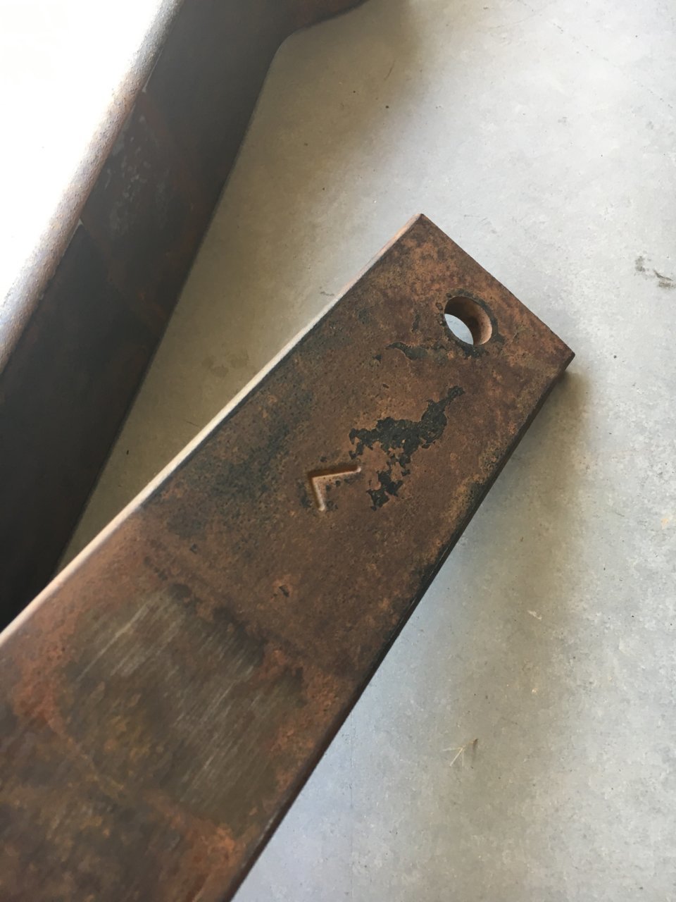

    Does anyone know if the L marking on the springs has to go a certain way. I swear I kept them in the same orientation but I might have messed it up. Every spring has one. Wondering if they have to go the same way.

    I’m not sure if it matters, but i think they go towards the front. I will check tomorrow. I marked the original orientation of them and mounted them the same way.

    Ok, sorry I forgot to look the other day. I have mine with that mark towards the rear, which is the original orientation.

    So I will put all 6 L marks towards the rear?

    Yes. Even though it probably doesn’t matter. Most other leaf springs come with a military double wrap that goes in the front. These chevys are just plain spings.
