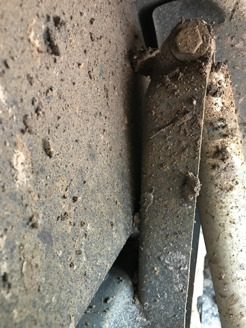

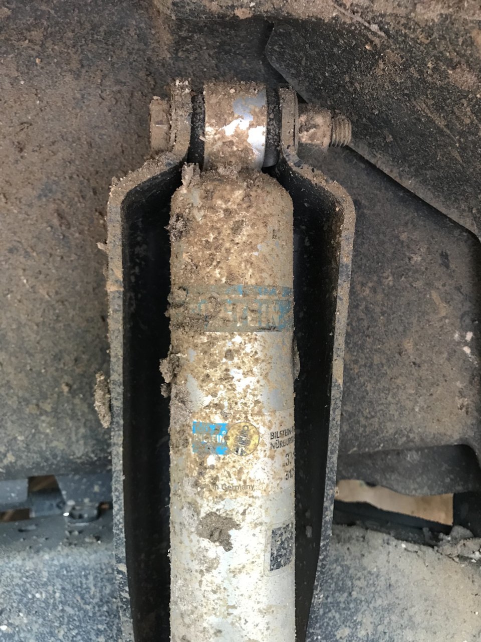

    Probably not
    I have scs wheels and 1.25” spacers and barely rub the shock at full stuff
