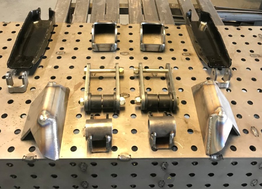

    I got all the weld-on components assembled and welded on the work bench yesterday. RuffStuff makes good products from what I can tell so far. I've got one question however, should I go ahead and buy the limit straps and the mounts now or wait and see if I even need them once everything is welded to the truck? I have no plans of running the truck hard until everything is buttoned up and solid so there's no rush there.

    Personally I would wait and see what you end up with then order the straps and the stuff. I kinda had a clue where I was going to end up and bought some 17" straps from another member on here.

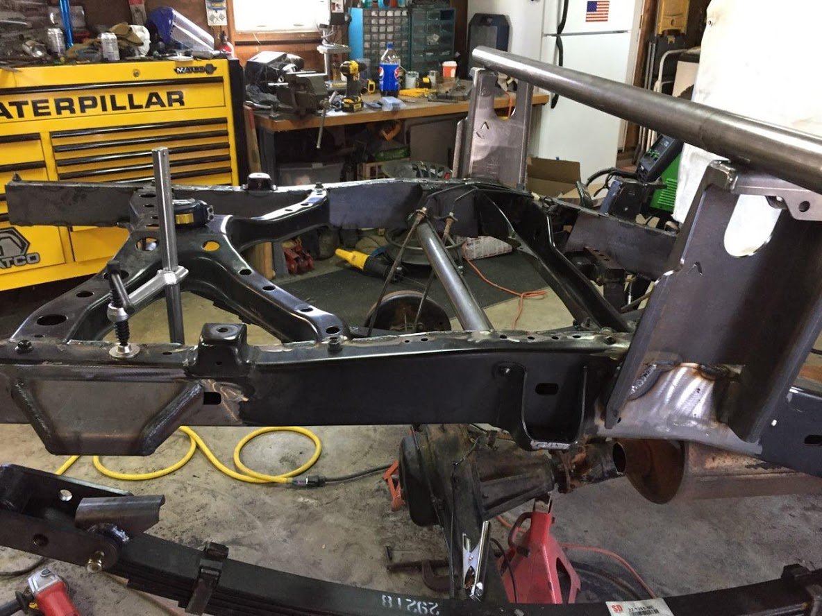

    Plated frame, 63s, 14"king 2.5s, AG relocations DONE!!!!

    Gotcha. Looks like I'll be running a similar setup as you as far as measurements are concerned. I'm going with Ford shock towers and 14 inch Bilsteins. Are mounting the upper limit strap mount to a crossmember that you're going to fabricate or an existing location? I've thrown around the idea of just boxing my frame and reinforcing the rear with tubing while I've got the tank and bed off the truck.

    I plated my entire rear frame section and put a piece of round tube in. Billie 14" are shorter compresses and extended than King 14" these things are YUGEEEEE!!! I set my shocks to have 5" of up and 9" of down travel and with my AG relocations up an extra inch I was able to set my lower shock mounts really high thus not having anything but the diff hanging low now.

    I can't see the picture unfortunately....
    When you ran the round tube across your frame, did you weld it to the inside of the stock frame rails, then plate around it when you boxed the frame? Not sure if that makes sense or not.

    Naw boxed the frame first then added the tube plenty strong enough that way. I may add some triangulation tubes to it and then some bracing forward towards the cab to further stiffen the rear chassis up. It's amazing the difference there is with the suspension doing the work vs. the frame.

    Right on. You use 3/16" or 1/4" for the frame plates? I generally work with 3/16" and have plenty of that. But if there's justification to go ahead with 1/4" I will. As thin as the frame on these trucks are though, I feel like 3/16" would be plenty.

    I went with 1/4" because the steel place I stopped at couldn't get me 3/16" for a few hrs and I was in a rush. So I found enough 1/4" drops and then some and used that. In reality 3/16" is probably good but Having a little extra weight of the 1/4" is nice.

    I've got half a sheet of 3/16" at the house so I may double stack the plate in some spots if I feel the need.

    The DS front area is a PITA it didn't get plated quite like I would of liked due to brake line interference and a bracket for the gas tank. But I can go back in there and do some more if needed with braces or something.

    I was thinking about that. Almost be better to reroute the brake lines external from the boxing.
