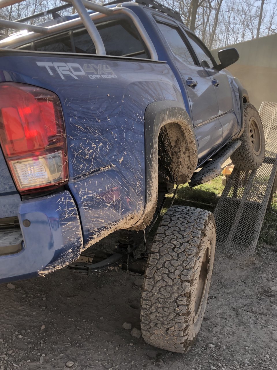

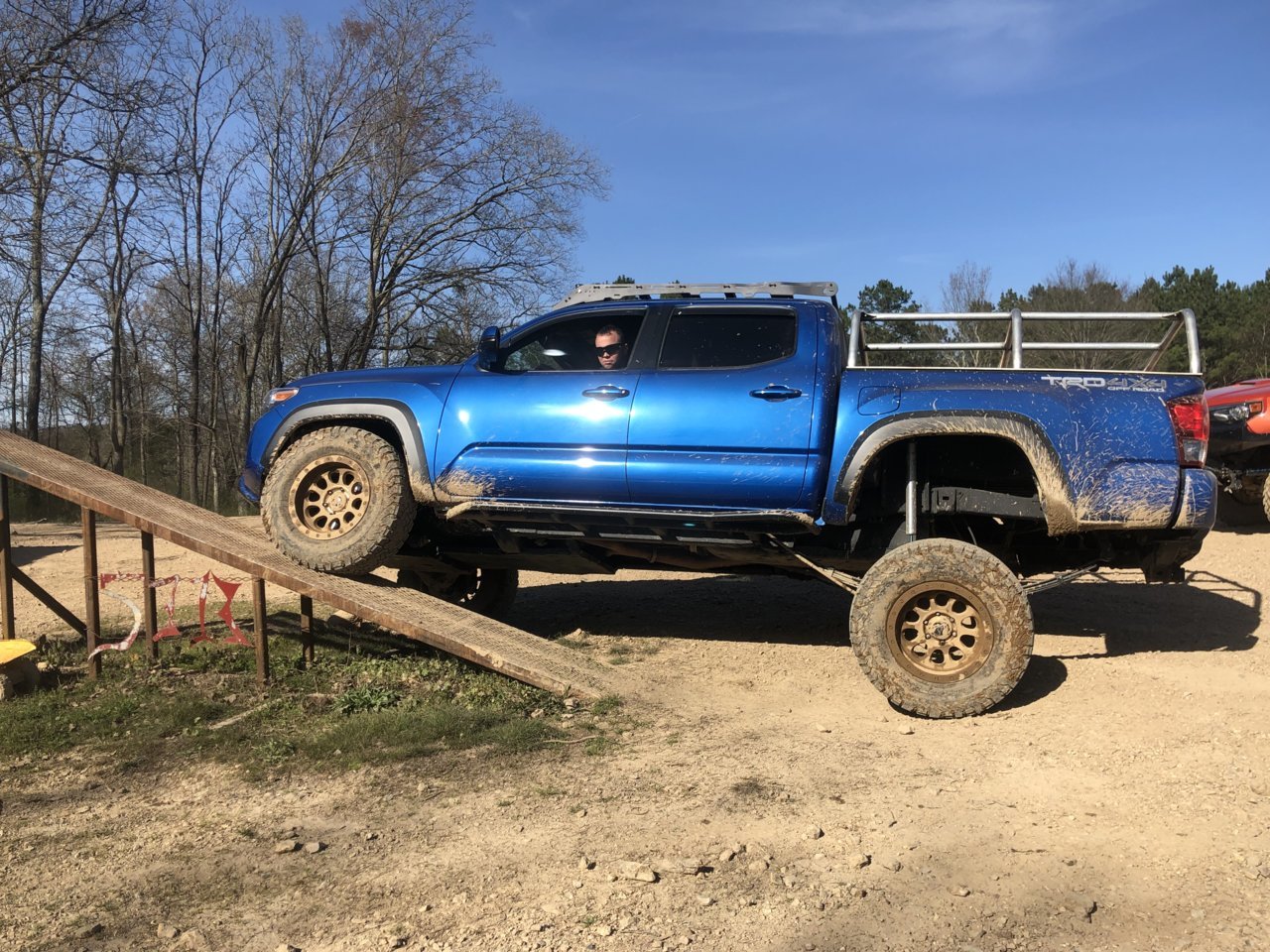

    All-Pro Apex sliders Mobtown full skids SCS Ray 10s brushed copper Chevy 63 swap
    Is it time consuming yes if you want it to look really good and be straight ESPECIALLY when you do it by yourself... minus texts and messages for help... but at the end of the day I don’t think there is anything better then it... ok 3 link and 4 link are different animals.
    I have 285/70/17 looking at going to 35s or 37s if I get UCAs

    If you want to see more my instagram is @tacomaturnerfab

    I think that's the first 3rd gen 63 swap I've seen! Looks killer man.
