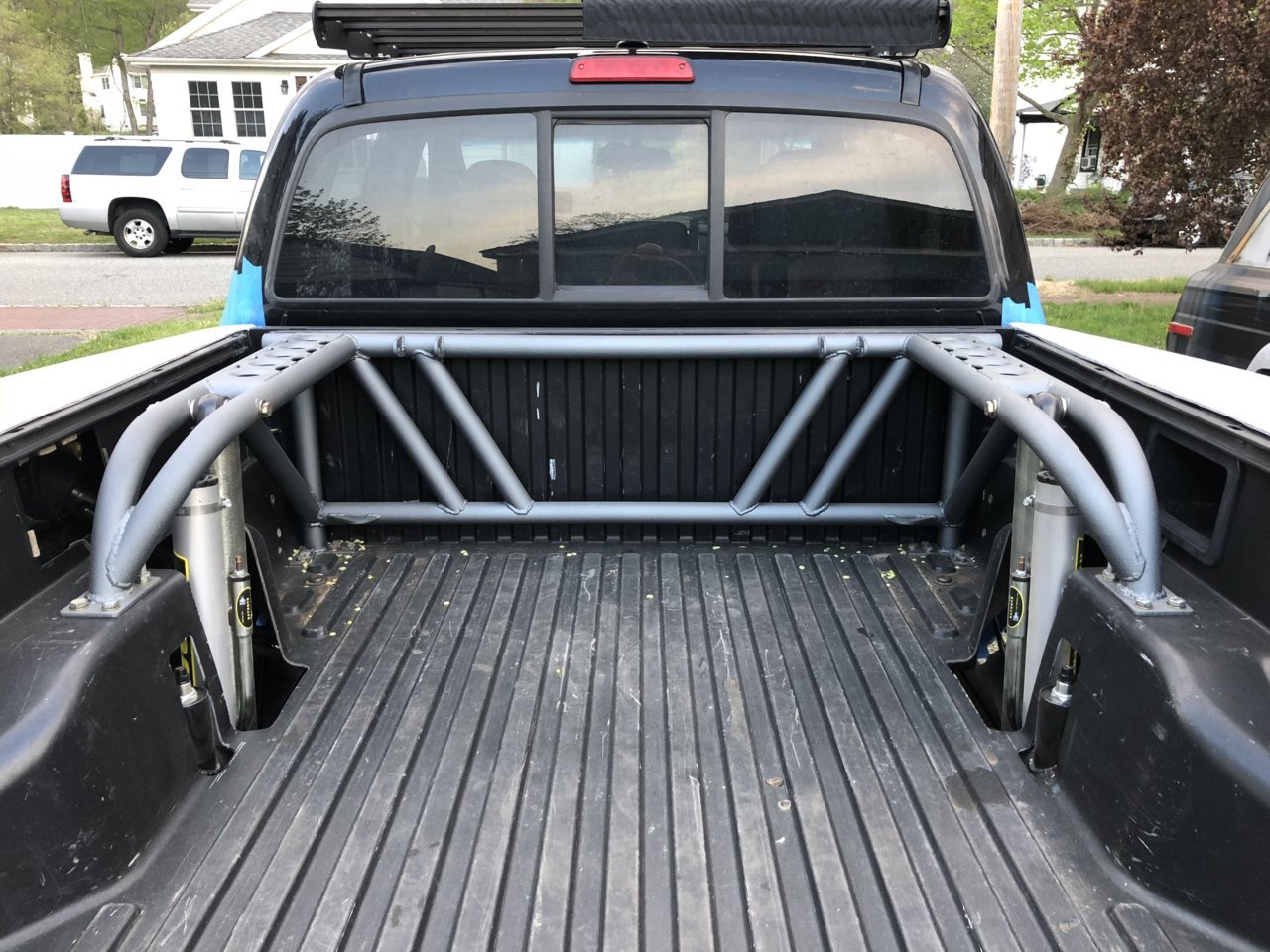

    Take a look at mine. I used 2 pieces of tubing. I could've still pushed it higher by about an inch or so though if I wanted but my shocks fit so I wasn't too worried. To fix that I could've integrated the top shock mount in to the tubing but like I said, it wasn't necessary for me.

    I've go it on my list of things to build, but my intent was to have the shock hoops welded to the frame and bolted through the bed where the bolt heads would be coming through the wheel well. Those bolts would then be attached to a cross brace that would tie both shock hoops in together inside the bed and in to the front two bed bolts. So technically no "cutting" but a little bit of drilling. Hope that made sense.

    No it does I've been looking at cages that really keep a lot of space in the bed still. Brings some more rigidity and makes some easy places to make for mounting things like my spare.

    I really would like to do a combo of these 2 minus the shocks and tubing going through the bed.
