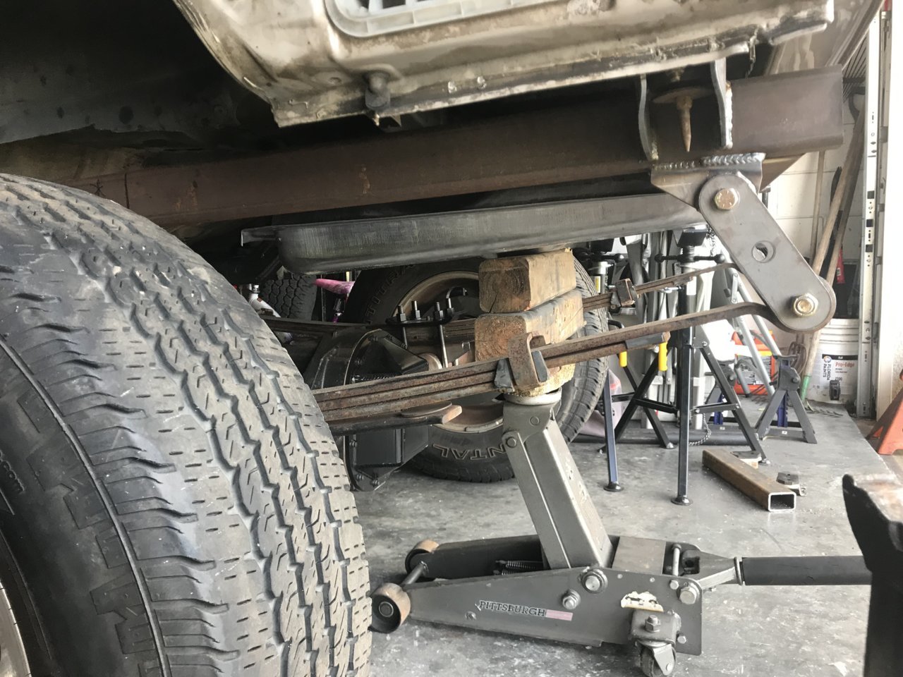

    1997 t4r has super duty axles, 5.13s locked front and rear. 3 link front with 14" kings. Rear 63s.
    Setup on the 4Runner not sure the angle as I setup with the axle at full drop and set from there

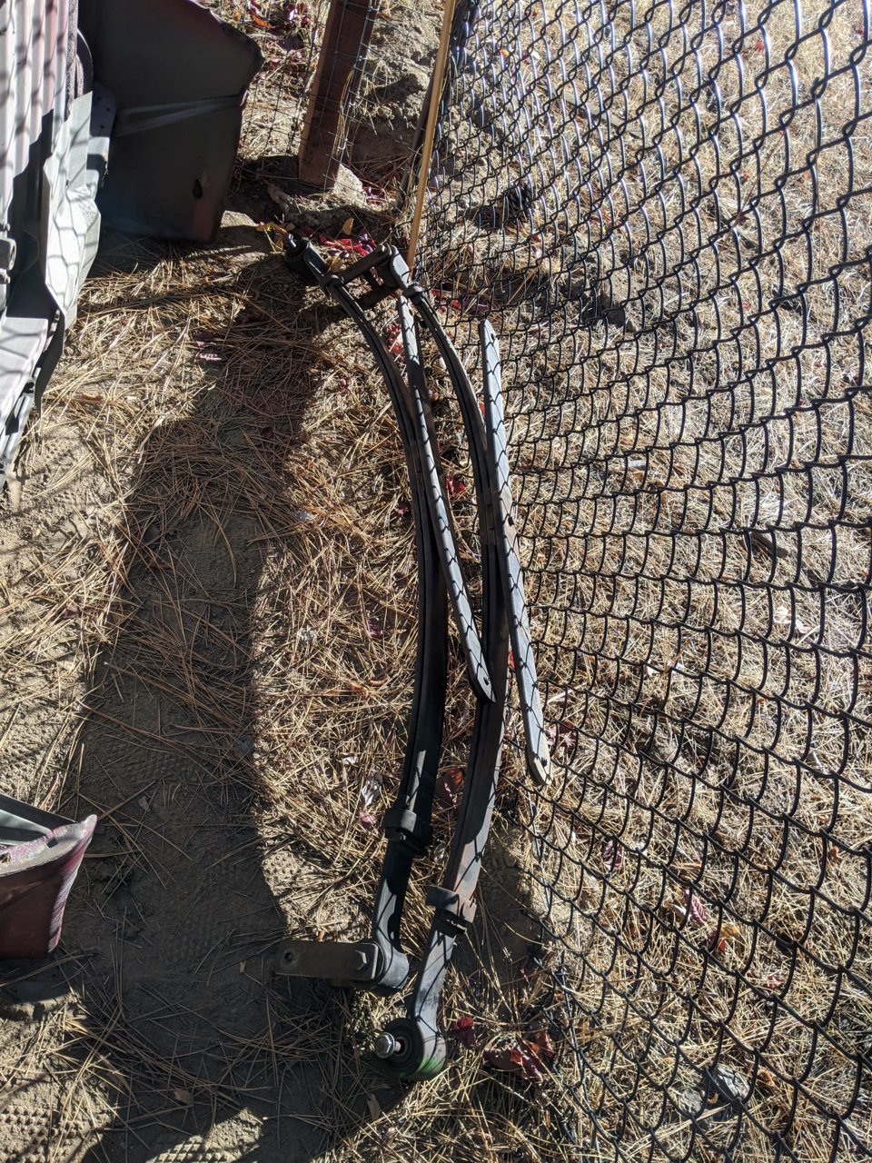

    If anyone is interested in doing this. I have a set of springs and shackles.
