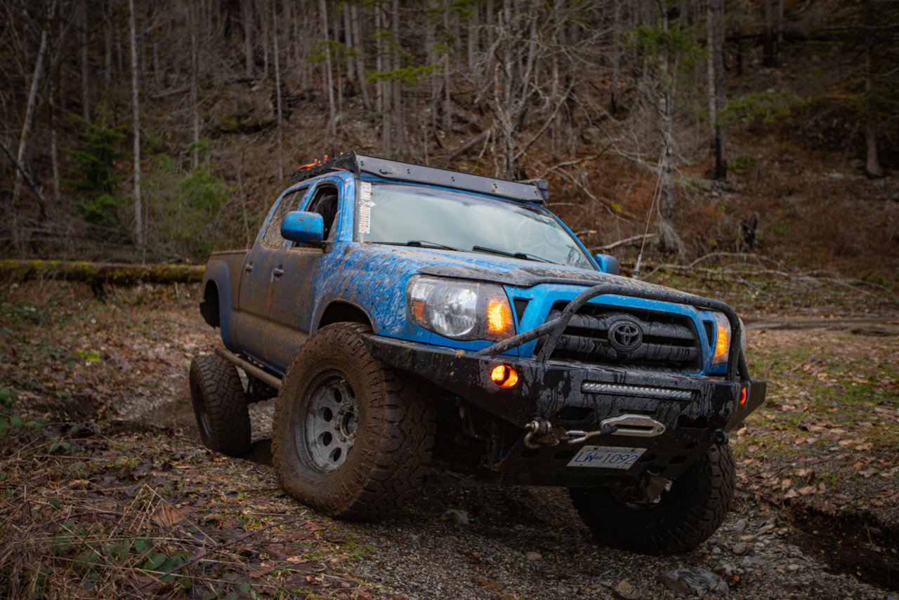

    I fiiiinnaaaally got some time to do the 63 swap, after having the parts for almost a year. Super stoked on how it's all working! I made a couple posts in my build thread with more pics (HERE). But here are a few pictures of it all finished.
    Ended up doing 4 leafs, no overload (I bought a 2500 pack and a 1500 pack from the junk yard and mixed them up). 16" shocks. Extended the bumps 3". And I got 30" brake lines, which are more than long enough. I had to do a tonne of work on my frame to clean up all the rust, which is probably what took me the most time out of everything. That and the bed cage took a little bit of figuring out as well to try and save as much bed space as possible.

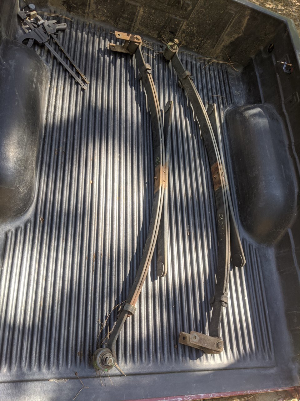

    If any one is still looking to do this I have a set for sale that were on a 96 first Gen Tacoma.$100
