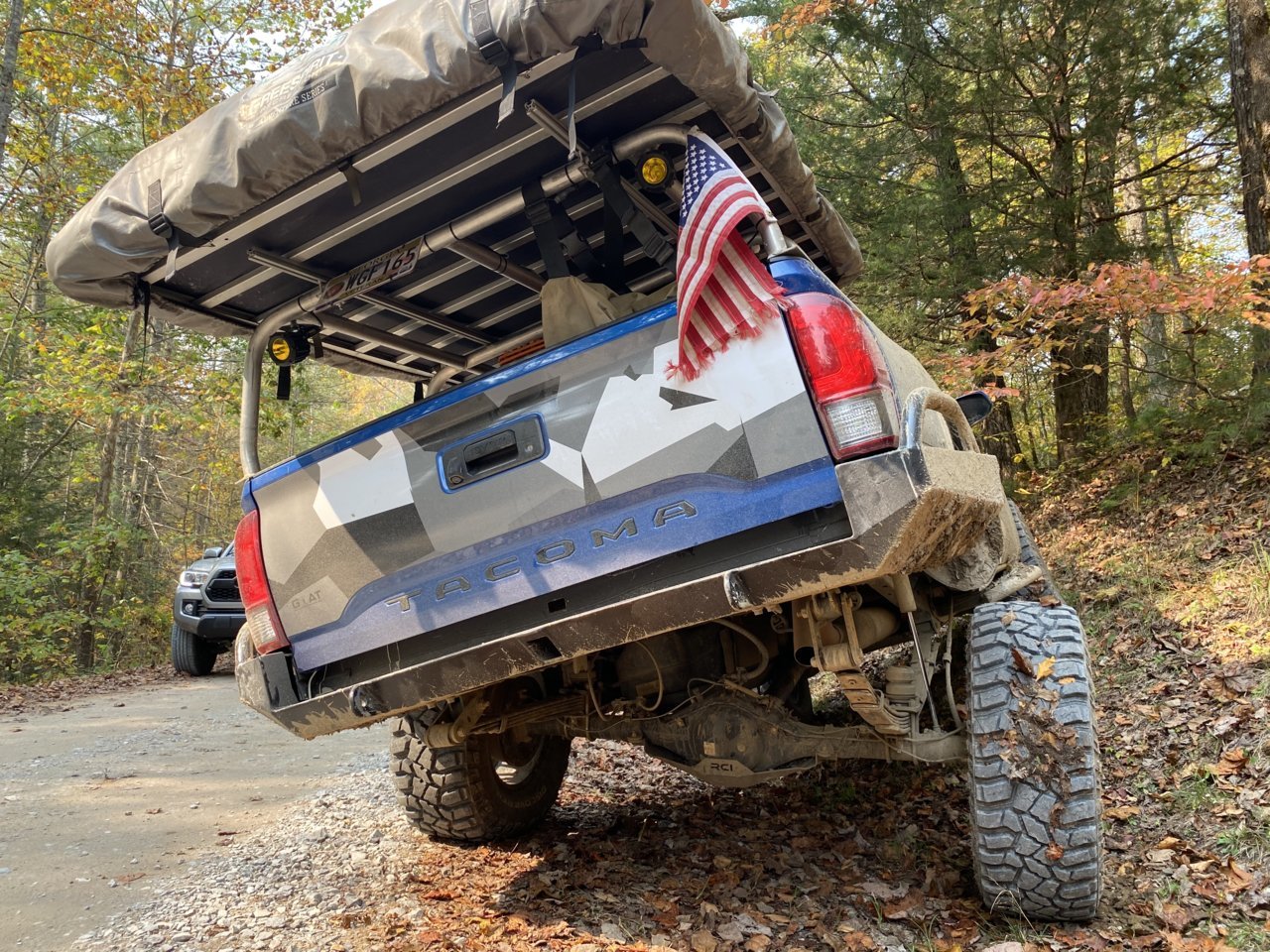

    I have been running my set up for a while and I don’t have limit straps and I haven’t had any issues. Now I don’t jump my truck or anything. Ok I may have launched it once but yea.
    I also didn’t extend my bumpstops. The wheels and tire set up is 17x9 -38 with 1.25 spacers and 315/70/17 the driver side is on the bumpstop. I have bilstein 14” shocks.

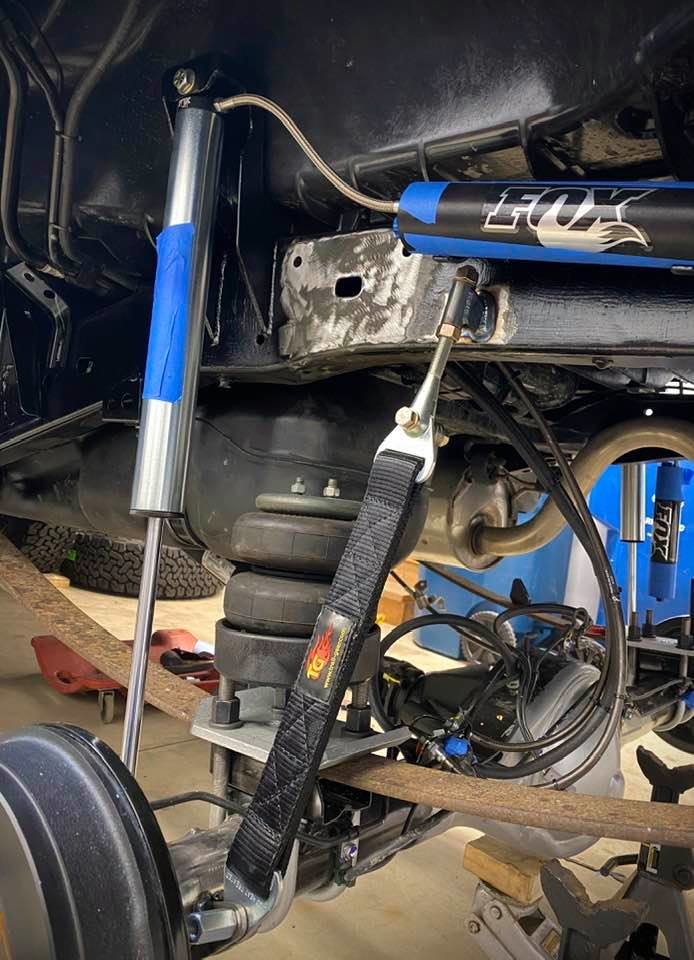

    highly recommend getting the shock set up first before buying the straps.
    I'm running a 16" strap with a 12" shock based on where I'm running the straps, plus wanting to bias towards a longer strap to 'soften' the stretch hit.
    as for shackle length, unless you just want to be taller for whatever reason, a 5" shackle is going to be plenty long with a 14" shock.
    I don't immediately see any benefit to going longer unless you plan on frenching in the upper shackle point.

    you don't need the limit straps to drive it on the street so you do have the option of doing the straps a different weekend.
    5" is a good starting point for sure!

    depending on how you plan on stretching out the strap, you won't be able to get to "full stretch".
    I sure wasn't able to.
    the general internet guideline seems to be 1" stretch per 12" of strap, so on my 16" strap I should expect up to 1.3" of stretch to be a 17.3" eye to eye.
    full weight of the axle and wheels/tires on just the main leafs (disassembled pack) didn't get me there. luckily if you add or subtract measurments as needed, it works out just fine.
    in my case, I just drooped out the 12" shocks completely, then made a "fake" limit strap with holes at 17.8" and burned the tabs in, so in theory they will be at max stretch of 17.3" when the shock has .5" more to go.
    the threaded clevis gives enough adjustment to fine tune from there. also makes making the right and left the same super easy, and the alignment of the tabs to be in-line with eachother top and bottom happens naturally with the "fake" strap

    All separate. I just made my own tabs but they sell generic ones
    If that was a reply to me I think you misunderstood what I wrote. I agree if you have the shock at full droop and the straps aren't stretched out you definitely set it up wrong, as it completely defeats the purpose of the straps, regardless of the construction/#of layers of the strap.
