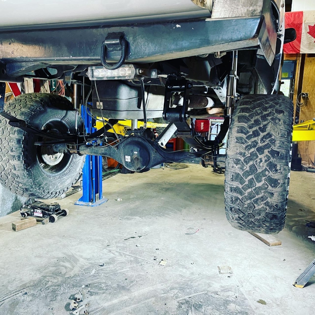

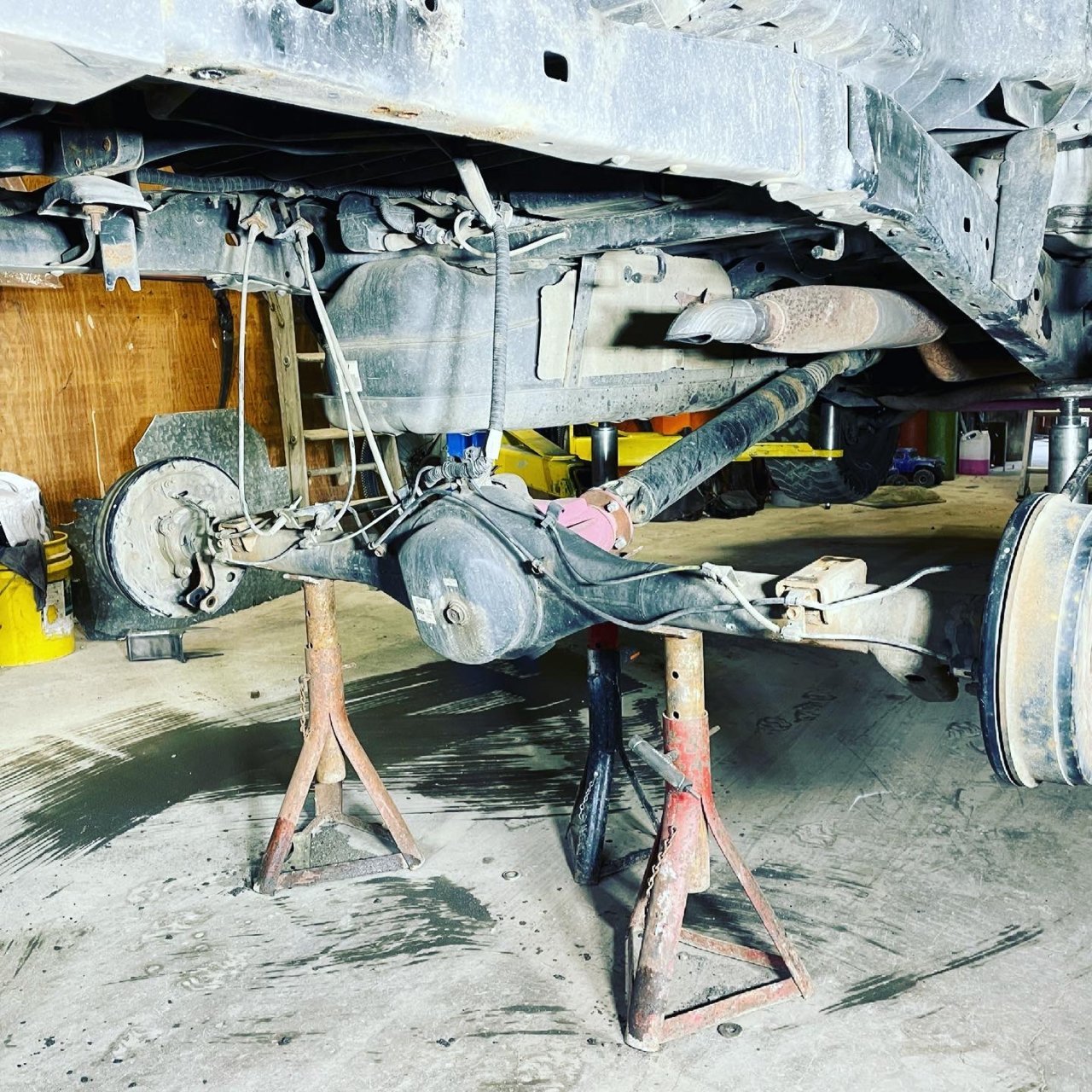

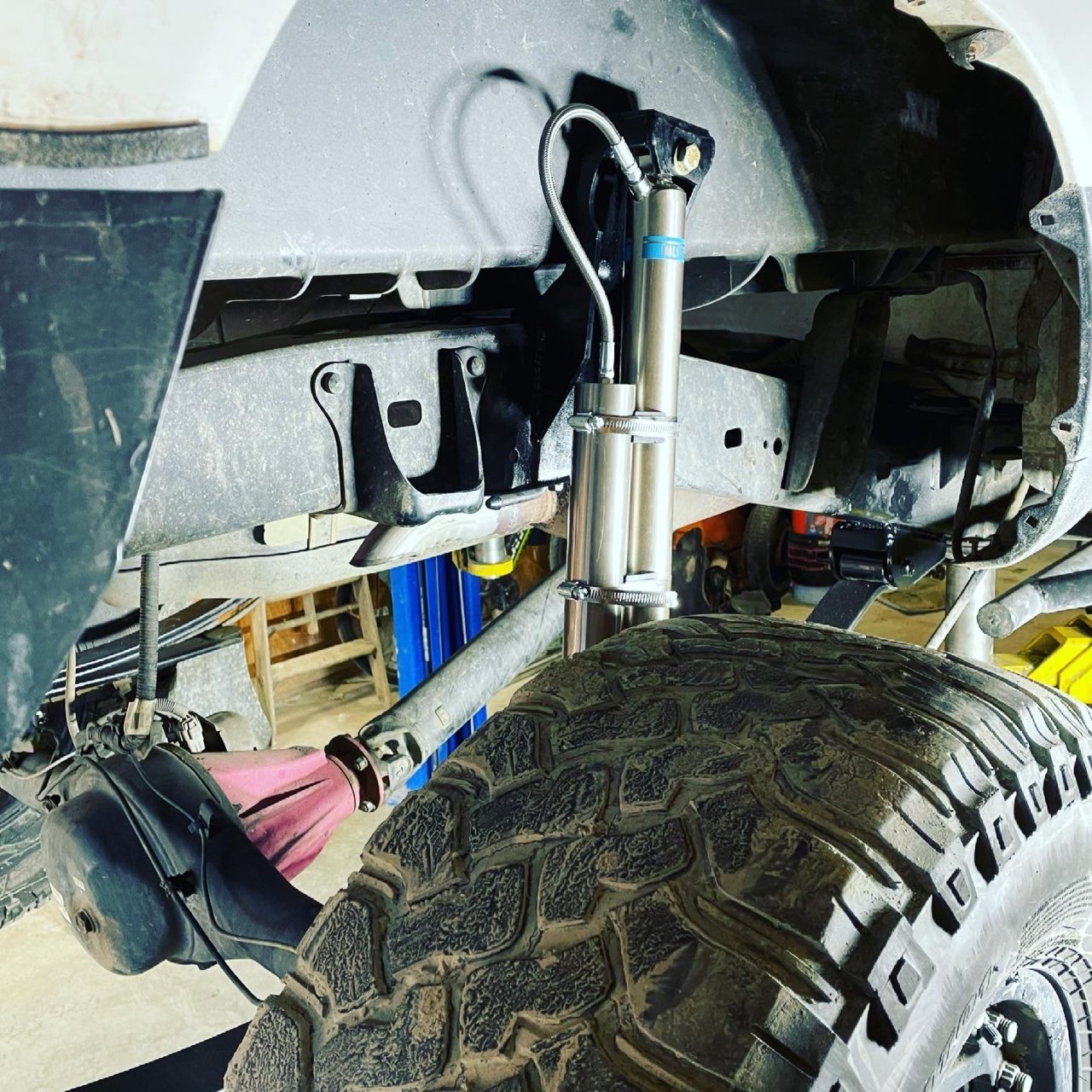

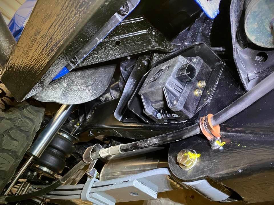

    Got it all in last weekend. What’s everyone doing for extended brake lines?
    Moving up to 37’s :D
    B473380D-BC8C-4F90-84E3-63904FB44FFB.jpg 370A9258-8E47-4736-A712-DD88D85AECDD.jpg FEFC07F8-2F8D-4729-98D7-788BACEBE415.jpg

    Havent done the swap yet, but in preparation i did custom stainless hydraulic lines from crown auto. I'd have to look but I think mine are something crazy like +9"
    You'll have to extend the ABS sensor wires too. Just cut them and splice in a short extension.
    For the ebrake, you can always swap in DCLB cables as long as you're not a DCLB. Not sure what the DCLB guys are doing for ebrake, if anything at all.

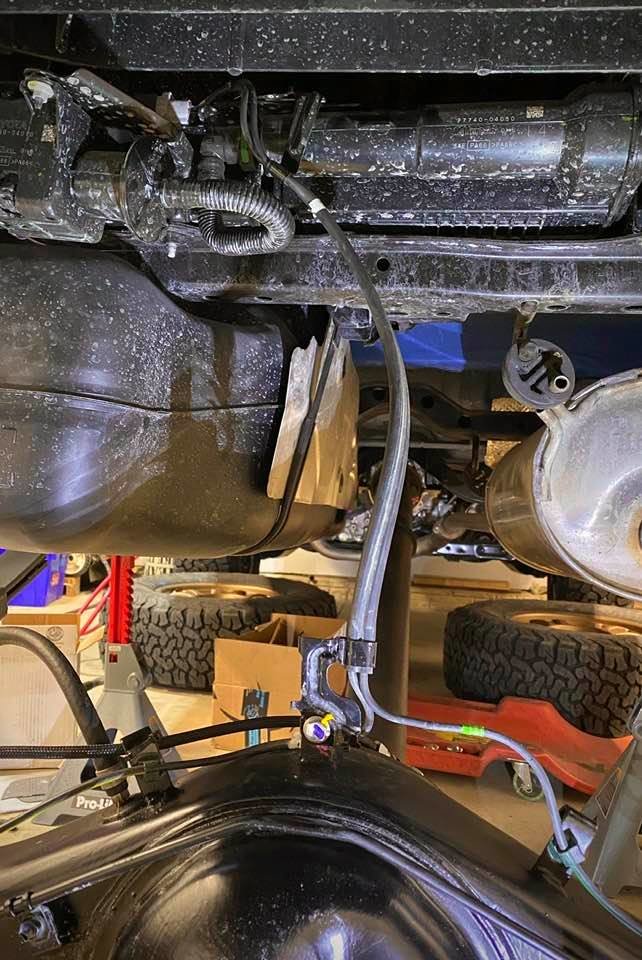

    i got +7" (28") brake lines from headstrong offroad
    122247537_10114122815336673_321864703005_ae869a25491217525a4f15f17148ca8c4f999d93.jpg
    little moving around and bending of brackets and i managed to get to full droop without having to extend the ABS lines
    138937835_10114476211892143_353004074398_7e78eccb6db9c7bcf21dd22e133c8ea979e72a61.jpg
    not sure why you'd need to do anything with the parking brake lines, they run basically along the front leaf eye so unless you are extending your wheelbase it should work fine as-is.
    it was fine for me, just added some clipping points back.
    154959488_10114667241517243_255638316271_c34767c41b173535479fba7471336b3980de32ce.jpg

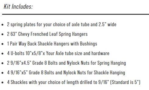

    I just got my Ruffstuff kit in and had a question about the bushings. After reading through the OP and this whole thread, I was under the impression that the RuffStuff kit comes with replacement bushings for the front and rear eyes of the leaf springs, as well as bushings for the rear shackle hanger. Mine arrived with only the bushings for the shackle hanger. I called Ruff stuff this AM and they said that the kit doesn't come with bushings for the spring eyes, and never has. I know there's at least 1/2 dozen posts in this thread with people talking about how much of a PITA the bushings are to get out of the leaf springs and how the ones supplied by ruff stuff may not fit pre-98 springs. I know there's a link to the energy suspension ones at the bottom of the thread for pre-98 bushings, but did I completely mis-understand something, or did Ruff stuff change this kit? They aren't pictured or listed as part of the kit on their website, so I'm just trying to reconcile what I thought I read in this thread to what I got in the kit from Ruff stuff.
