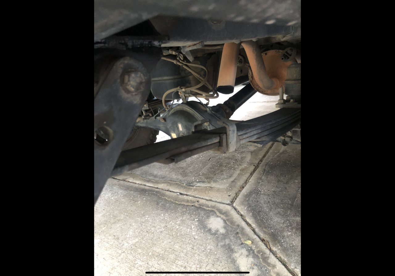

    I guess I would have to cut the rebound clips off?

    If they wrap around the top of the pack, I think you'll probably at least need to bend or cut the tabs off. Havent done mine yet, so I'd defer to someone who has pulled theres apart for confirmation.

    Do you think any damage would be done by not having the clips? I plan to put a limiter strap on it so it shouldnt overextend

    I would think theres and increased risk of leaf springs fanning out and hitting something you dont want, like the gas tank and carving that up. I think they are fairly easy to replace that though.

    None. I cut the top of the retainers/clips years ago and haven’t had any issue. They won’t spread out. U bolts keep them from twisting.
    no retainer may allow a little more axle wrap but I get very little as it is.

    I just bent my clips open a little with no problems and still offers all the droop. Ive seen some aftermarket spring packs that have the leaf clips clamped around pretty tightly. The only problem i have is my overload spring tends to twist out of line after wheeling, it only goes so far because the u-bolt stops it. Ive tried to wedge a plate in there and bent it around the u bolts to stop it, it only marginally helped. Every once and a while i put it on the lift and hammer them back in line.
