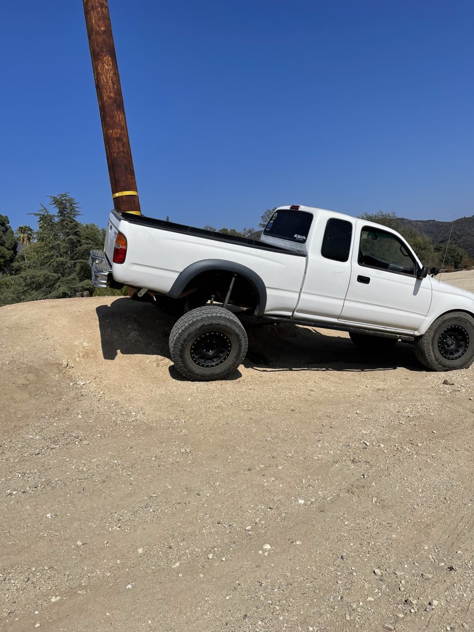

    Picture of my rig LOADED down with an irresponsible amount of weight for not having an add a leaf

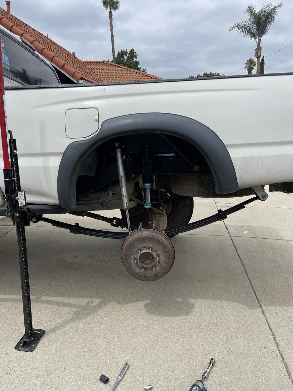

    Chevy 63s how she look :D

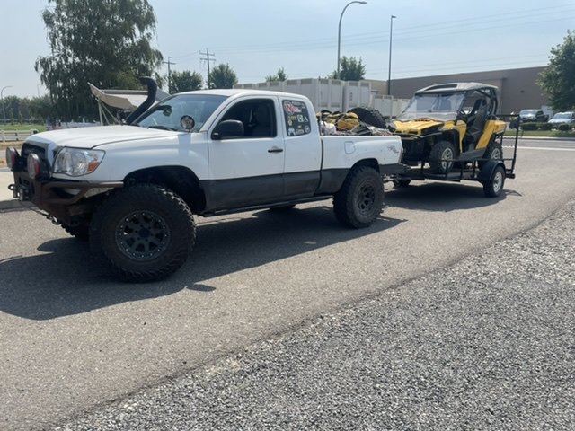

    So yea I pulled this the other day… my buddy’s raptor on 37 destroyed his steering rack at an off road park and no one would come get it for 3 days…. Taco to the rescue. Did great got 10mpg haha, I am on 35s and 5.29 gears for reference……… yes people I know this was a bad idea, no I don’t do this a lot and I do have a BBK and trailer brakes.

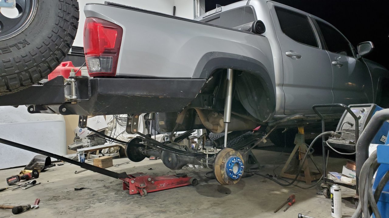

  12. Sep 29, 2021 at 5:03 PM
    #892
    Buttskevin21
    Buttskevin21 Well-Known Member
    Dec 14, 2020
    #349654
    2,490
    Kevin
    Washington
    2019 Brocoma, 37s, Lt, Dual Tcases, blah blah blah https://www.instagram.com/kevinjbutts/
    Stock-ish

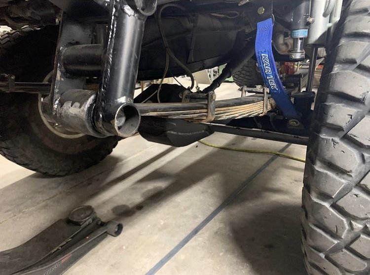

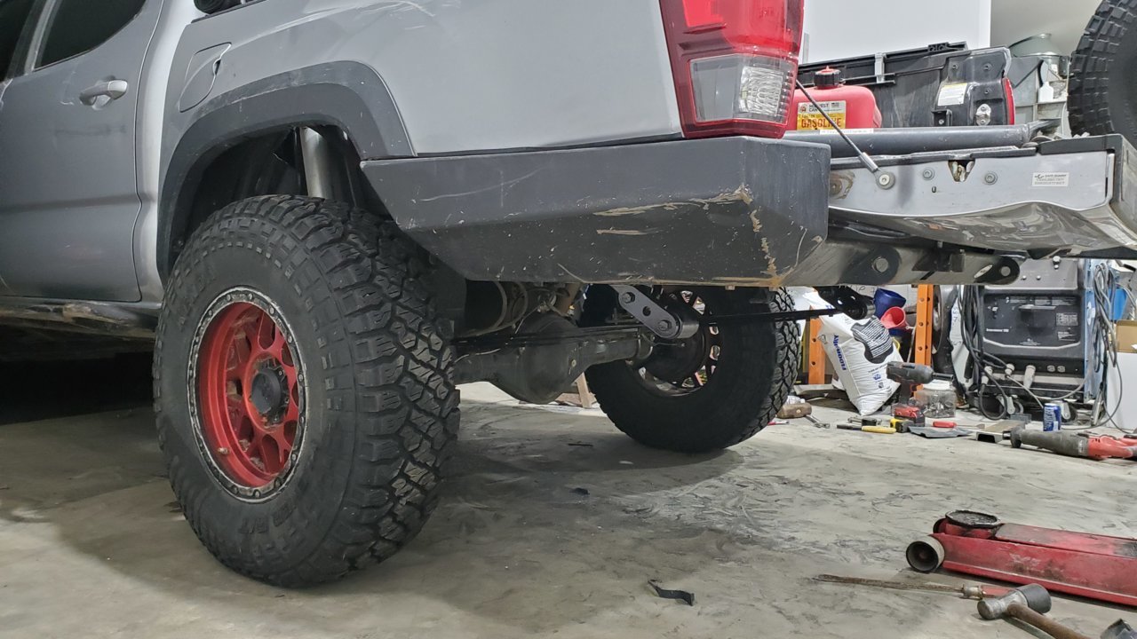

    Did 63s last night. Took about 5 hours to do. Running the usual 3 leafs, Ruffstuff universal hangers, and 4" shackles. Sits nice and low.
    Haven't flexed it out yet, but under full droop on jackstands its maxing out my 14s. Should be able to bottom out the shocks aswell, depends on how much I want to negative arch the leafs. For shocks I'm running 14" 2.5s with Ruffstuff towers poking through the bed. Plan to add a crossmember to the towers and going to plate the rear frame in.

    A little something different. Been running 63s for about 5 years now with no complaints. Picked up a deaver 62 pack with a broken main for super cheap and took the main pack of it minus the military wrap/main leaf and put it below my 63 main. Interested to see how it ends up working. FD7380D7-E0C3-4584-9D66-ECF6F2BA1720.jpg
