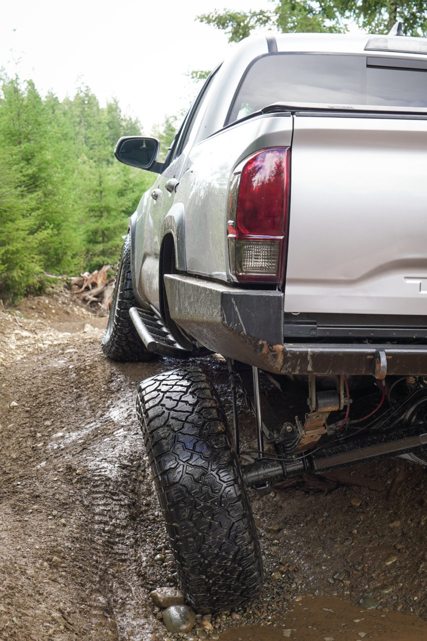

    63s still truckin! Now running 16" Carbon Shocks, using 15.5" of stroke during articulation. Vertical travel is still 13-14" depending on the day. Need to do poly bushings, and add a thin leaf or two to the pack to help against axle wrap. May also do some bigger spring perches to help with that as well.

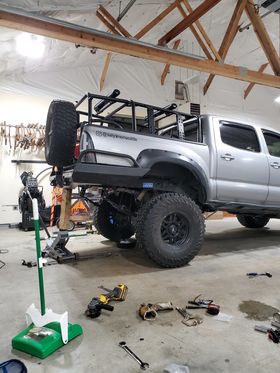

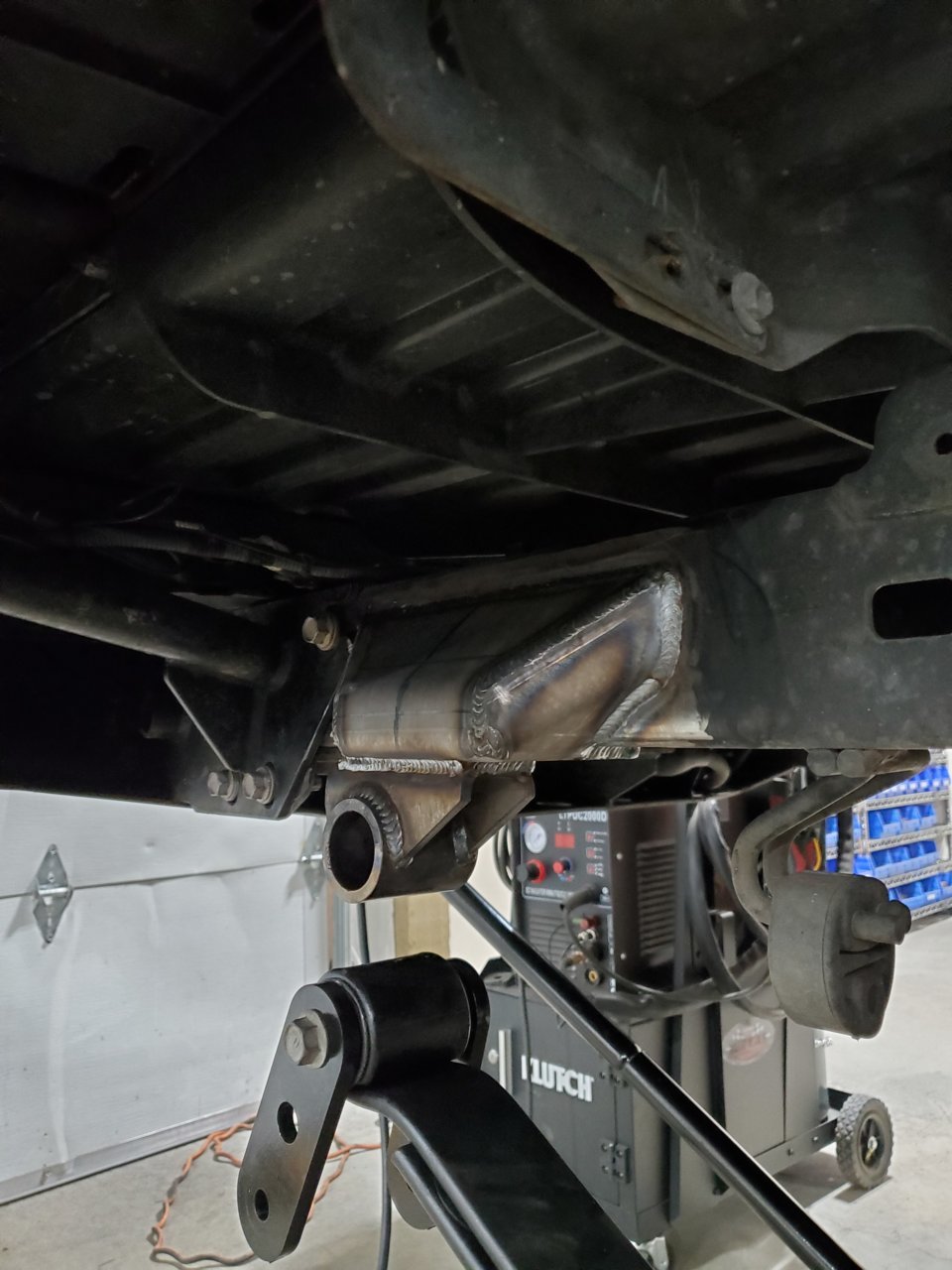

    It's less Tacoma and more mod
    I did the whole 63 thing, haven't gotten to test em flex wise besides in the garage. But on the road with the TG creeper shackle mounts (same idea as orbits), the ride is unique and excellent. I really like how it leans and plants in a corner now too, wasn't expecting that behavior but it's very stable.
    Mockup:
    Frenching:
    How it sits right now:

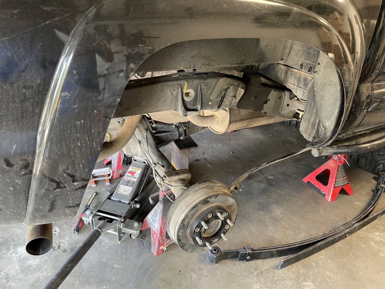

    Day 1 of the swap in the bag. Holy sh$t getting the front hangers off suck. Took me forever to get the first. Then the rear took about 15 minutes. PS is clean and ready for leaves. DS still has the hangers but the most of the rivets heads are off so I have a bit more grinding and sanding. Felt good once I got past the point of no return, but still nervous about getting everything lined up.
    tomorrows plan. Finish DS cleanup. Tack and line everything up. Burn them in. I have the shocks and relocate but I may save that for another weekend and simply limit travel until then. I’ll see how the day goes …

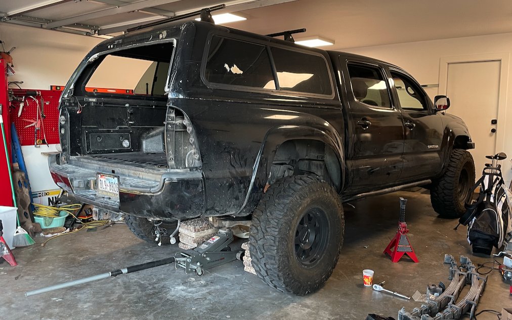

    Mine is too high right now. I need to reposition the rear. the shackles are 28* and I'm going to try to reposition the rear mounts to see if I can drop the rear 1" and hope I'm in that 20* ballpark. My fenders are cut so my measurement reference is top of axle to bottom of frame rail. Stock I hear is roughly 8.5". I'm about 12" and would like to be 10.5"-11". I did stick my spare 35 in the back of the bed which helped slightly, but it still sits higher than I want. It does ride softer which is great but I gotta get the 14" shocks in, lower the rear just a tad and fool around with the pinion angle. To make everything even more complicated, I mashed my DS on the last wheeling trip a week before this which introduced some good vibrations in the 40-50mph range. After the new leaves, that range expanded to 30-50mph. Bringing it down a tad should help and then I can fuss with the pinion angle and look into some sort of re-balance. Always something :)
    I'm pretty sure this is sitting on its own weight right before putting the 5100s back in. I'll get to the rest of the work next month when I have a free weekend.
