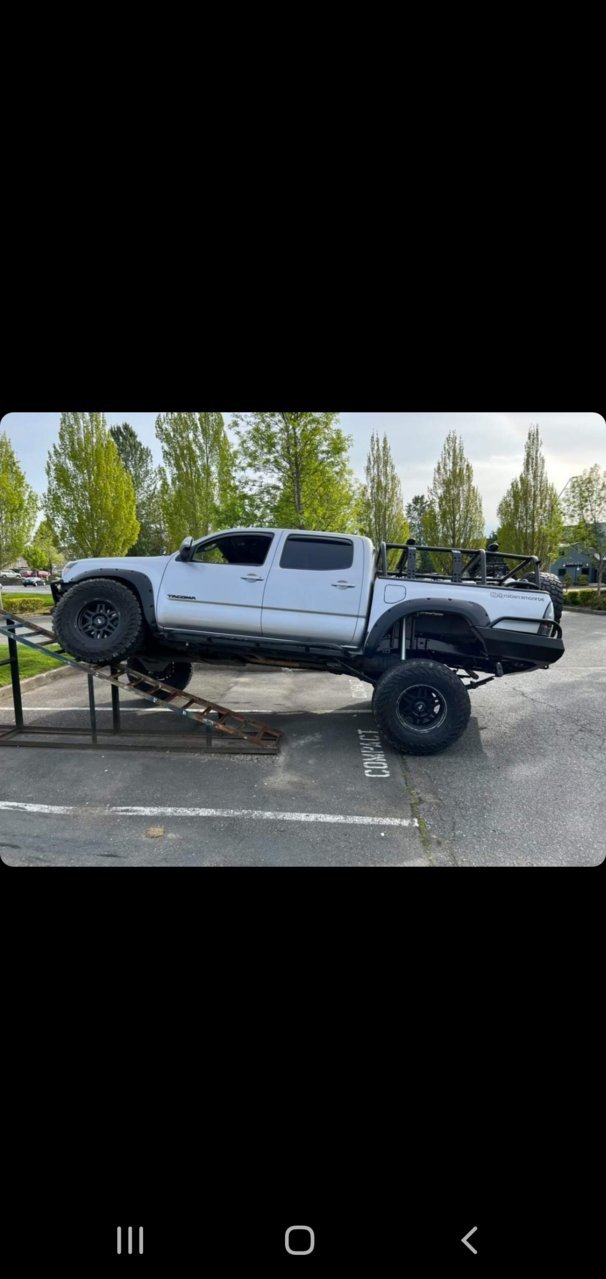

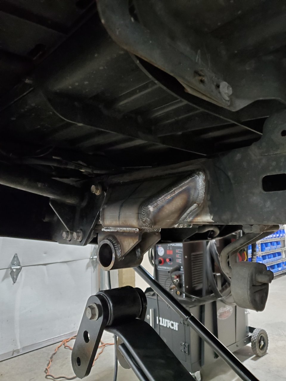

    Couple photos of the last 63 swap I did.
    20220507_191920.jpg 20220508_153949.jpg Screenshot_20220603-075515_Instagram.jpg

    I need a lot more practice before my welds resemble those … I have a hard time with that curve from the shackle to the frame outrigger part

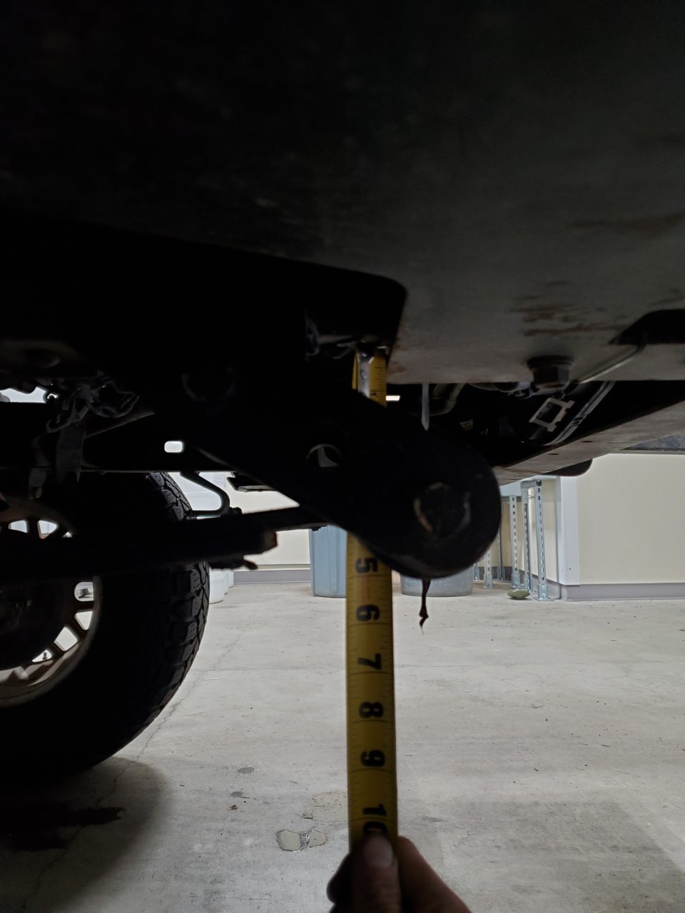

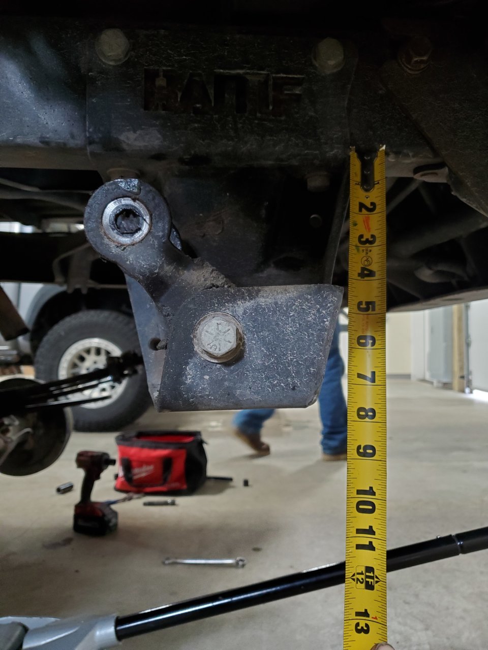

    Clearence gain between Bamf hangers, and a shackle flip with a flatter shackle angle. Basically a 3" gain, with no hard hit when you do hit them.
    Another 63 swap done

    What’s the resting angle on shackles?

    On mine they sit at 63° at ride height, leaf pack is almost flat at ride height so they kick back to about 70° before the leaf is inverted.

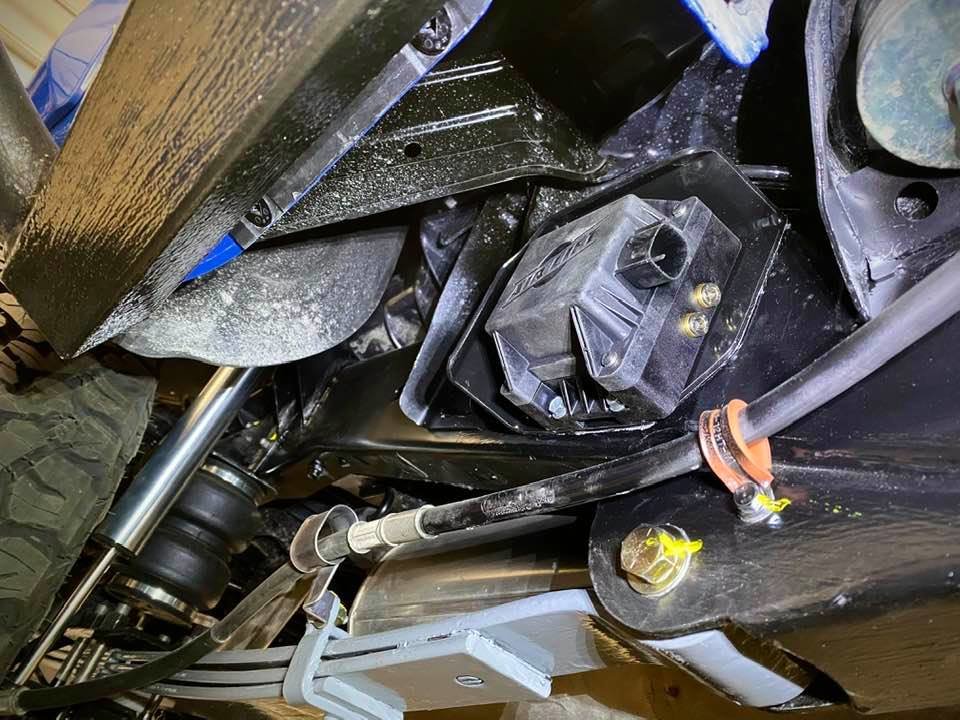

    Ryo
    Fulltime Overlanding
    Long travel house on 35s with a custom aluminum utility bed and FWC
    some welding required
    as long as the cable passes next to the front eye bolt it shouldn't cause any issues with length. more droop just means more bend which shouldnt be an issue for a while.
    i added some holders to keep it tidy on mine

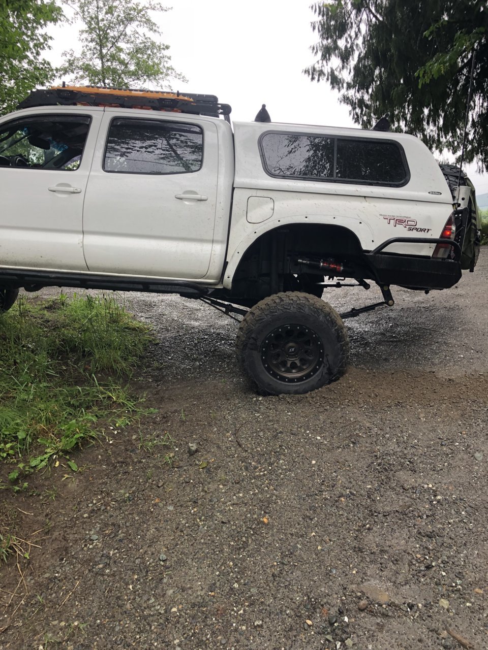

    Axle wrap update:
    Running 5 leafs
    On the street/gravel/snow/sand, axle wrap is minimal.
    Under big load ups/bind ups, the pinion points to the sky. Main leafs are now slightly bent so I will be making a trac bar.

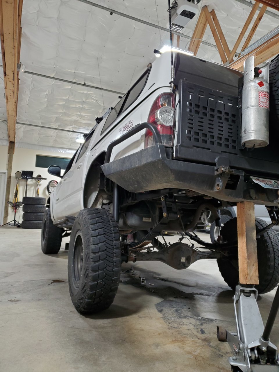

    To experienced chevy 63 swap owners/installers: What are your thoughts on keeping the overload spring on and having no bump stops?
    As you can see, it definitely has a rake. It has new bushings. I currently have a decked system full of not so heavy gear. Wondering if it will level out when I put my tire carrier (swingout) with full size spare.
