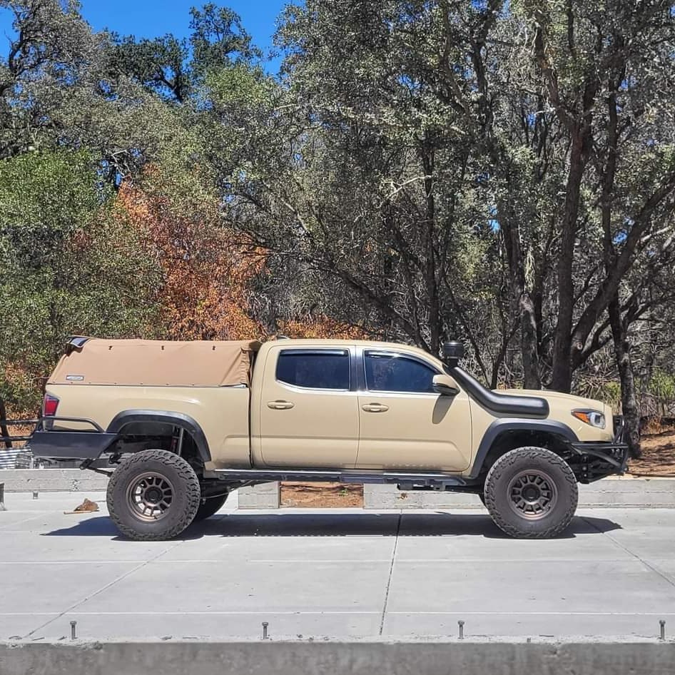

    Long travel house on 35s with a custom aluminum utility bed and FWC
    some welding required
    why not add a bumpstop? an overload may help with adding force before bottoming (and bending) your shocks but doesn't take the place of a bumpstop. just add one!
    I'm carrying a whole lot more weight over the rear than most on here, I'm running 3 leafs with no overload and patiently waiting for the leafs to break in.
    these are brand new springs, but definitely taking longer than I had expected.
    I do have air springs but basically just use it to keep the ride height the same with and without the camper (and use their internal bump stops)
    ride height before the camper
    187498896_10101615431743697_801428101858_7f9232bb1abd4a034ea15c80396786d5addf7278.jpg
    and with camper
    285060025_10101790361338387_865551111992_01ecf87be64069984094c15f8a207e84bc492114.jpg

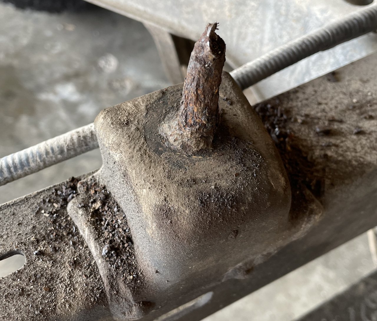

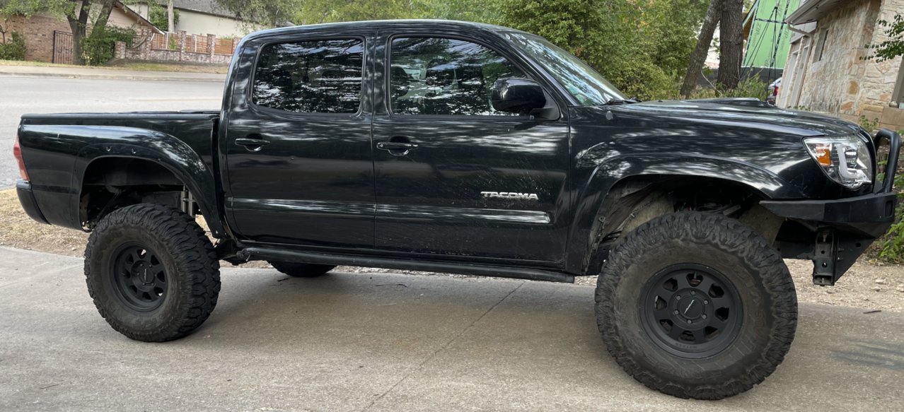

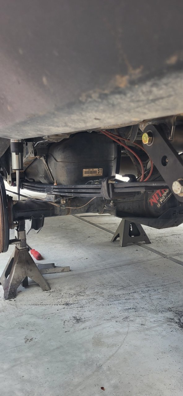

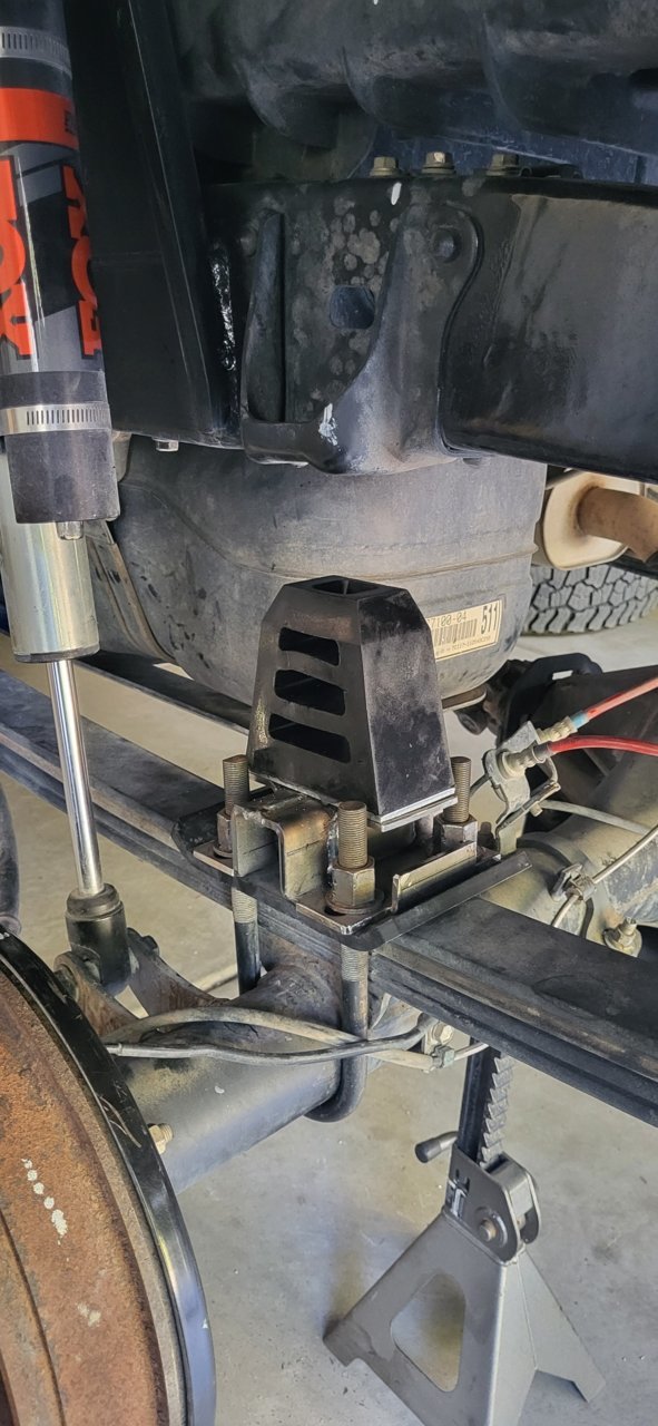

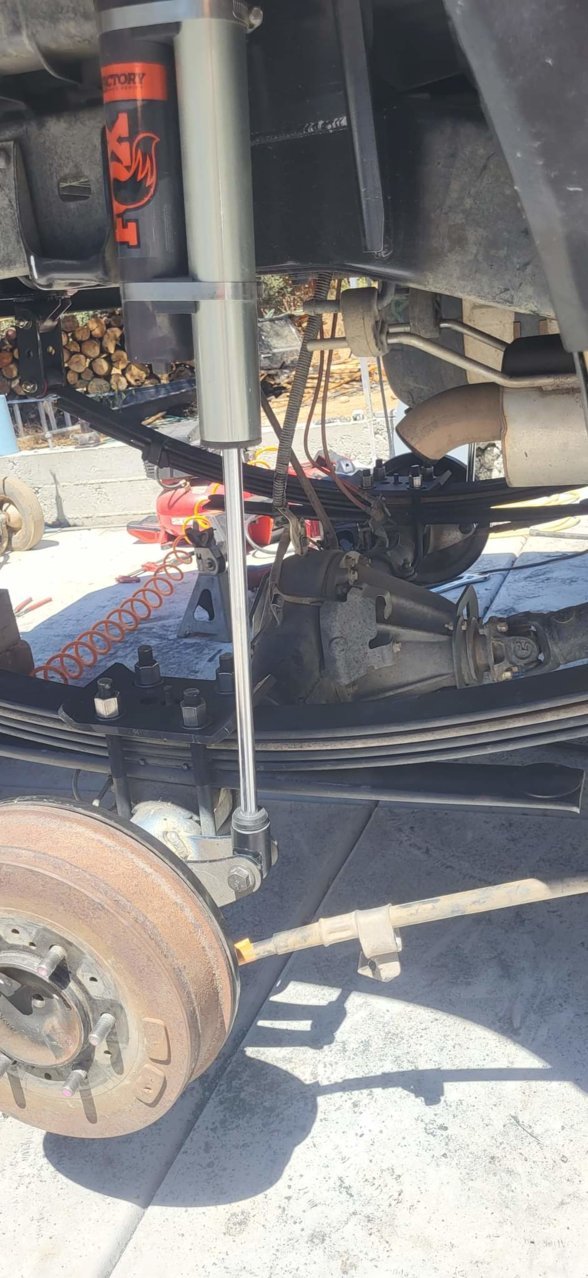

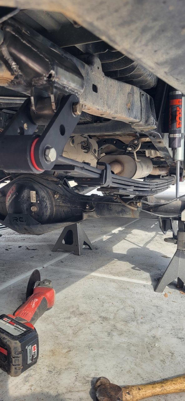

    FINALLY completed the swap. I had put the 63s on and ran out of time for the shock relocation. I was able to knock that out over the weekend. Bilstein 14" 7100 Short bodies - with the 63s it looks like I can take advantage of the full length of the shock. I had 2 bed bolts that looked like the bottom pic so hopefully a few better pics once I get those tapped, a few new bed bolts and properly set the bumps. I had asked a few posts up about the measurement - ride height for me is just ~11.75 top of axle to bottom frame - no overload.

    That’s the shit nightmares are made of. I put a 3” body lift on my old 73’ blazer and every bolt was like that. It was a wheeler so we ended up torching most of them out and using massive washers.

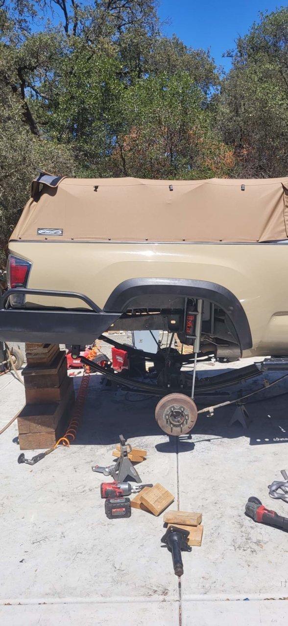

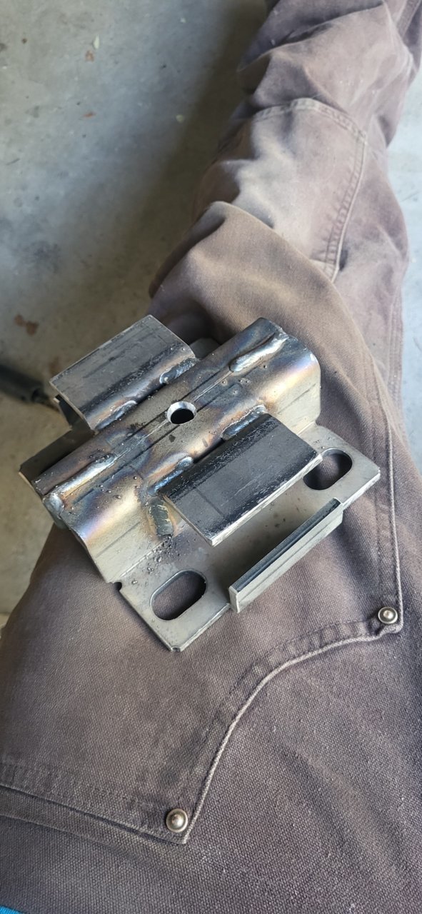

    Ruff stuff bump stops finally on...thanks to my buddy Brian for the custom work

    I did a double take on that, it looked like unistrut at first glance haha

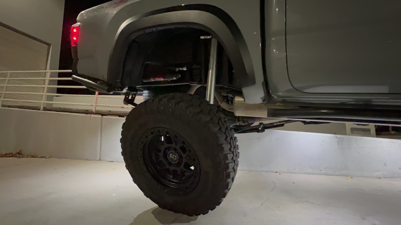

    14” 2.5 Fox DSC shocks with a Chevy 63” 3 leaf pack, ruffstuff swap kit with archive garage shock relocation kit, still haven’t installed limit straps or bumps stops so it’s not at full droop. At ride height I have 7” of up travel and 7” of droop.
