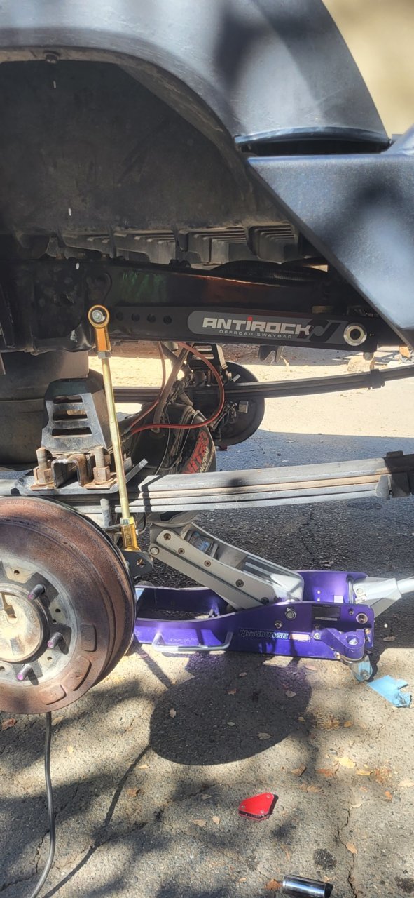

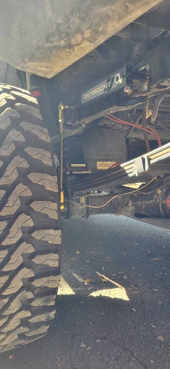

    72
    Elk Grove
    Antirock installed

    I'm not too familiar with these although i hear about them a lot.
    how does this function as either a track bar or a limiter?
    I always assumed they were just sway bars?
  8. Oct 19, 2022 at 12:30 PM
    #1048
    a2lowvw
    a2lowvw Well-Known Member
    Jan 12, 2021
    #352533
    1,964
    Justin
    Bothell, Wa
    2019 DCSB Limited
    Stuff and things
    I don’t see how a sway bar can act like a limiting strap unless you droop out enough that the links and arms end up in a straight line which is a recipe for disaster.

    not sure im following at all, sorry!
    my definition of a trac bar would be a panhard/watts/etc which stabilize the lateral freedom of the axle, which your endlinks can't control.
    and then unless you are having the arms hit something before full travel, how does it limit shock travel?

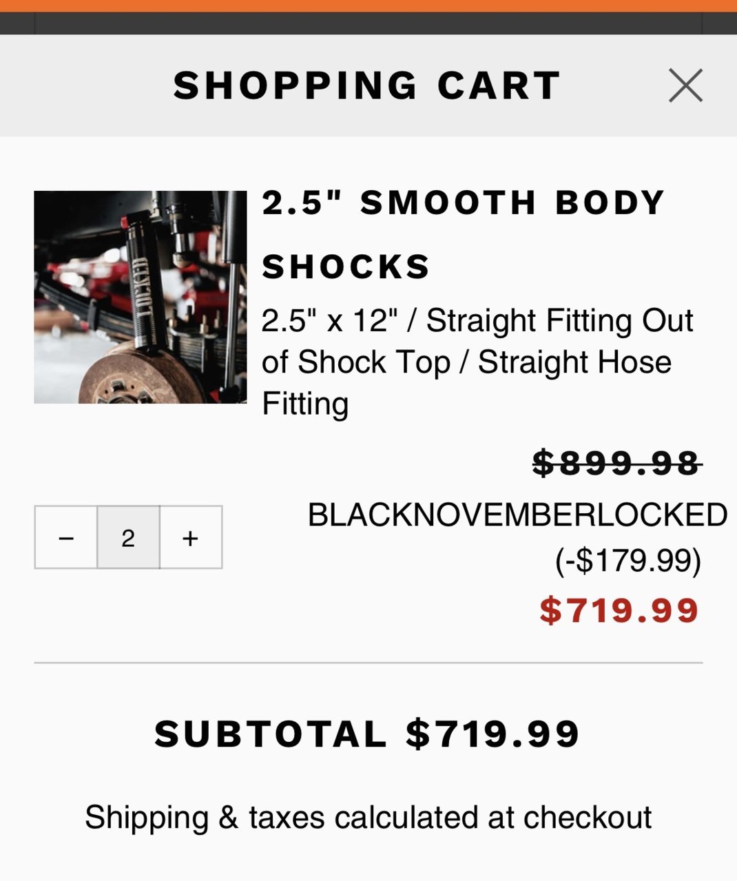

    Anyone have any experience with Locked Shocks? They look like they are competing with the big names but aren’t as widely known yet so their prices are still really low. I might pull the trigger on their 12” travel smooth bodies that all come with compression adjusters

    They work just fine. I'd atleast do 14s if you're doing 63s, no point for 12s as thats what stock packs can do.
    I run Carbon Shocks in the rear, they have been working awesome the last year and are tuned pretty well. $530 each right now with dual speed adjusters.
