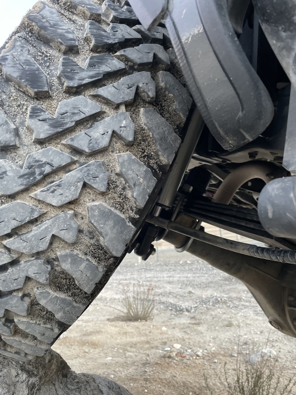

    Ended up putting in a fourth leaf from a stock tacoma pack. I should have ran four leafs to begin with. A lot less body roll on the road and less sketchy when negative arching the pack. Finally ready to relocate the shock.

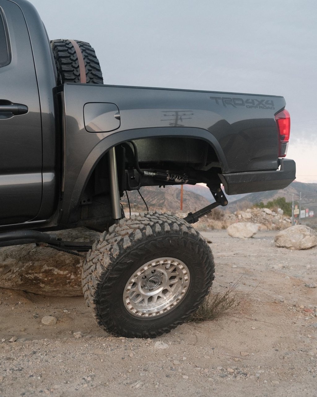

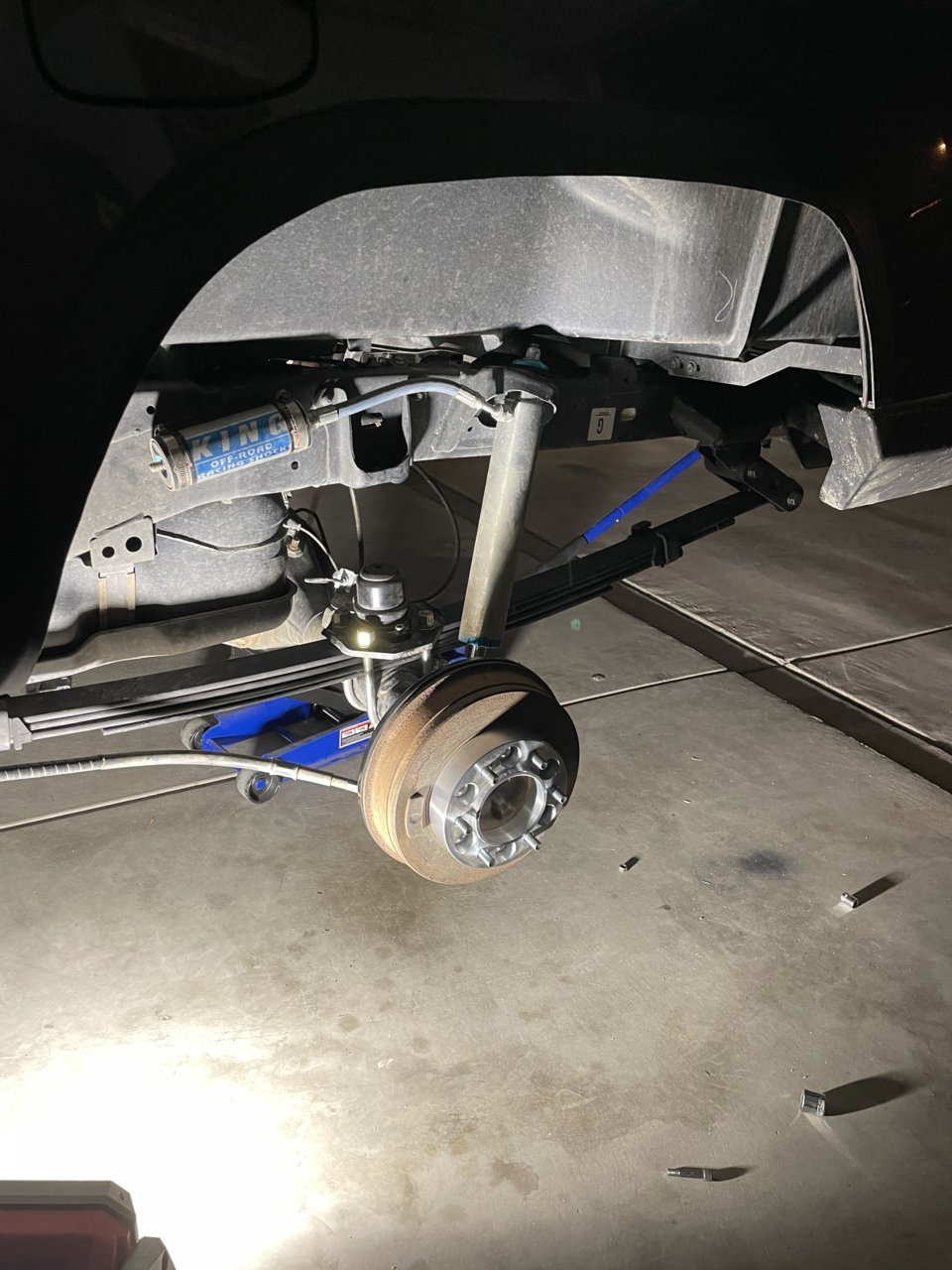

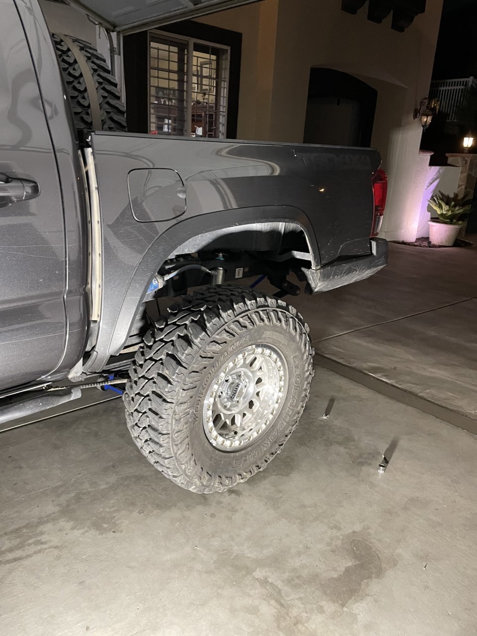

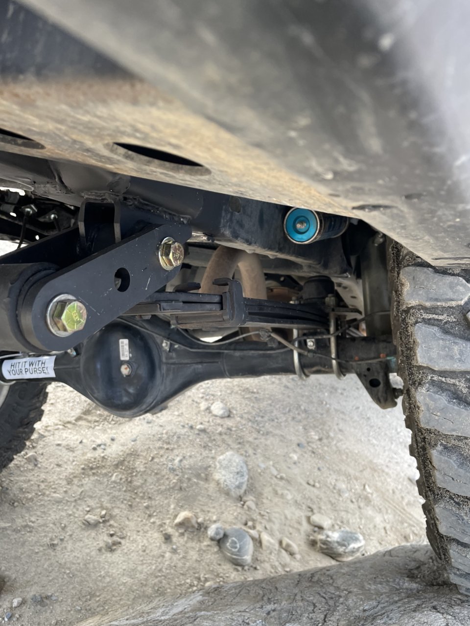

    Finally got around to doing the shock relocation. Super happy with this setup. Still have some uptravel to go too.

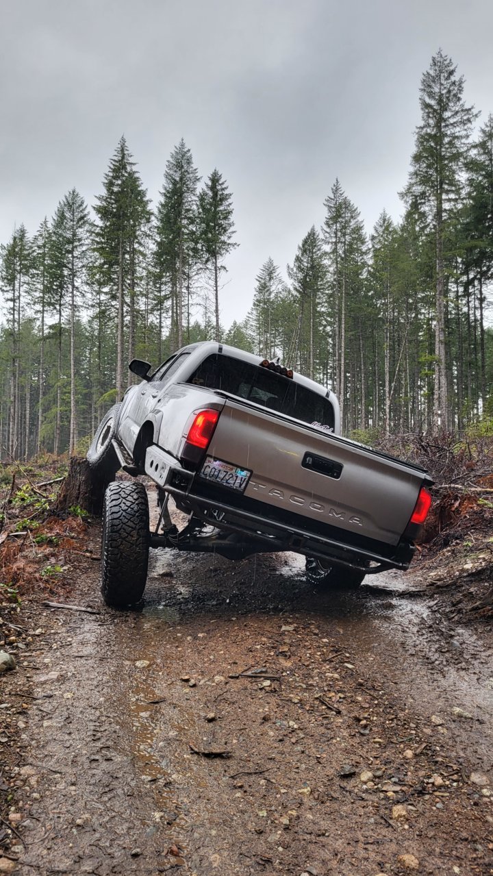

    I usually bump these setups around an inch or a little more down from here, negative arch isnt the best for the 63s but yet again they are $60 a pair, so just depends on how much you care/bring a spare main leaf if you are negative arching them that much.

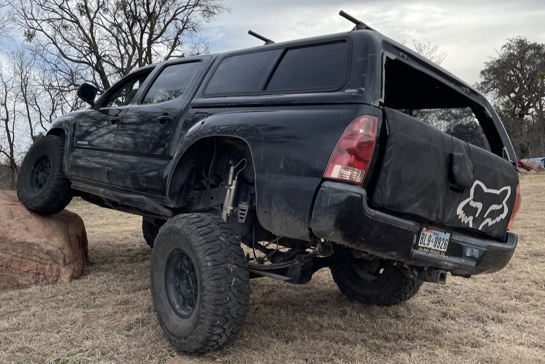

    I had a great time yesterday. the 63s and 7100s helped me climb a few spots I struggled with beforehand. I actually never got the rear off the ground.
    This was more of a shakedown run for the 40 to see what works / what doesn't and more simply - to see if I could drive this to/on/from the trail. Success.

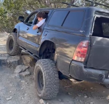

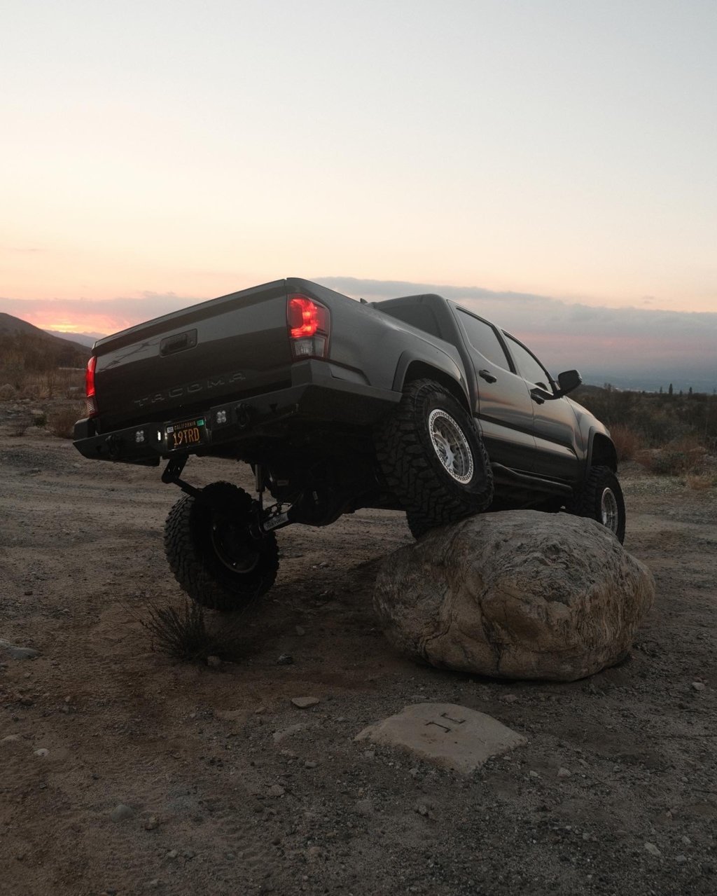

    Found a rock to flex the rear yesterday and tested clearance in the front. There was a stock tacoma with us but it couldn't get on the rock without scratching up the bumper so we didn't get a comparison.
