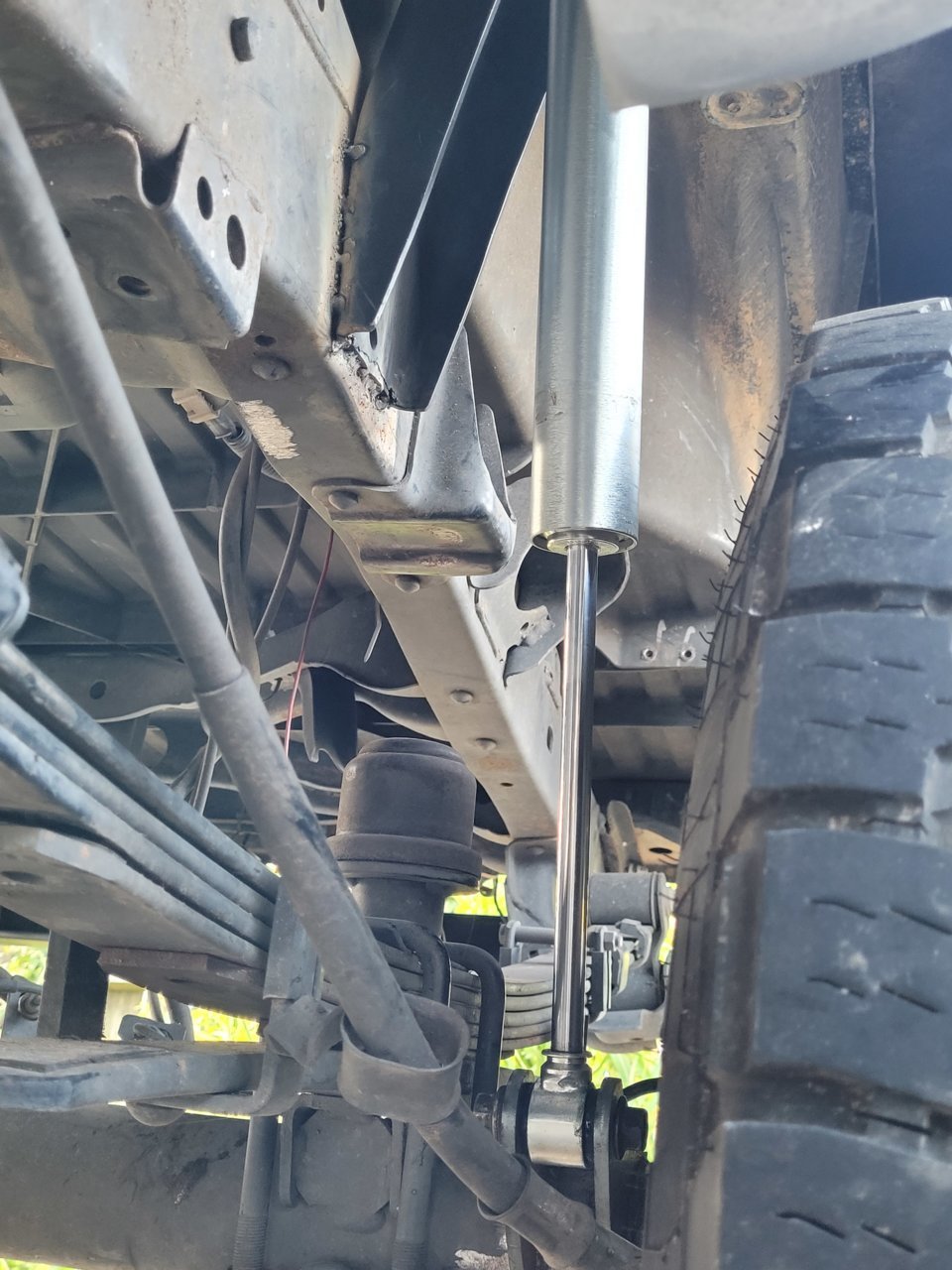

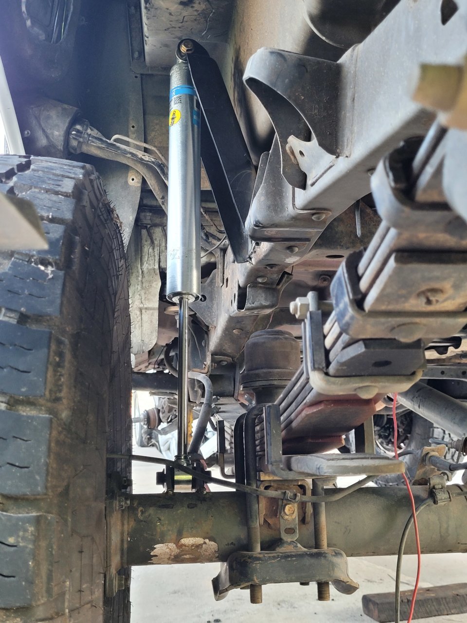

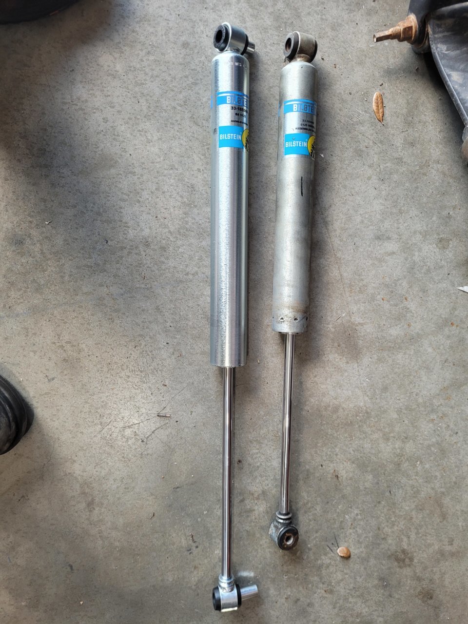

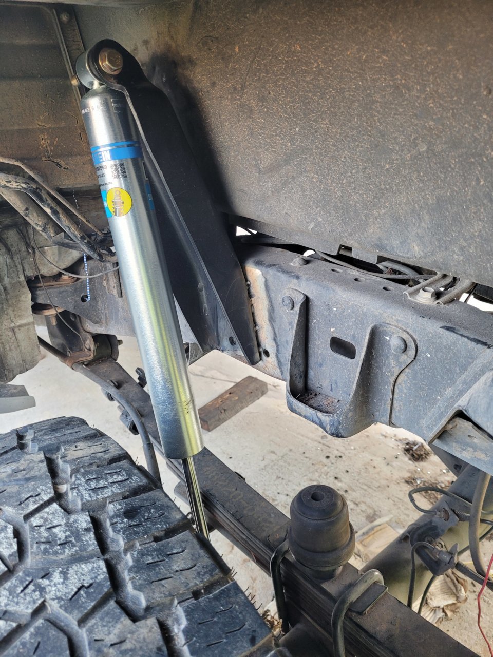

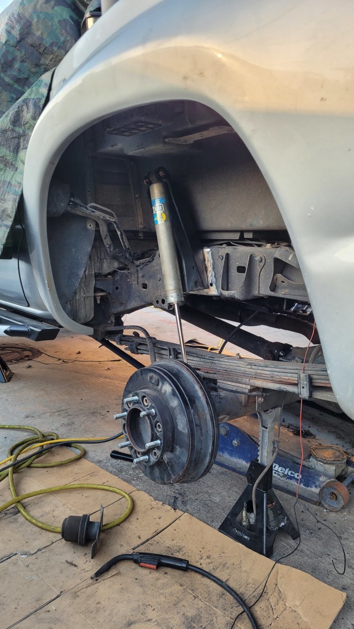

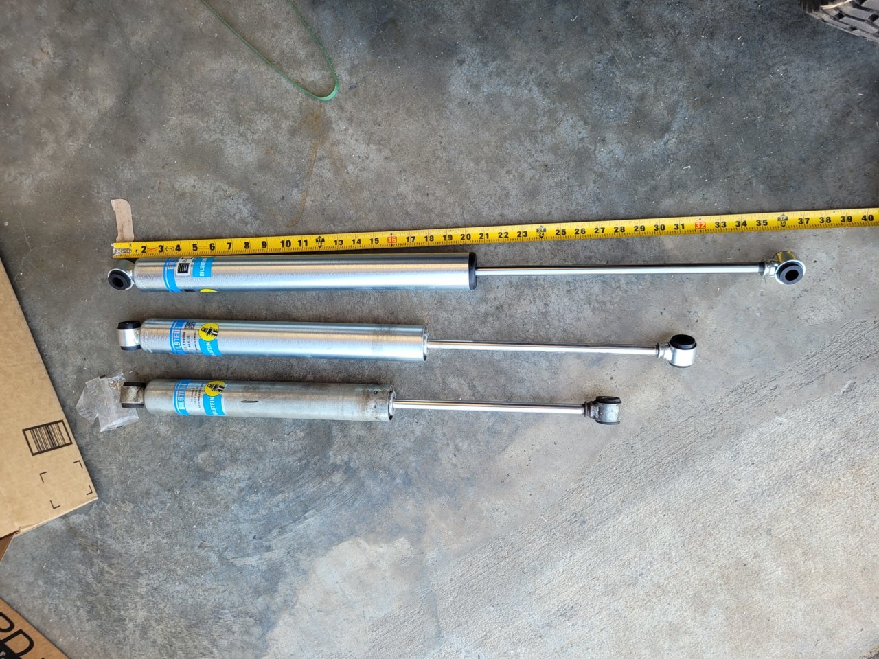

    Some shock relocation progress. Got some 12" billys to replace the older 10" set.
    Axle tab is set pretty high for the relocation. Set the shock angle at 17*.
    Also got a good low mileage set of chevys in. Just waiting on the ruff stuff kit.
    Heres some updated pics of the 12" shocks installed. May need to move the relocation up and run 14" instead..

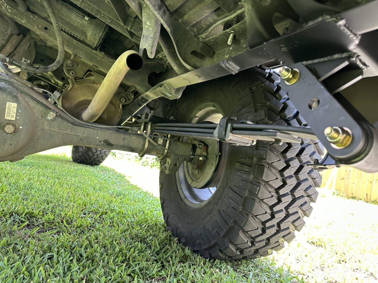

    1997 t4r has super duty axles, 5.13s locked front and rear. 3 link front with 14" kings. Rear 63s.
    Need to get some weight out back as it’s sitting ass high.
    Welded a tab on the bottom of the frame to hold the e brake cable not pictured. Sitting next to a bullet proof lift on 35s also

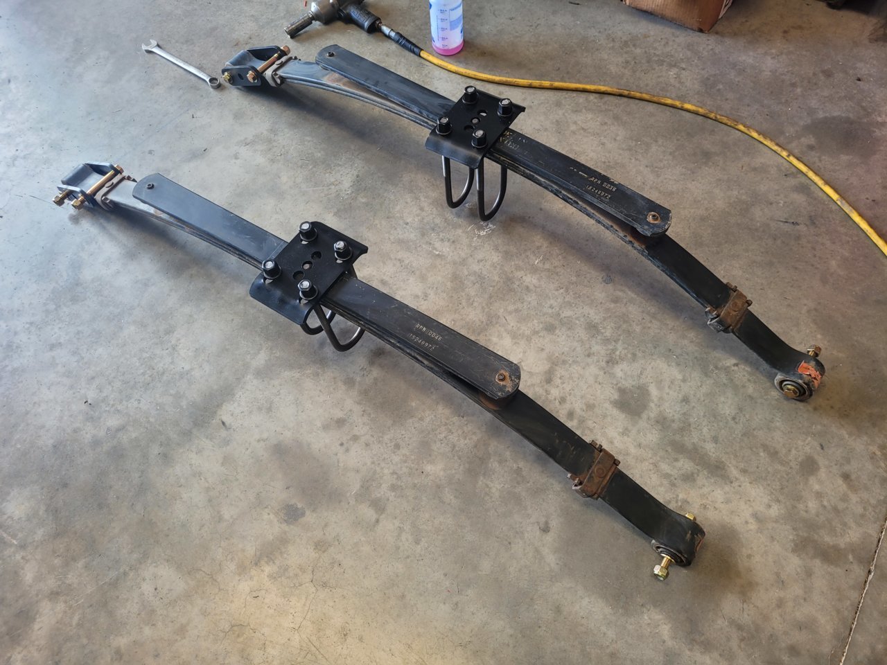

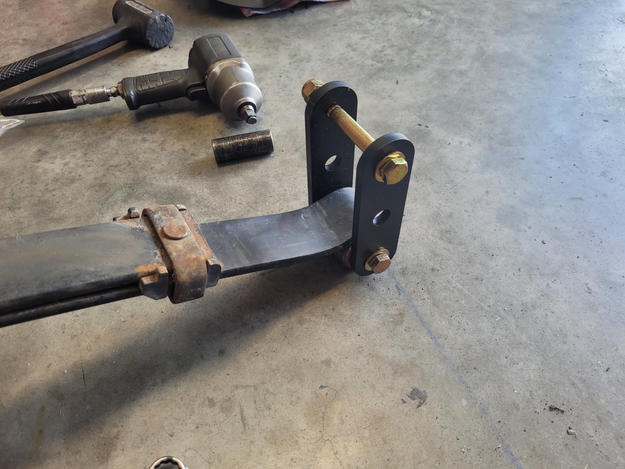

    Did some assembly. Unfortunately my front bushings are too large for the hardware provided. Can someone provide me with a part # or recommendation on where to get the bushing?

    The newer years have wider leafs. Also no real reason to cut into the bed with 14s, you will be way way into negative arch by the time you bottom a 14 up into the bed. Im into the bed a bit with my 16s, and negative arch the leaf probably 3"

    Yeah its 2.5" wide so i got a flip plate and u bolt flip to accomodate the larger leaf spring.
    Well currently with the 12" shocks test fitted, the shock body is just long enough to where the bumpstop will save it a bit. The 14" shock body is alot longer so ill need to put the relocation up more. Pic with 12" and ford shock towers. This is just the stock leaf pack with aal. Will have to run spacers on the bumpstops eventually with the 63's.20230808_082549.jpg 20230808_082700.jpg

    Move the axle mount like 3-4" down

    Shock body will still be too long as that pic shows 12" shock and the 14" shock body is 2.5" longer..

    You wont be getting as much uptravel as you think, since the mounts are much lower with 63s, thus putting you into negative arch way earlier than factory. I've always put a ~2" bumpstop spacer in compaired to running stock leafs or bolt in leafs. I've setup 63s probably 6-7 times with the Archive towers and 14s, and works perfect.
