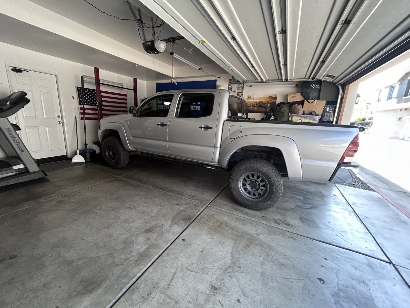

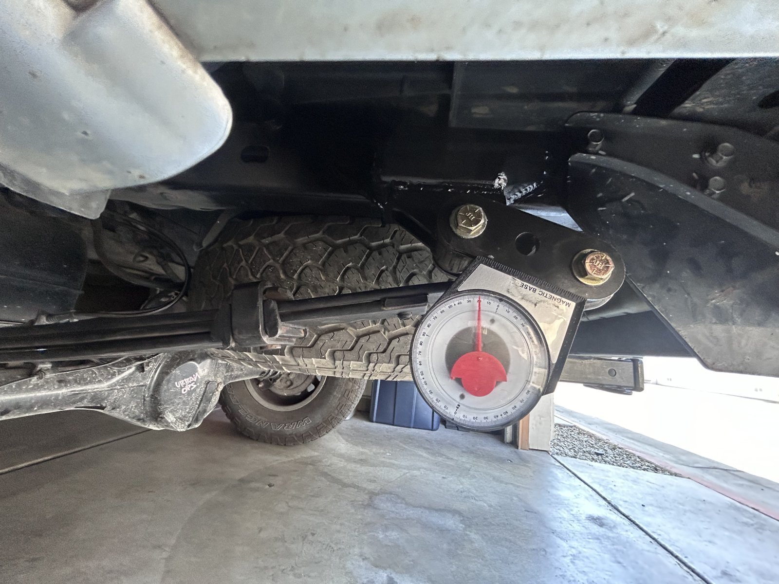

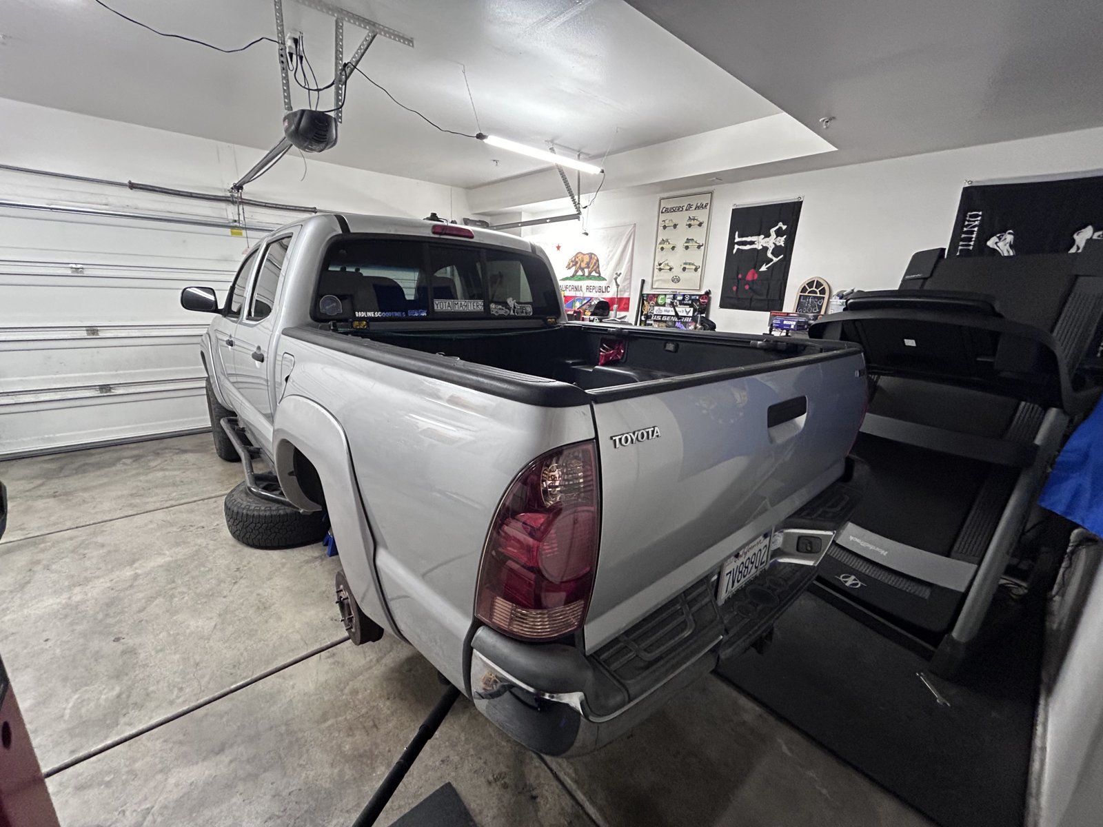

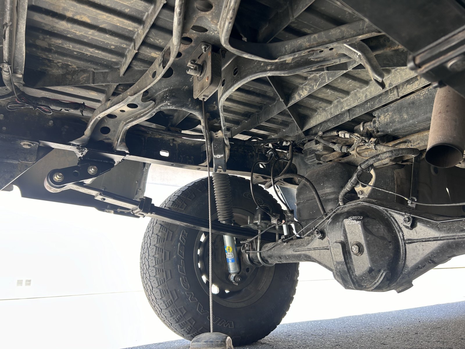

    Sitting at 24” on both sides from center of hub to OEM bottom part of fender flare. Gained about 1” from my previous height from top of tire to OEM fender flare.
    Love the ride and I got all the droop. I might order 5”/6” shackles for when I do the BAMF towers and the 14” 7100’s
    0E90267D-B07E-489E-B356-73110315C50A.jpg 419C92FD-5F3B-494B-8729-2E440BF768B5.jpg IMG_3976.jpg B643DFF9-656F-45B0-9112-348028B13026.jpg IMG_3981.jpg IMG_3980.jpg IMG_3985.jpg IMG_3986.jpg IMG_3987.jpg IMG_3984.jpg IMG_3983.jpg

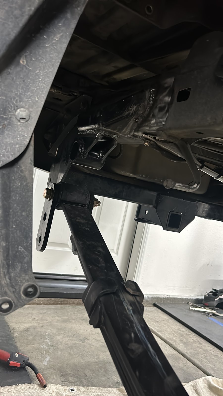

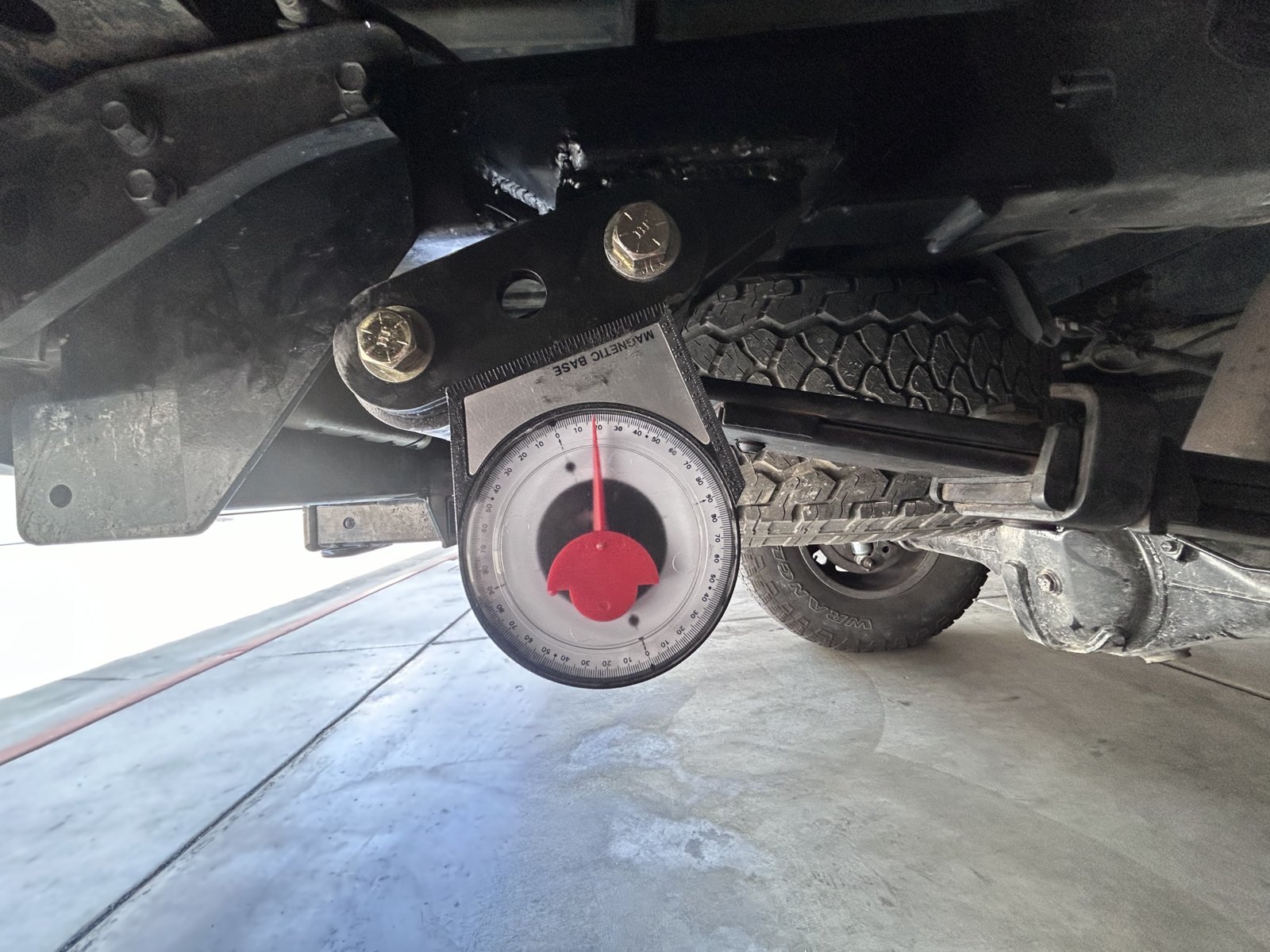

    Alrighty after setting a bunch of weight in the bed the top of the leaf is about 1/2” from the bottom of the shackle mount. And after going over some bumps the top leaf made contact with the shackle mount and pissed me off. So correct me if I’m wrong but if I order the 6” shackles (I am currently on a 4” shackle) then there will be more room between the top leaf and bottom of shackle mounts. Am I correct? Should I do 5” shackles?

    It didn’t contact when you tack welded it in and cycled the suspension with one leaf before you fully welded it? Man you gotta taste the sauce while you’re making it. It’s not completely magic.:rofl: Just busting your balls. I have a 5” on my 13’ and 96’. I would guess 6” might get you there, but I would work my way there starting with a 5”. Sounds like you want every drip of up and keeping it low as you can. You might be able to bump it early. Doesn’t sound like your shocks are sorted yet and that’s also a limitation. So quick answer yes but you might do better with 5”.

    :burp: broooo I did cycle the shit box! I was at 45• but shit settled too much with the added weight. Yeah I know the shocks are currently my limiting down travel factor and indeed waiting for them 14” shocks to again pull the pack apart, set the block, set shocks, set bump stop and set limit straps. This shit is fun brother :fistbump:

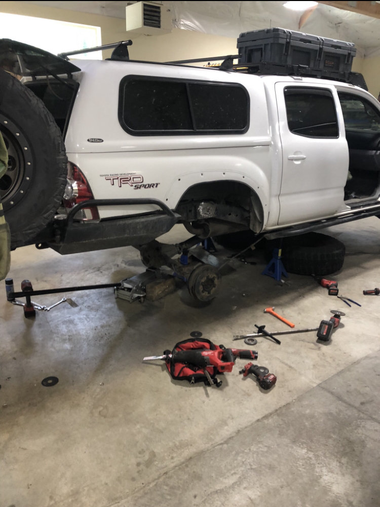

    IMG_7836.jpg Weight that was on it.IMG_7838.jpg Weight that was in it. Not sure how much extra weight you added but mine is pretty heavy.
