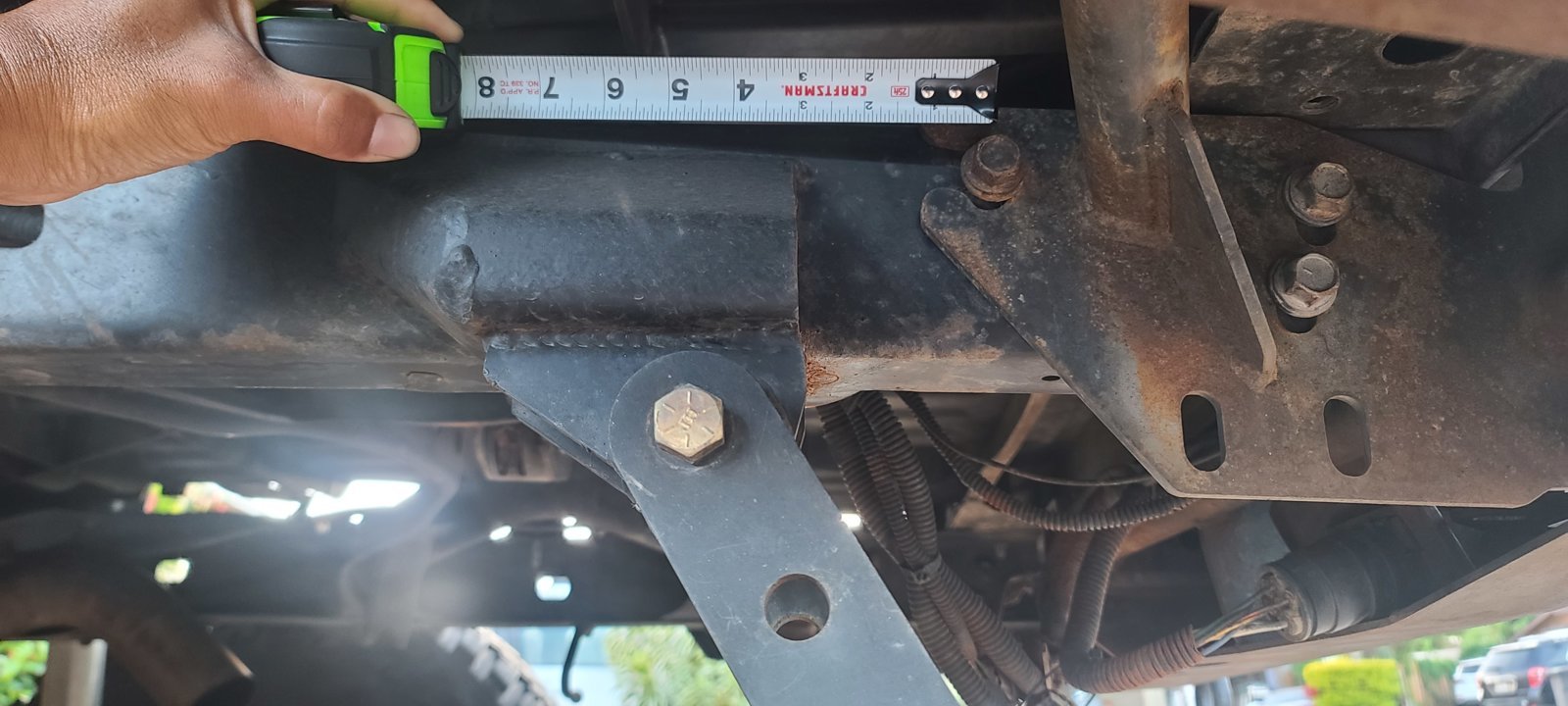

    Good reference point. I just check and I’m 5” from center of rear bolt to hanger bolt. So yeah, 5” shackles gotta make it into my truck.

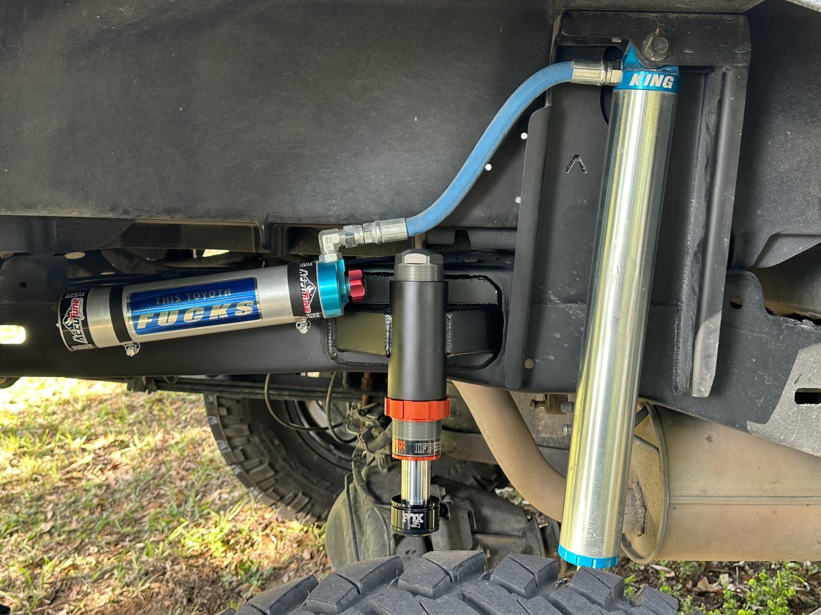

    Based on my calculations 1 3/4” should be a solid extension for bump stops(super bump by wheelers/tg) am I correct? All that will be done once I install the towers and the 14” shocks.

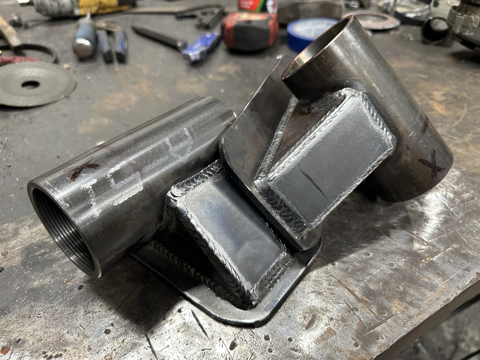

    Did you have the mount made? I’m wanting to swap over from a total chaos hydro mount to threaded bumps. Would like to stick with Fox too. I know there’s other kits out there.
    Ricardo13x likes this.
  9. Jun 5, 2024 at 11:06 AM
    #1169
    Timbo's Customs
    Timbo's Customs Well-Known Member
    Aug 8, 2013
    #110078
    7,266
    Timothy
    Lakeland FL
    2019 f250 6”lift 37s deleted 1997 T4r, tons and 4ds
    1997 t4r has super duty axles, 5.13s locked front and rear. 3 link front with 14" kings. Rear 63s.
    Took 2x3 3/16” and some 3/16 plate and made these.

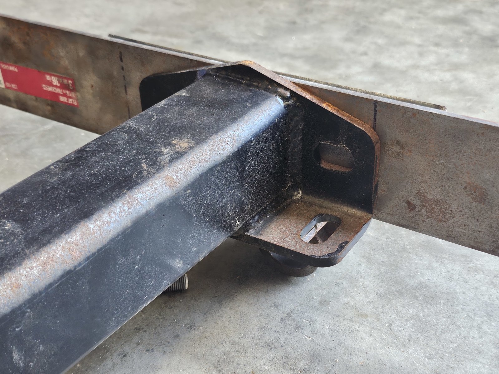

  12. Jul 20, 2024 at 2:23 AM
    #1172
    will.i.was
    will.i.was Well-Known Member
    May 6, 2018
    #252688
    1,719
    Will
    Houston, Texas
    SC 2.5
    Have an interesting idea that will probably happen soon. Really like how the archive cross tube affects the ride characteristic. Going to tie in my outrigger between the chassis with the trail gear rear tow hitch for additional rigidity. I also plan on running a crosstube between the Ford shock perches.
    Steel plate represents chassis for visual reference
    dk_crew and Ricardo13x like this.
