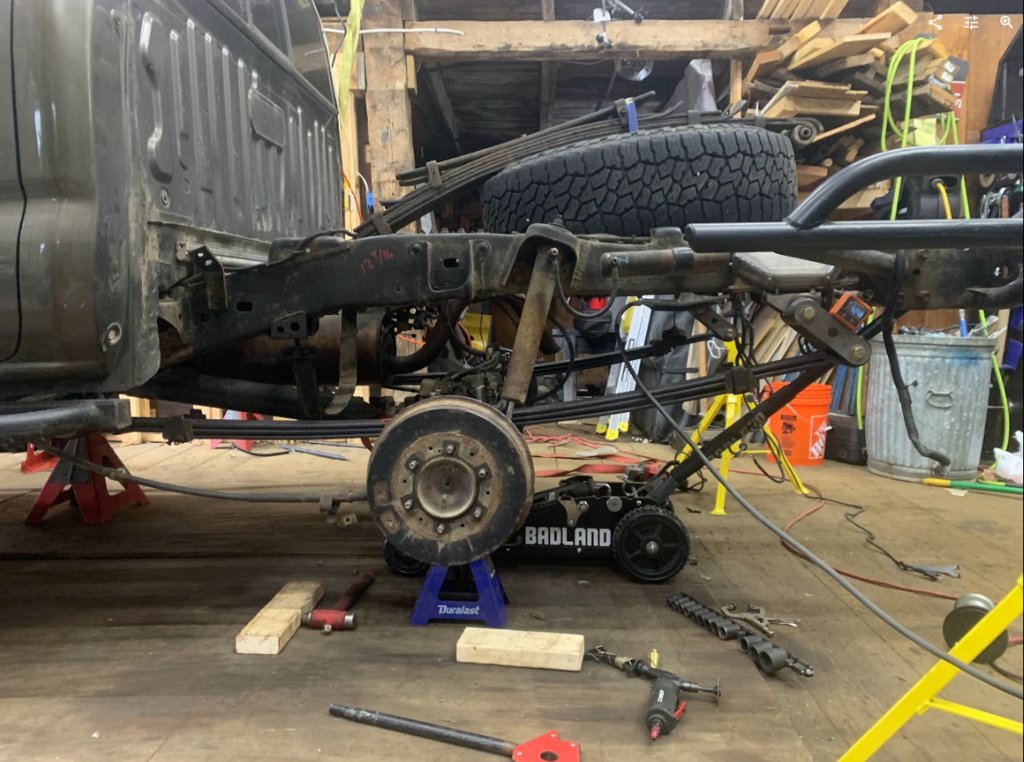

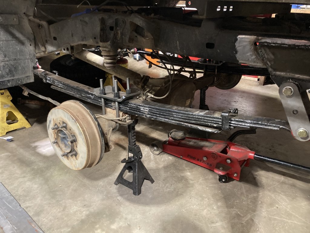

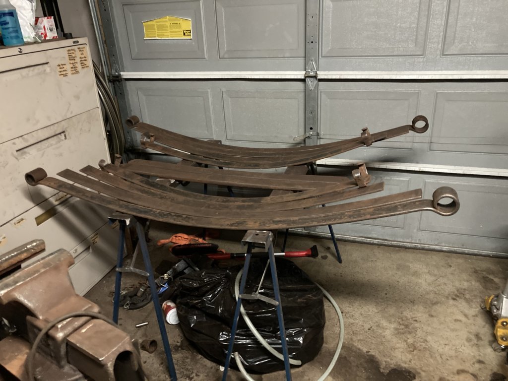

    Got the leafs cleaned up. Going with the 4+1 leafs out of a 2500hd Chevy. Removed one leaf it had in the pack. Original owner I got them from ran these on a salt truck and had a leaf added. They were rusty

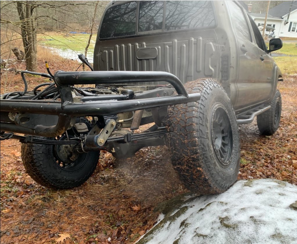

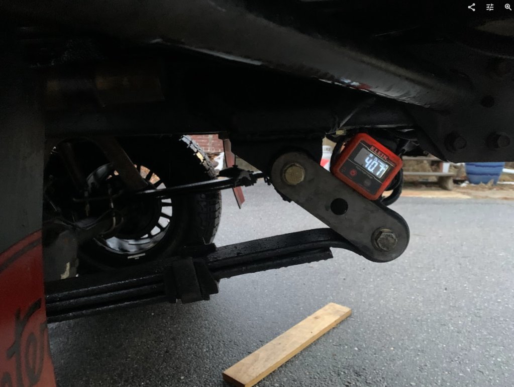

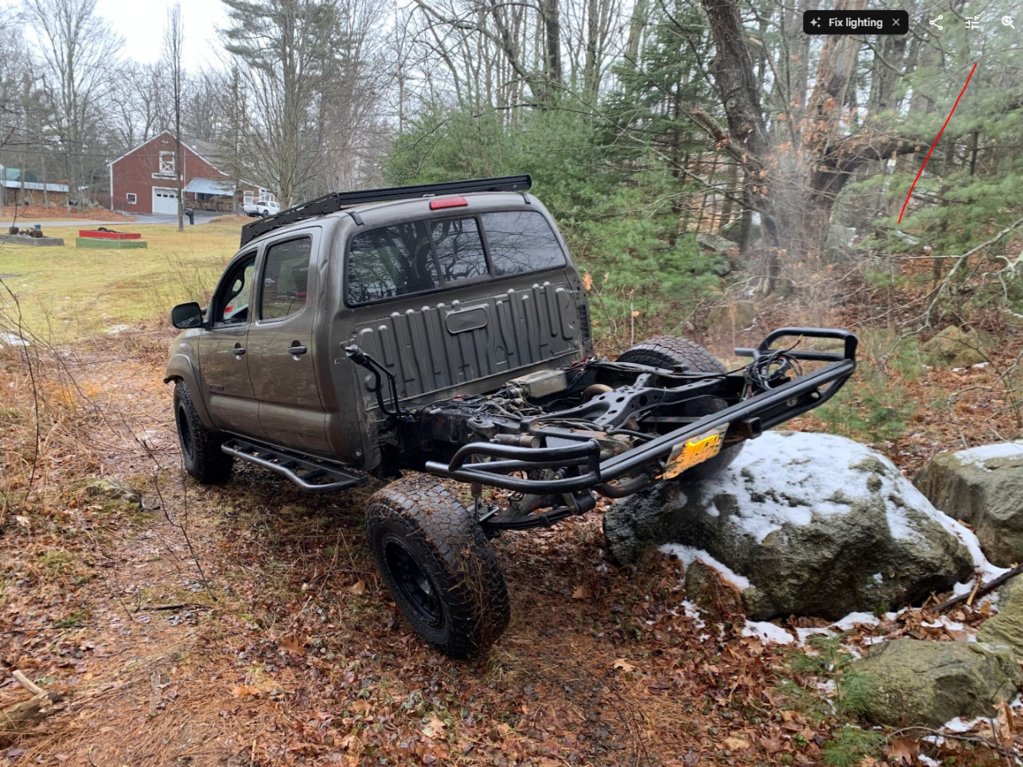

    Did my swap, came out pretty good but my final shackle angle is a little steeper than expected. I am addding more weight with a flatbed so it should come down some then.

    Looks good. Making me wonder if I do the 3 leafs or the 4. Was planning on do the overload spring too

    4+ overload would be pretty crazy. My rear bumper really doesn't add any weight over stock I think I am about 3" over stock rear height. It was right in the 25" hub to fender area.

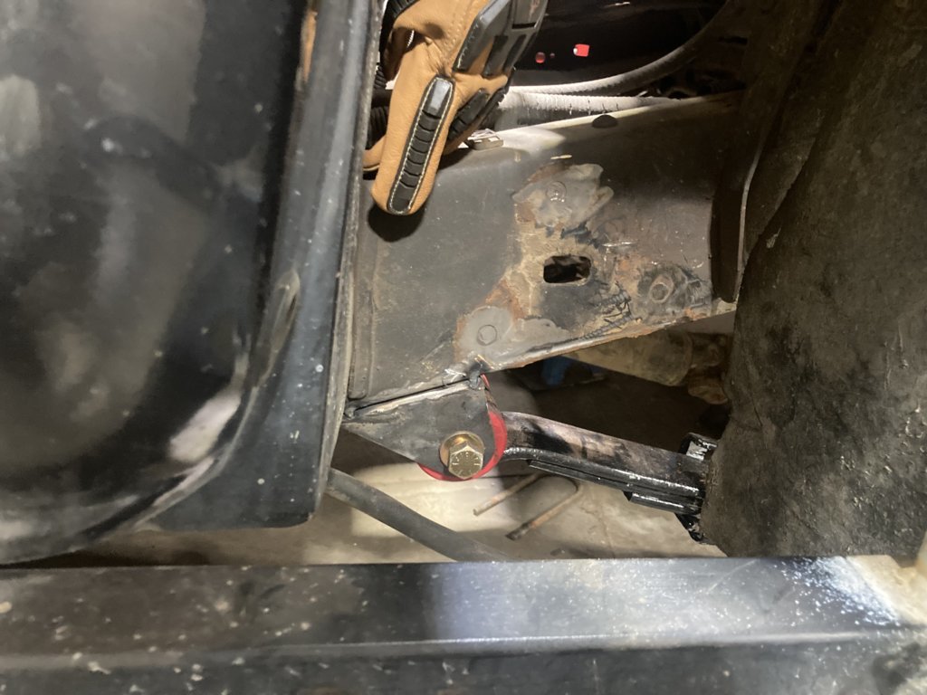

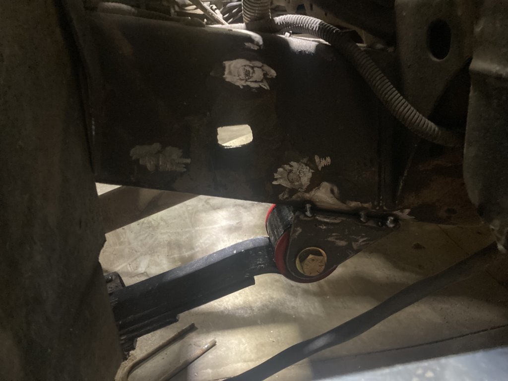

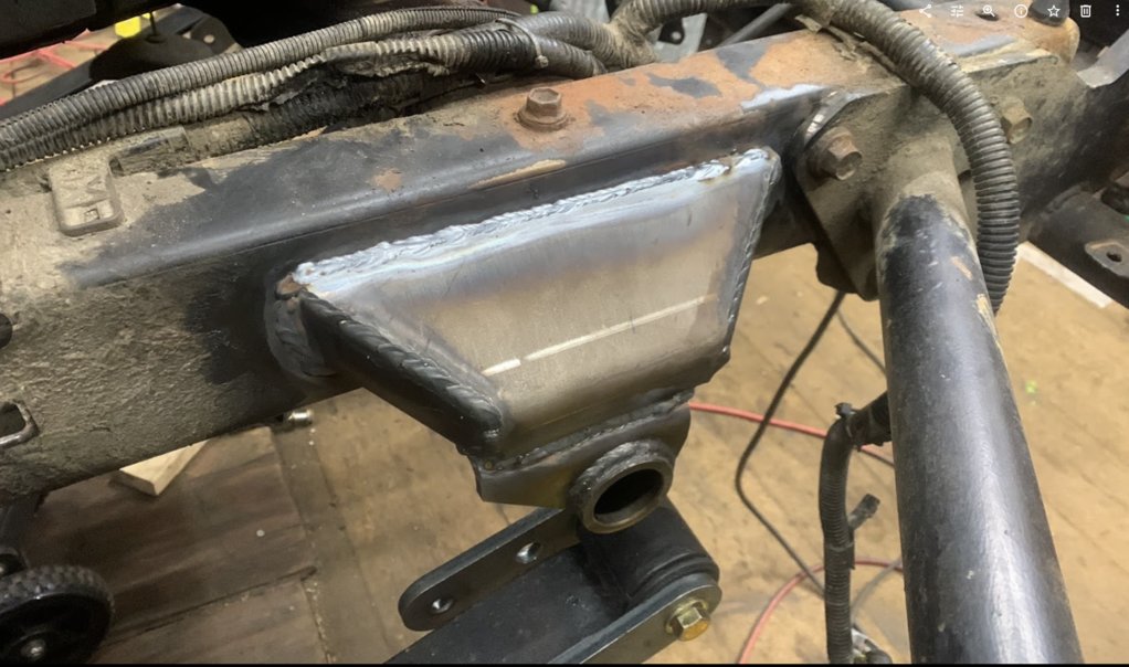

    Didnt get as far as I wanted but was able to get the front mounts tacked in for the leafs. Took a bunch of time to get the axle squared side to side and front to back while ensuring the leafs were square to that.
    Will figure out the rear mounts next week since the measurements to get the axle squared is done now.
    I am thinking of setting up the rear shackles as the truck is at full droop and then once every thing is tacked, put some weight to see what the angle of the shackle at “ride height” is. If I don’t get as much sag out of the pack I’ll pull a leaf to see if that helps and restart? Sound like the right idea?

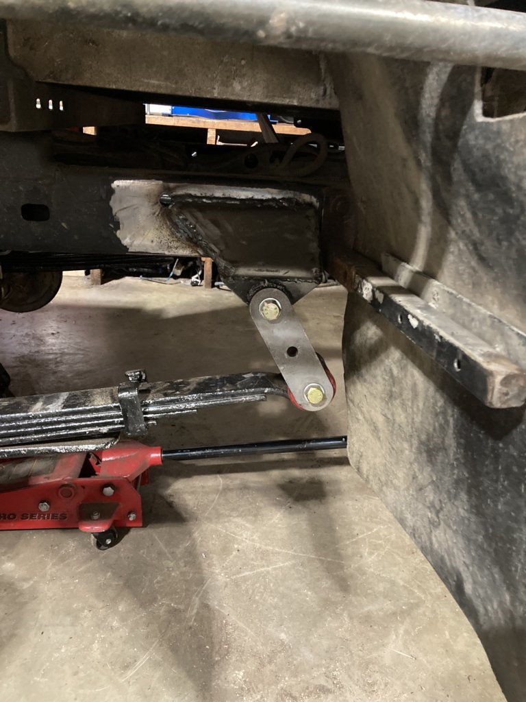

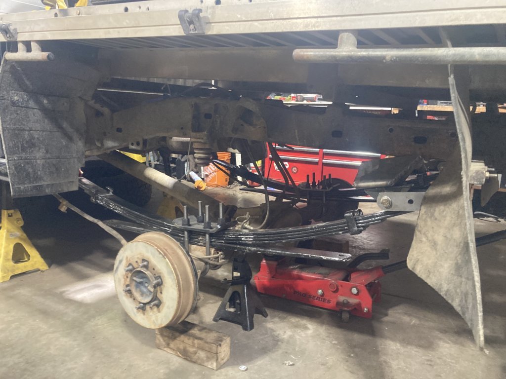

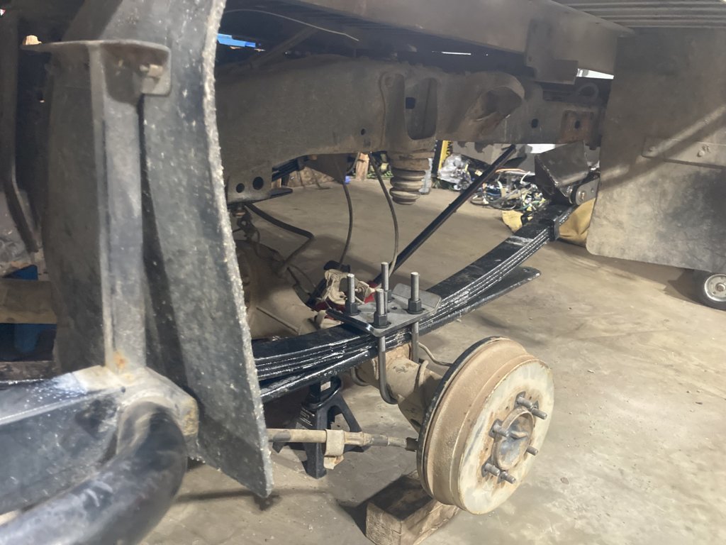

    They are in. Leaf pack sits pretty flat when trucks on its own weight. Just have some finished welding and frame boxing to do. Also figuring out what to do with the shocks next.
    these pics are fully on its own weight but they are in now.

    That looks mint. Get all that experience in so you can do my front springs. Thank you ahead of time.:)

    I’m no expert but your shackle angle looks really steep if that has the full weight on it.
    Maybe someone else can chime in too.
  14. Feb 1, 2025 at 1:26 PM
    #1194
    tacoma16
    tacoma16 Well-Known Member
    Mar 15, 2011
    #53109
    11,203
    Peter
    Ontario
    Double cab SR5 4x4
    Doesn’t have the full weight. So they are closer to 90 in the image. At full weight with 4+1 leafs it’s at 60 degrees without the gas tank.

    Looks good then. Mine was at 45 with probably 200 lbs missing from the truck. It ended up being 40 at current weight after doing it. I think it’s shallower now, I can measure tomorrow.

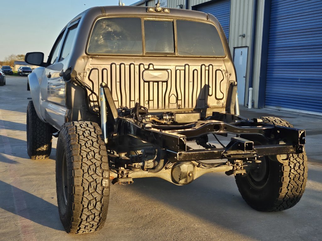

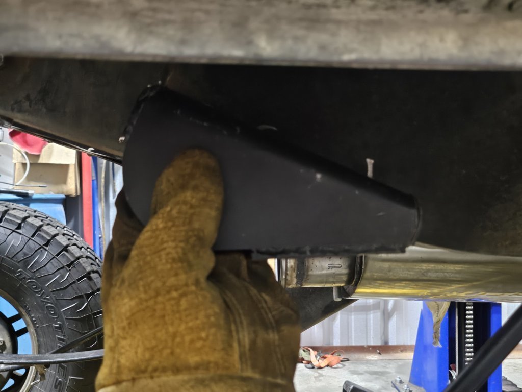

    Been wrapping my head around myriad of forums and doing my own calculations and cross checking. Frenching the front hanger and inboarding a few degrees will contribute to a lower ride height and improved handling characteristics.
    I have some interesting things going on in the rear that I'll post once I finish it.

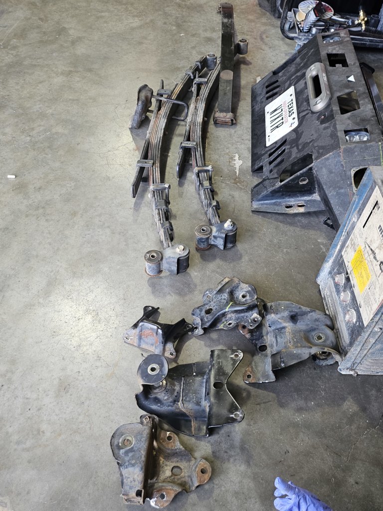

    That's what I have currently setup but based on my shock tower and lowers axle tab location they're still a bit short imo. 255/70 is the stiffness vying they offer which is what I opted for to compensate for the softer chevy leafs.
    Pic is of stock oem leaf pack with aal. Just chopped everything off recently

    And just to confirm you went with the 14’s?
    I have the bamf hangers and some Tmr ones to mess with. Not sure if I’m going to have them on the inside or outside of the frame for clearance of tire and more wiggle room with the flatbed.
