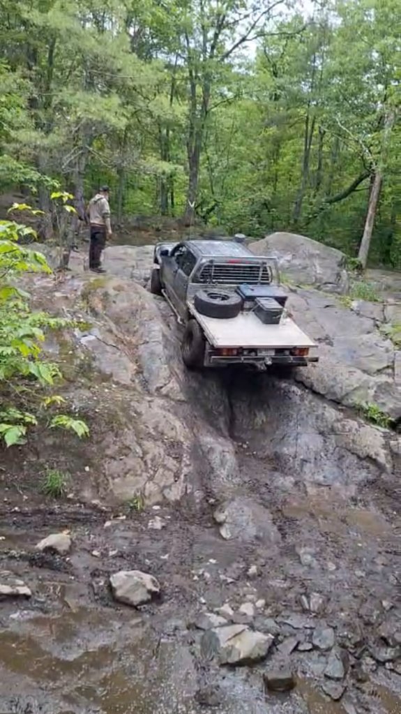

    I am planning to just mount the shocks to the flatbed I am going to build. I was going to do frame mounted towers but I want to keep the flatbed as low as possible, while having the shocks as high as possible.
    Doing 14's outside the frame.

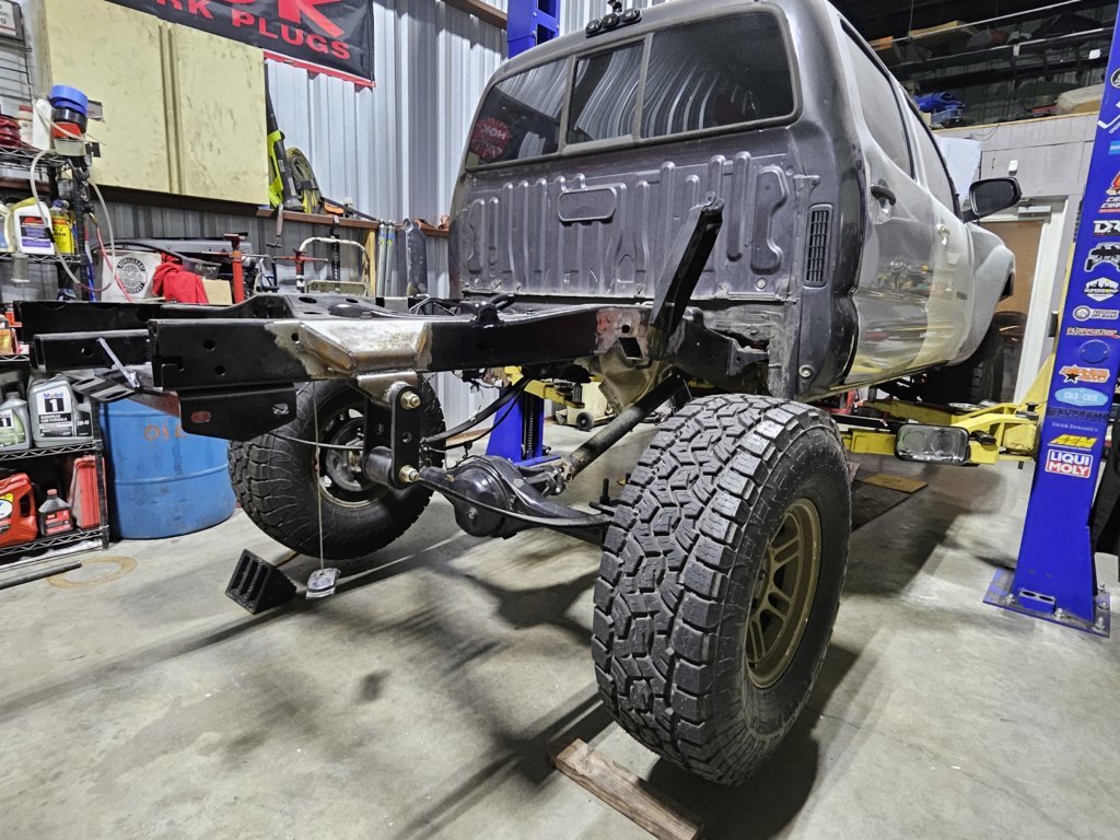

  5. Feb 20, 2025 at 7:21 PM
    #1205
    will.i.was
    will.i.was Well-Known Member
    May 6, 2018
    #252688
    1,705
    Will
    Houston, Texas
    SC 2.5

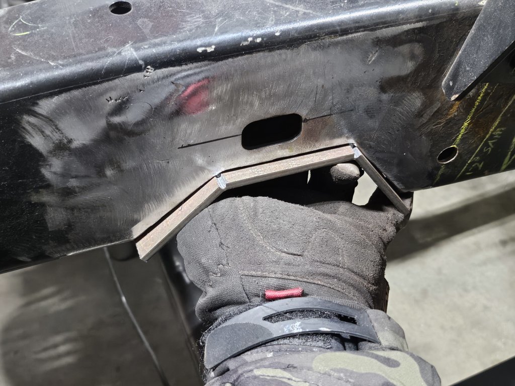

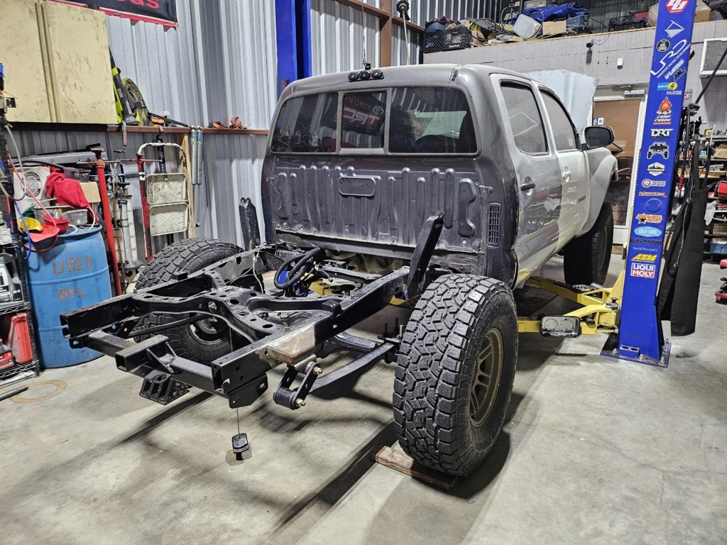

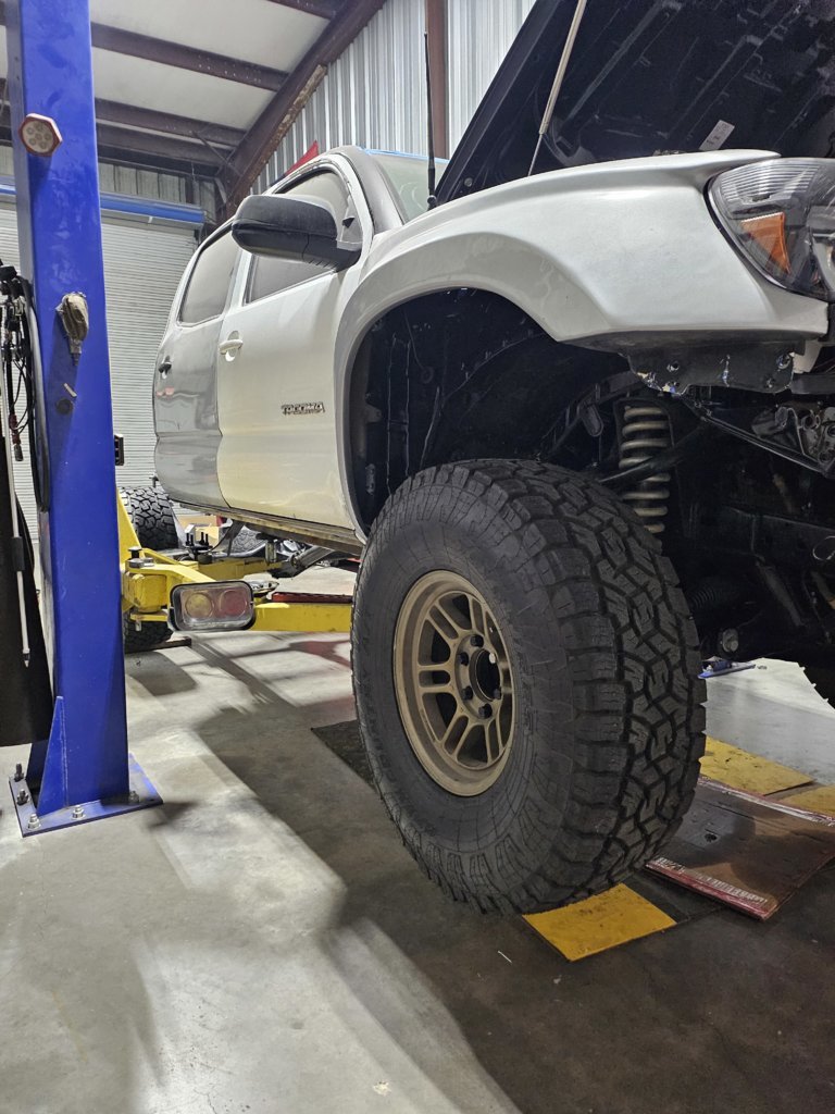

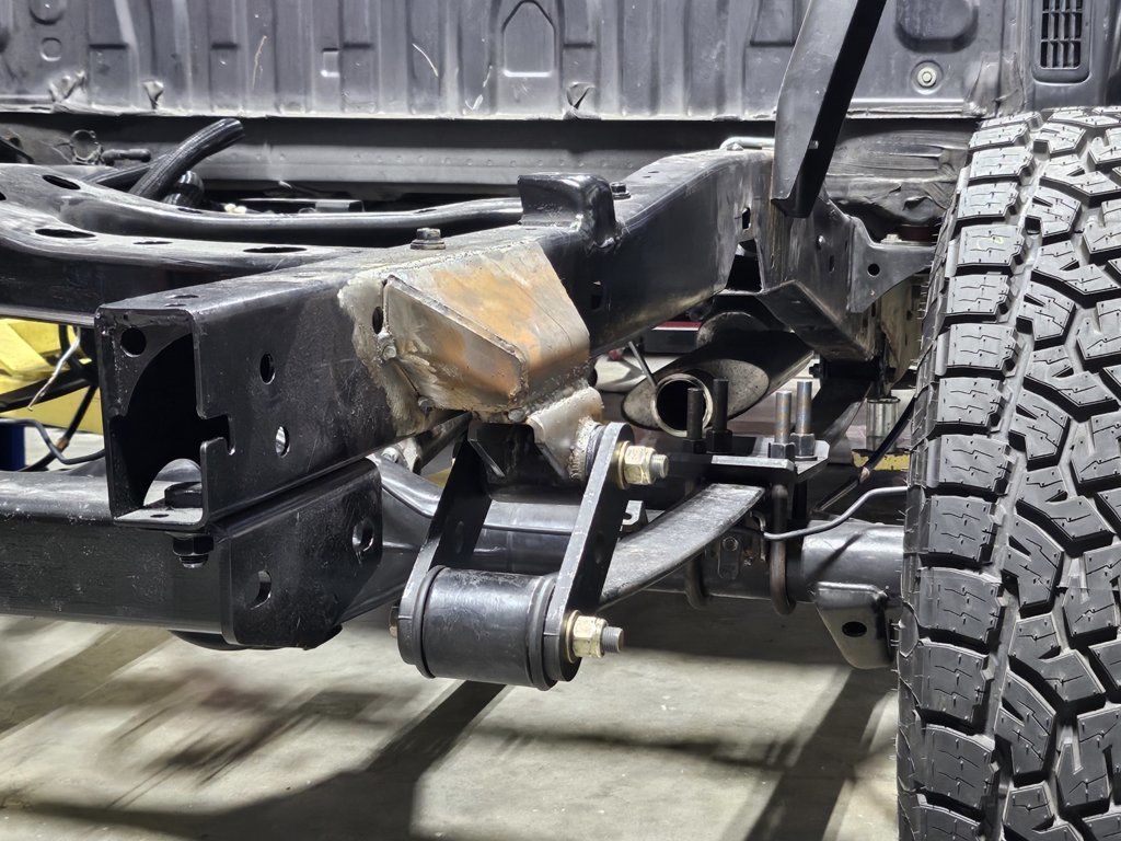

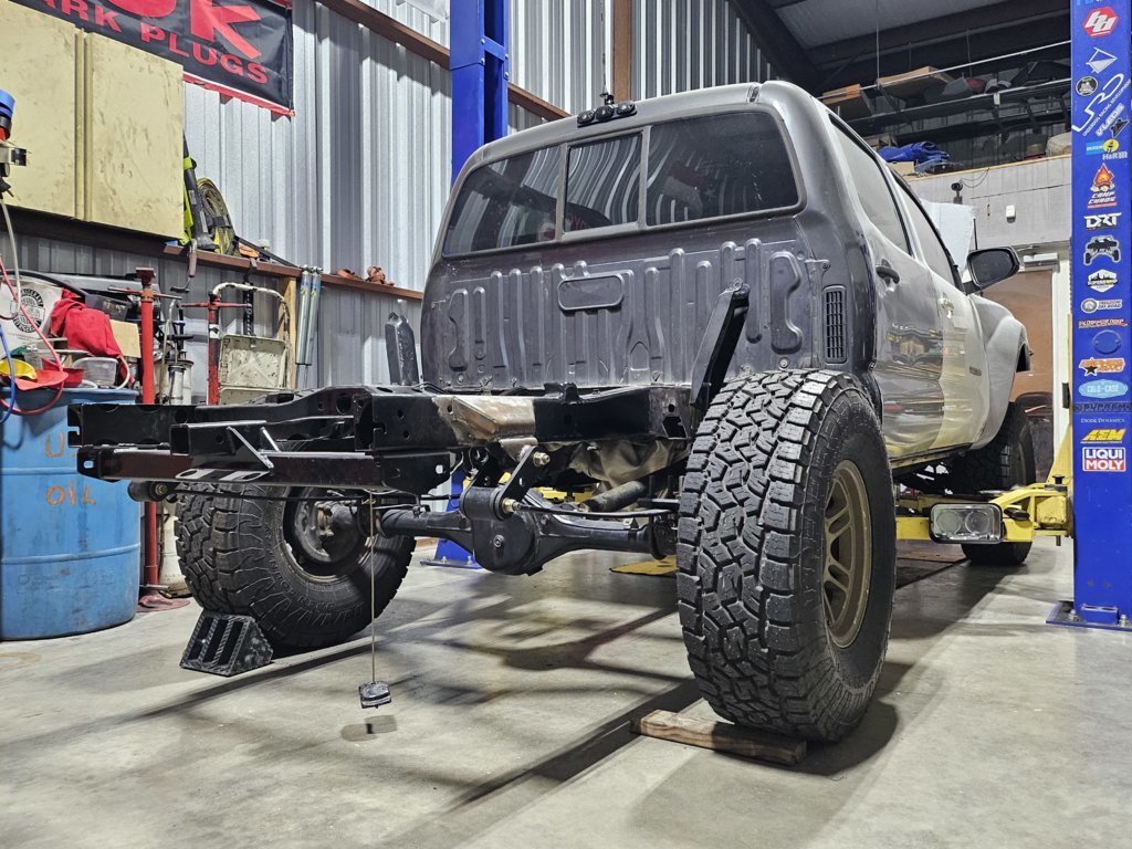

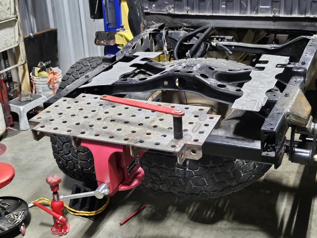

    Here's how I deciphered the swap. I believe if you want the least drop the rear hanger has to be oriented this way in order to preserve shackle angle.
    I cut the outrigger and mounted it up more and frenched in my front hanger. I aimed to inboard the fronts of both leafs in order to gain tighter roll steer and induce lateral rigidity.
    The frenched front hangers modify the thrust angle and technically should make my ride softer. Additional wheel separation from body is a bit more during acceleration.
    Overall i achieved what i spent years researching and countless calculations. I actually may have to go to a longer shackle. We will see what happens when I assemble my bastard pack.
    I have a small puck the size of the leafs I'm running in between the perch and upgraded bolt plate.

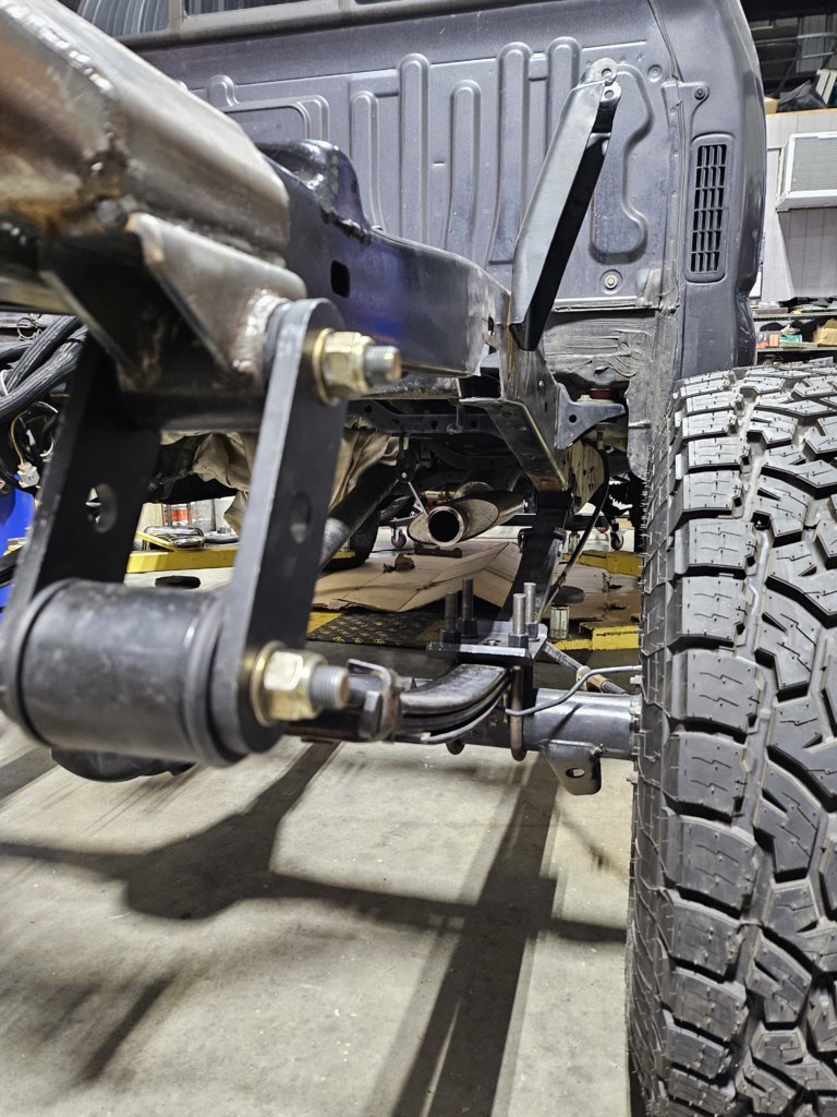

  6. Feb 21, 2025 at 9:37 PM
    #1206
    will.i.was
    May 6, 2018
    #252688
    1,705
    Will
    Houston, Texas
    SC 2.5

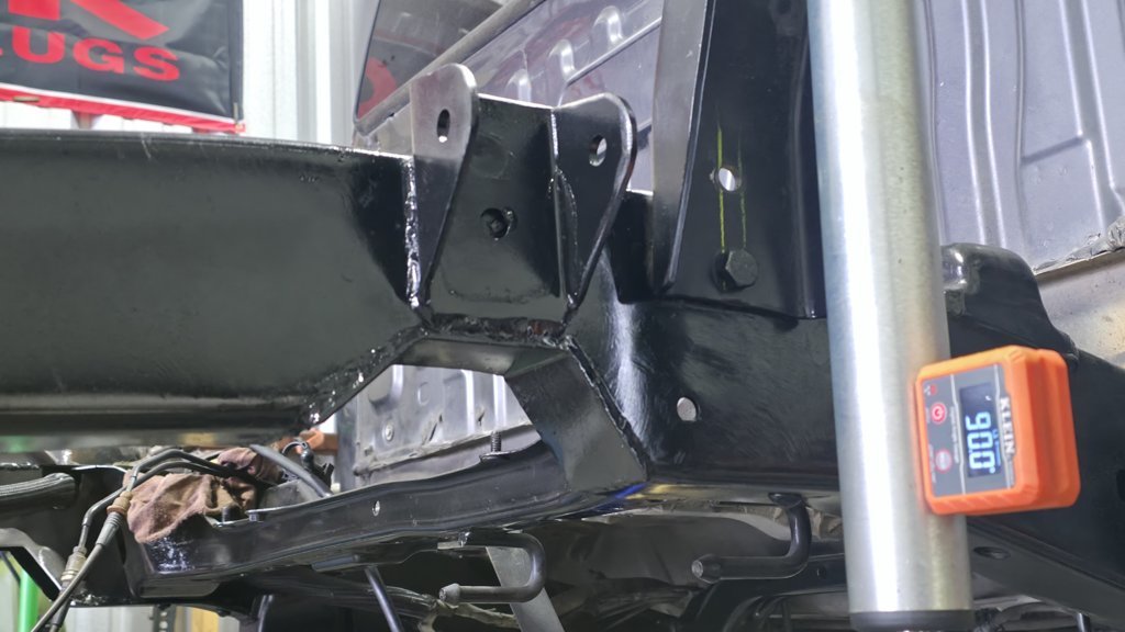

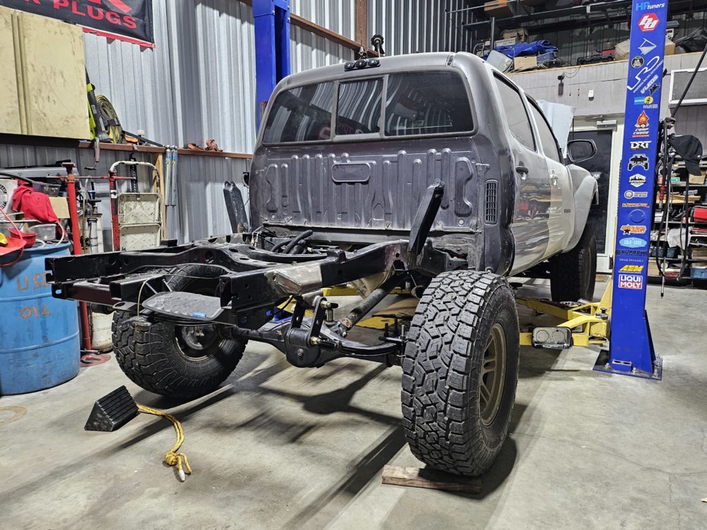

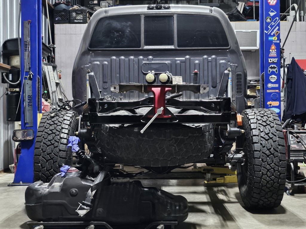

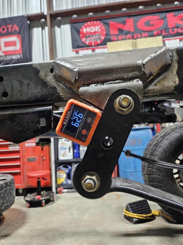

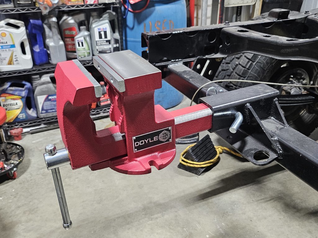

    I believe the coveted shackle angle at ride height is a really bad baseline to go by after taking weeks to do this. 90* droop is a much more important factor but also hanger mounting distance based on your proposed shackle length, flat pack length and expected weight.

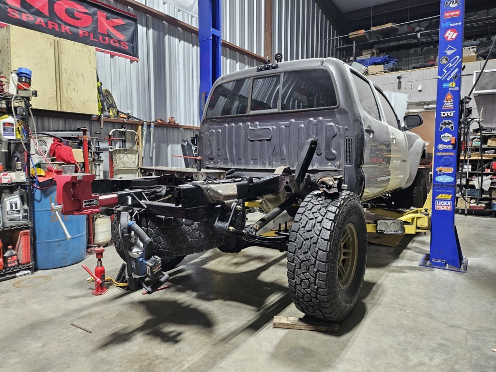

  13. Feb 24, 2025 at 7:33 PM
    #1213
    will.i.was
    May 6, 2018
    #252688
    1,705
    Will
    Houston, Texas
    SC 2.5

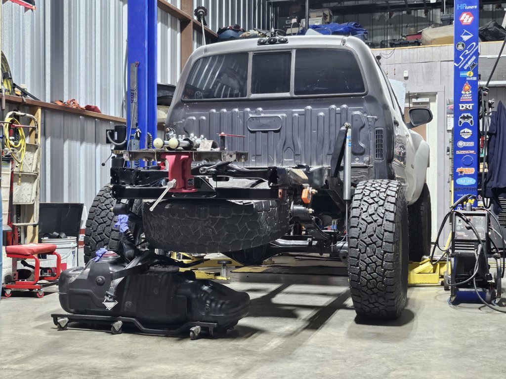

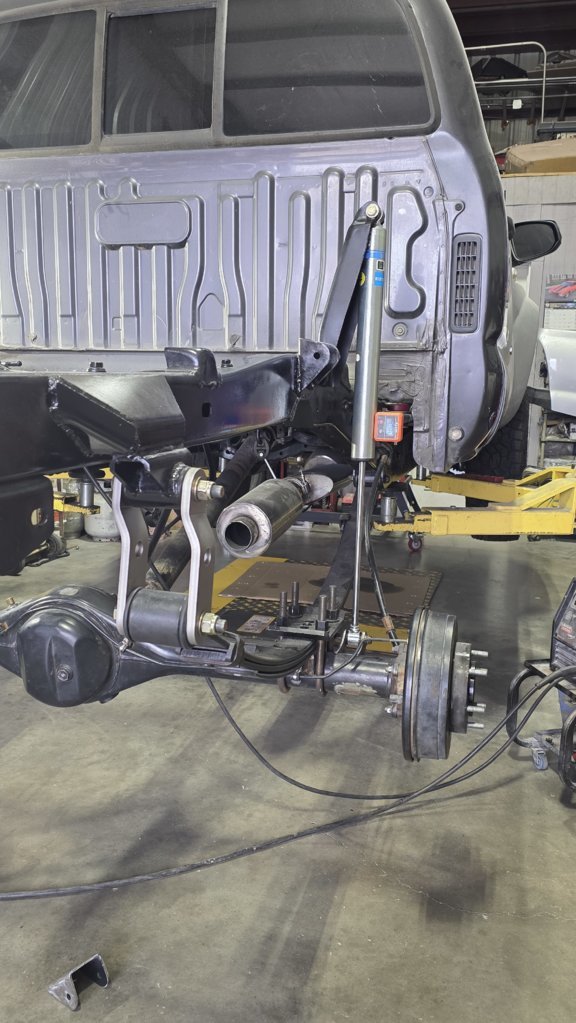

    I know I'm being a little sissy because it was only maybe in the teens with the wind chill factor. It's been very odd preheating 10* metal and seeing the water vapor just dissipate off of the steel. It really does remind me that prep work matters.
    I started some welds and they looked like utter dookie without preheating. I'm used to welding everything before my sweat flash rusts surfaces and I have to wire wheel or sand it down again lol
    Anyhow, progress slowed again as it warmed up but i have mad some headway and got some gadgets in the meantime
    ... my shock angle is way off and so are the axle tabs. Need to do something soon because it's been stuck on the lift way longer than expected and I'm running out of motivational steam.

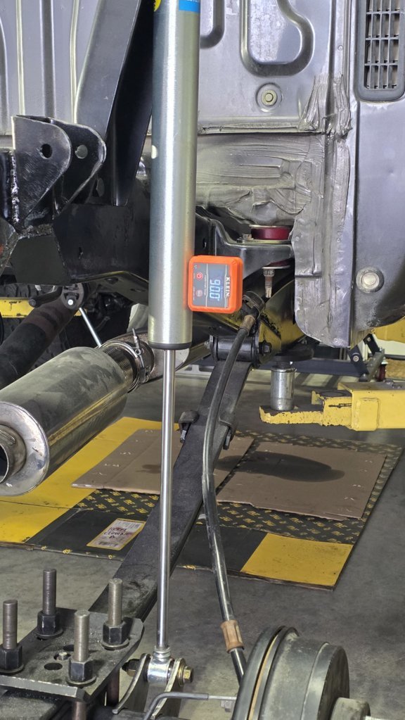

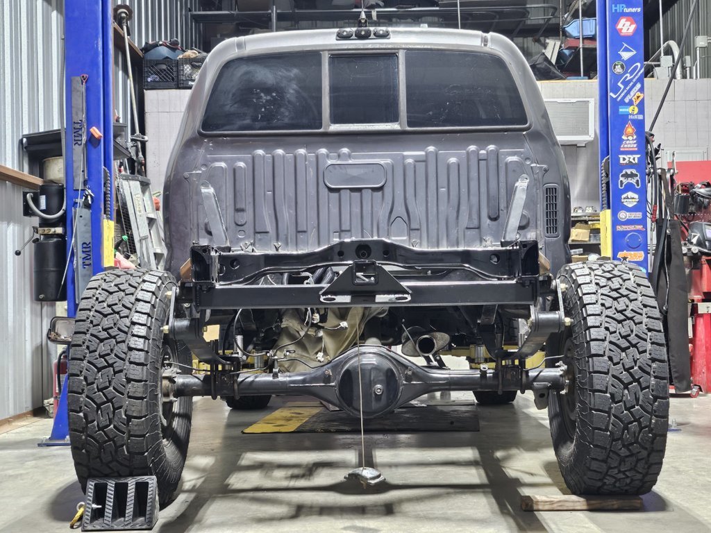

  14. Feb 26, 2025 at 8:44 PM
    #1214
    will.i.was
    May 6, 2018
    #252688
    1,705
    Will
    Houston, Texas
    SC 2.5

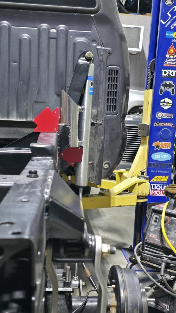

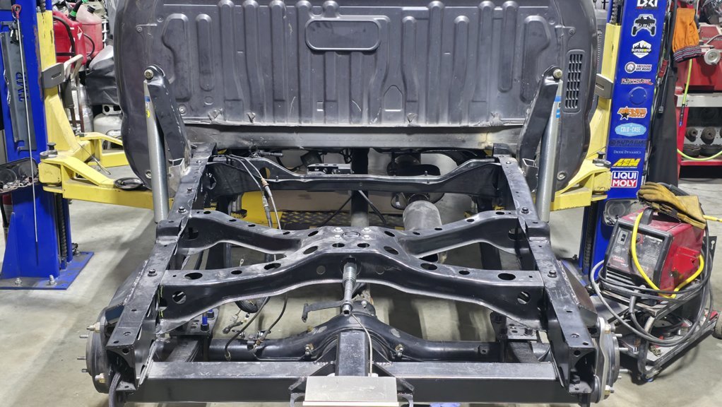

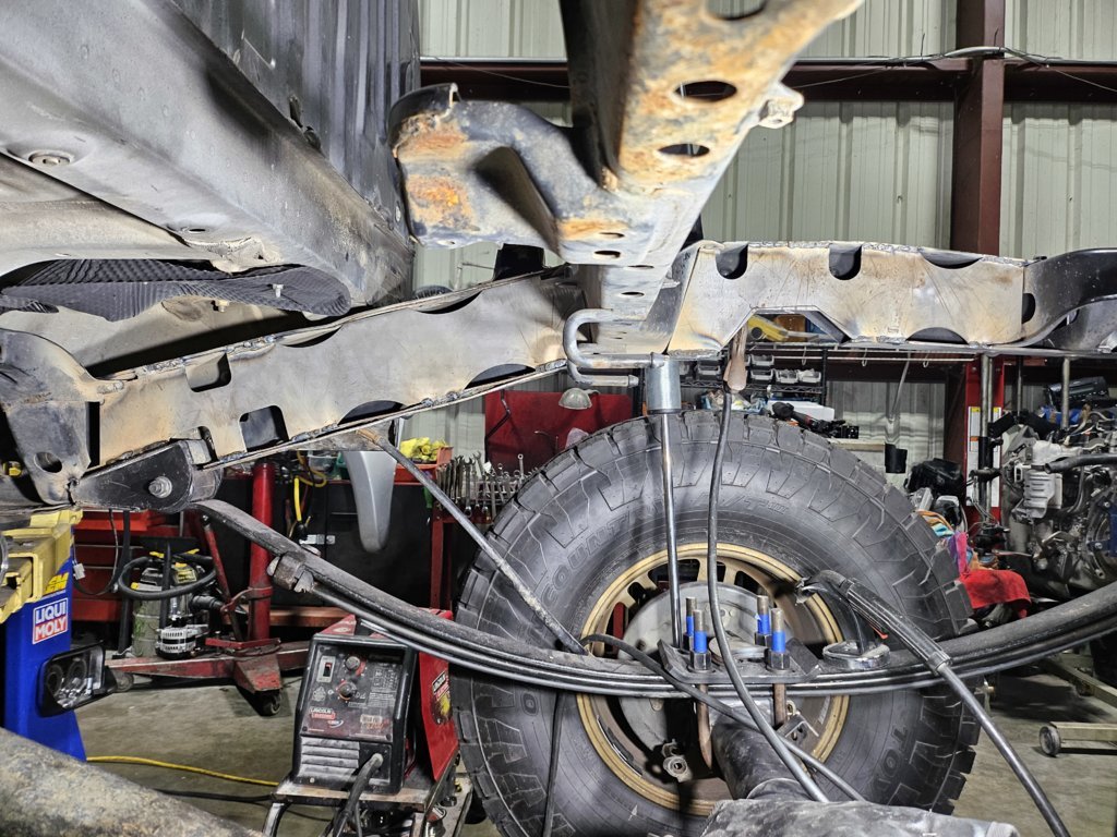

    Well I burned in 90% of the frame plates and got everything laid out as planned. Stopped welding after my fingers were cramping up after a 12hr work day already.
    The ride height is slowly coming down nicely as I'm fusing additional metal alloys to it.
    My initial 12* shock angle is completely null and ideally it is almost straight up and down. No complaints here besides my bedside chop will be drastically different.
    Will probably end up running through some welds again. I got really sloppy lol late night welding isn't my forte for sure. 20250226_210845.jpg 20250226_210752.jpg 20250226_205230.jpg 20250226_202956.jpg

    Man does this thing flex.
    Disclaimer no shocks are attached but I dont think 14's will limit it much.

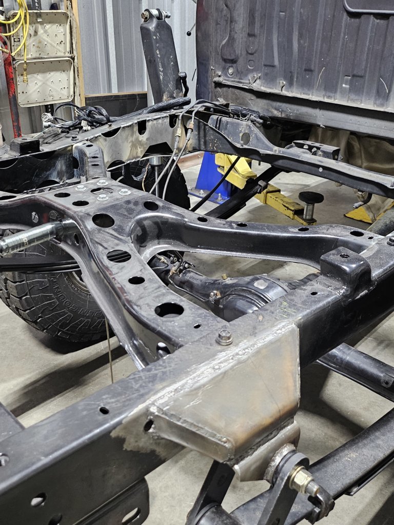

  16. Mar 11, 2025 at 12:14 AM
    #1216
    will.i.was
    May 6, 2018
    #252688
    1,705
    Will
    Houston, Texas
    SC 2.5

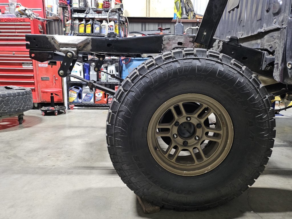

    Finished boxing the frame with axle notching. Dialing in the shock and hydro mounts. Got some 6" offset shackles in but going to step up to 7" due to plenty of stretching room. 14" shocks are too short as shown and I already have a solution.
    Overall im happy with how my frenched front hangers came out. It took alot of time to not half ass it just to slap it on and to just really think everything through.. definitely changed a myriad of variables.
    20250309_203318.jpg 20250309_203540.jpg 20250309_173656.jpg 20250309_173850.jpg
    dk_crew, tacoma16 and Windigo like this.

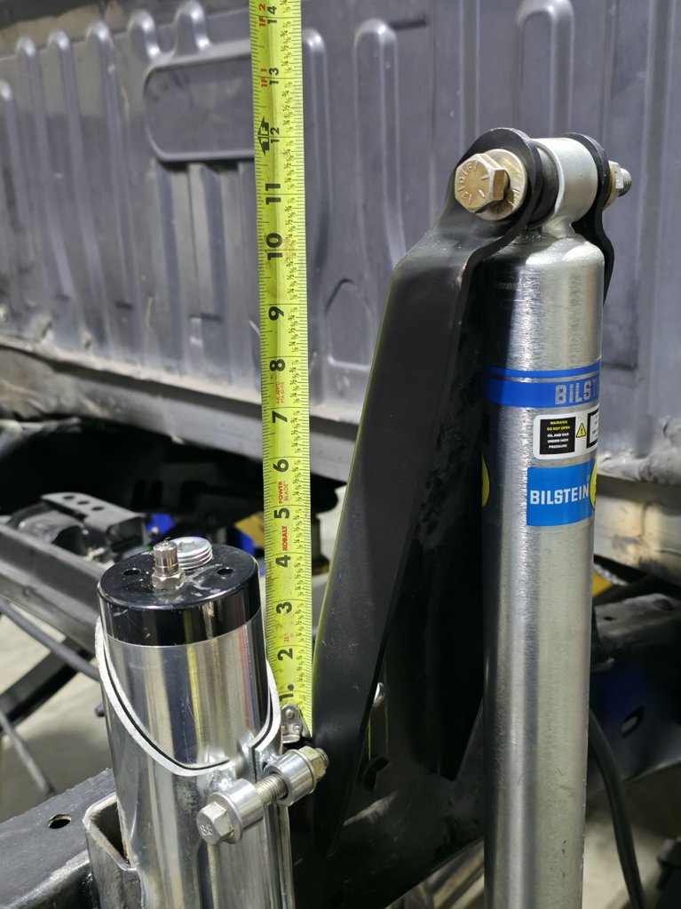

    Question about the shock tower. What’s the distance from the top of the tower to the top of the frame. Wanting to fit 14’s but I’m not sure I’ll have the room with the flatbed I have.
  18. Mar 11, 2025 at 5:39 PM
    #1218
    will.i.was
    May 6, 2018
    #252688
    1,705
    Will
    Houston, Texas
    SC 2.5
    Top of the frame to shock tower eyelet is about 11-1/4" - 11-3/8"20250311_193816.jpg
