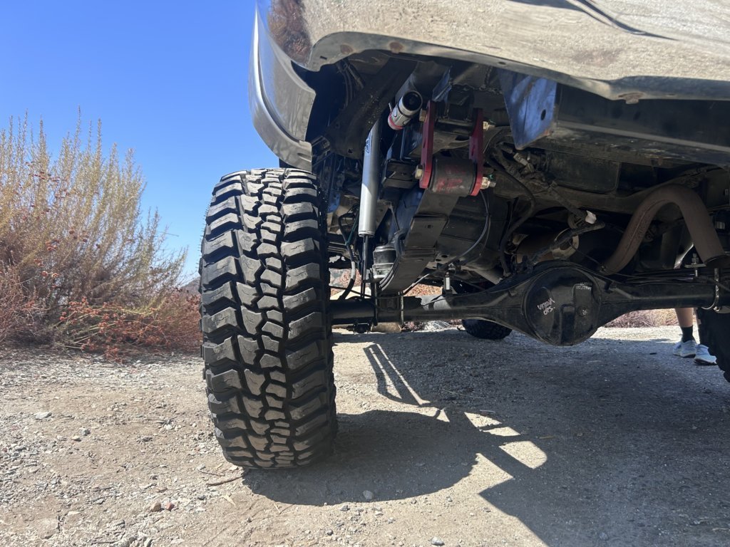

    Correct, I’m at 1.25” spidertrax spacers. Check this out IMG_0769.jpg IMG_0768.jpg
  2. Mar 14, 2025 at 7:27 AM
    #1242
    TacoTuesday603
    TacoTuesday603 I welded it helded
    May 3, 2021
    #364592
    3,523
    Jack
    New Hampshire
    2011 OR DCFB
    Fox and Locked suspension 63's Skinny 33's
    Whats your tire to shock clearance at ride hieght? Around 2"?

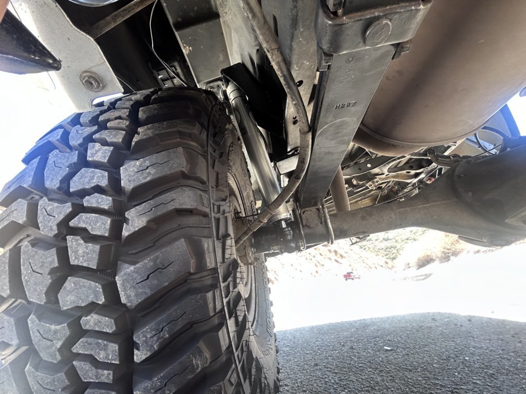

    I have 35x10.5 Kendas on SCS -10’s with 14”X 2.5”’s and still have to run a 1.25 spacer if that helps. I think it still barely rubs at full twist. I’ve never been able to recreate it rubbing by flexing it out and checking but every once and awhile I see rub marks on the shocks. I figured I’m right in the cusp and I’m probably going slow enough it’s not actually going to cause enough problems to worry about it. It’s probably just 10’-15’ of driving out of 265k miles. I started with 2” spacers and worked my way in. 1.25 seems to be the sweet spot. I think if you’re going to French the frame, box everything and you’re gonna be going through the bed at that point I think you could run a 14”-16” coilover and a trailing arm set up might be starting to come into play. It’s like where do you stop.

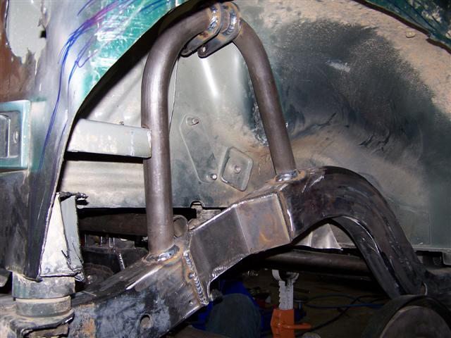

    That's correct. You're probably looking at something closer to this, but not as aggressive. If you search for frame notch, most of what comes up is a horizontal bitch to allow the axle to come up higher, which you shouldn't have an issue with.
    tacoma16[QUOTED] likes this.

    Okay I believe those towers are cut into the frame. I’m following. lol
    okay perfect, I have some Tmr towers so I may be able to mess around with that. They are super beefy for shocks but they should help keep the frame together with a small notch.
    colinb17[QUOTED] likes this.

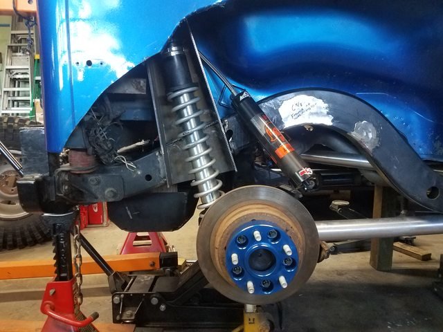

    Yeah, if you're talking about the TMR coilover towers, you can absolutely use them as the notch filler. A crossmember at a notch point is also a good idea. $10 of tube will do wonders for the frame integrity.

    Yeah may have to put a tube on the tower itself depending on where the tower lands with the gussets I have on the boxed section. Thicker plate too where the frame boxed. Will see. May just send it with the bamf ones….all the options.
    Wasn’t planning shock towers when I did the bracing. Just wanted to stiffen up the frame to not break another bed.
