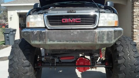

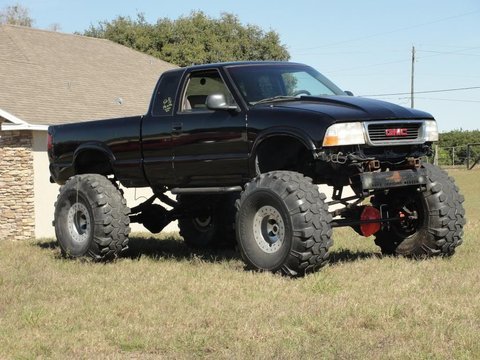

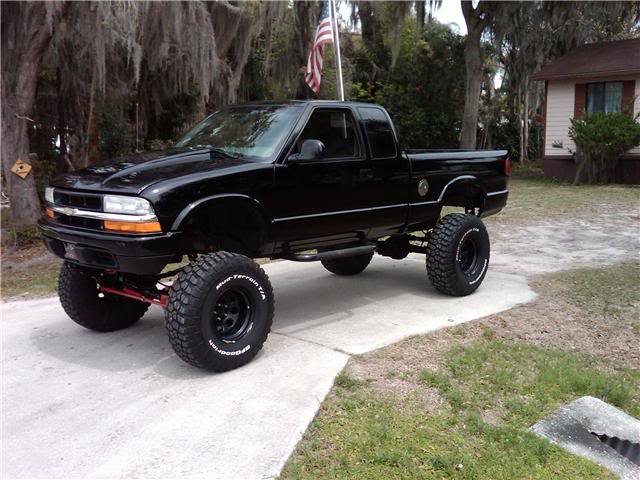

    sounds like him, he did have a S10 SAS

    Haha that's me. It made it to Dana 60/14 bolt and 44s then got tired of being broke

    did you sell the s10 and get a sonoma for the Dana 60?

    It had a conversion done on the front. It was a 94 with a 98 and newer front Chevy but the Sonoma/Jimmy stuff fit the 98 up s10/ blazer.
