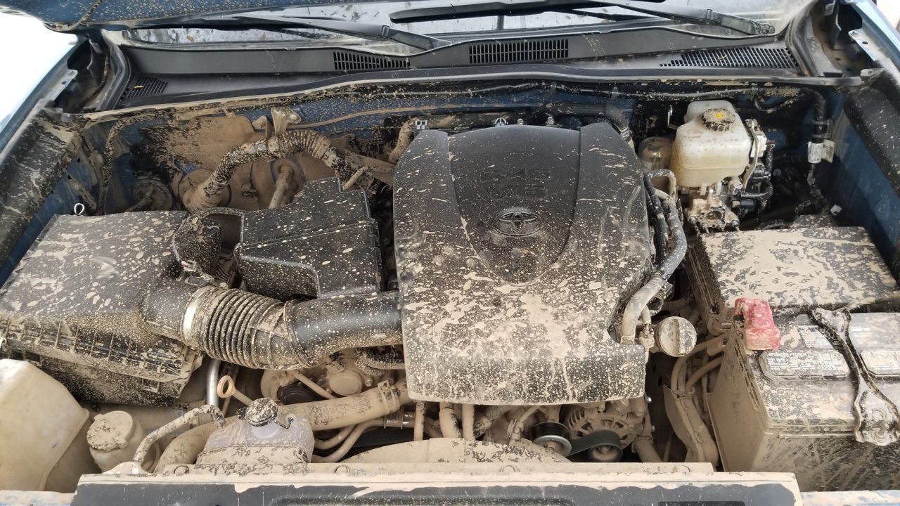

    Hi all,
    Wanted to ask what I need to do to clean my engine bay. I took my truck off-roading for the first time and got a lot of mud built up. What's recommended for cleaning engine bay at home? I've got a pressure washer with a low setting, was told that would be good enough, but I don't really know what to cover as well. And are any cleaning products necessary?

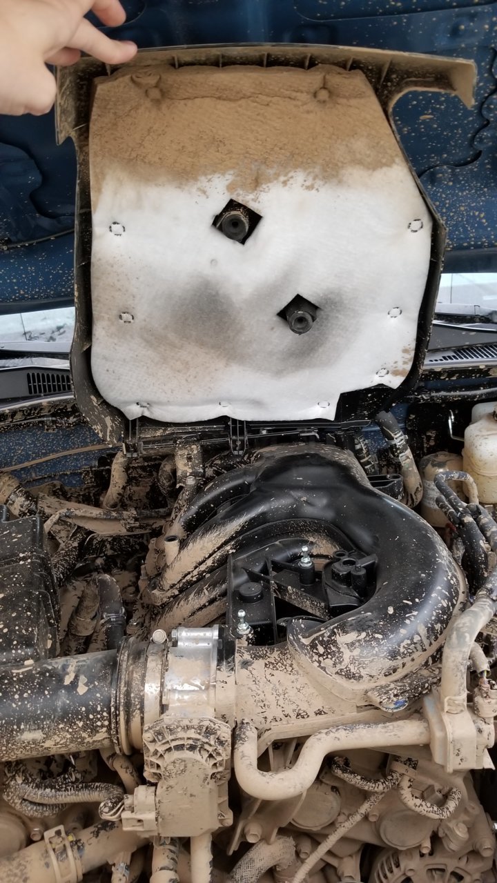

    Also! Does this engine cover thing need to be replaced or is there a good way to clean that white material?
    Made my blue turn to brown..

    Do not use a pressure washer on your engine. Too much risk of forcing water into a connector or several.
    Cold motor. Presoak the mud, and keep it wet for 10min or so. Then, Simple Green 1:1 with water. Don't let it set long at all. Rinse very well, esp bare metal surfaces.
    Use the pressure washer on the radiator though. From a good distance.

    Thank you. I'm guessing I should use a regular garden house then for pre-soaking the mud?
    tonered[QUOTED] likes this.

    Yes. Stick with the garden hose for everything but the radiators.

    1) engine on and hot, not off
    2) if simple green it needs to be the aluminum safe version not standard

    I'd take it for a run after the clean, but always cleaned cold. That's just me.

    I pressure wash about every month. Every vehicle I've ever owned. Never an issue, but I'm quite a ways away. Ymmv

    Aka the lube tech would just take it out back and blast it with a pressure washer haha
    As far as the white material, I use an air compressor with the air nozzle thing. Not perfect, but when dry most of the mud turns to dust and just blows away.
    Also, some microfiber towels work really good imo for the engine bay. Rinse all the heavy mud off with a regular hose first

    What all do you cover, if anything when you use your pressure washer? And do you use it on the low pressure setting?

    I don't cover shit. On the old accord I'd cover the inlet for the air intake but that's about it. I stand far back though. It's basically like misting it
