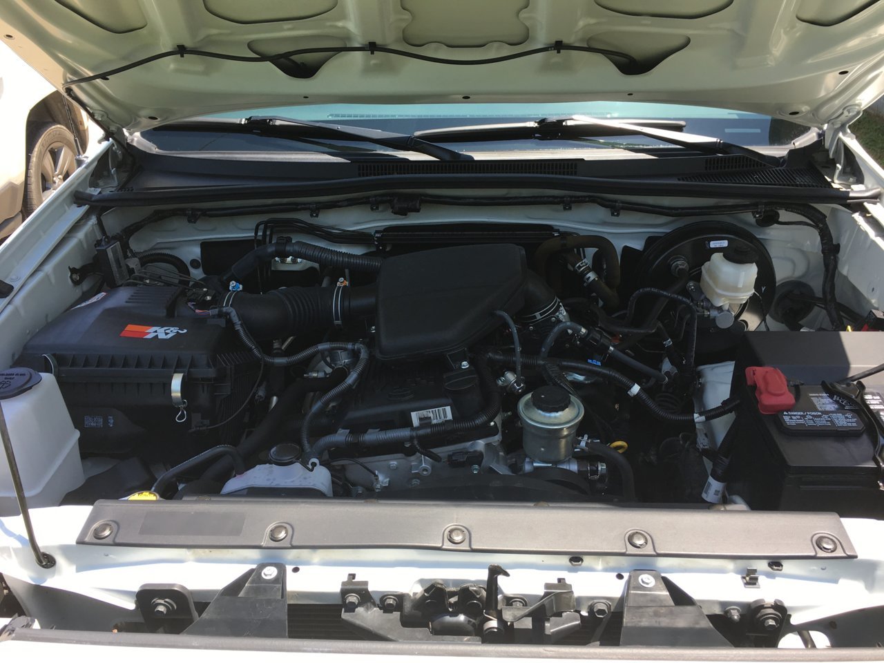

    wow! thats some mud... i guess you have to be a bit careful so that you dont get water on electronics but still!
