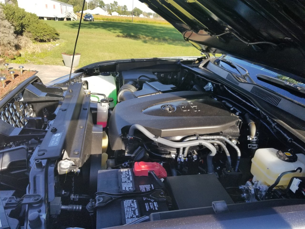

    Quite a few things at this point..
    I have a pretty "weak" electric pressure washer, 1600 psi at 1.2 gpm, was only $100. I'm thinking that will be safe? I definitely don't plan on leaving it on one spot, but fanning it around always having it in motion.

    Yes. Just don't square up on a connector and unload. You'll be fine. If it makes u feel better take two steps back. Get a feel for how much pressure you're putting on it and move in slowly as u get more comfortable. You're over thinking it lol

    When I had my '92 Civic I would pressure wash the engine no problems. I just made sure to avoid as best I can the distributor, spark plug holes and anything I thought would be damaged by the pressure. Otherwise I had the nozzle right up on the grease, oil, mud and whatever. You mentioned you have one of the cheaper electric pressure washers, I would used the 40* nozzle or whatever it is that is before the mist nozzle and use that with a scrub brush for the really hard stains.

    Safe for aluminum. Use on cold engine.

    How long should I let my engine dry if at all before starting it up again?

    No need to wait. Jump in and go for a drive to sling it all off.

    Bigger mud puddle should get the rest of the engine.

    In my 30+ years of driving a vehicle, I have always cleaned my engine bay. Never a problem of any kind due to cleaning. I've cleaned many types of cars, trucks, and different makes.
    Go to the car wash and spray it down with the engine cleaner setting. Let it sit a few minutes. Spray it down with rinse. Don't worry about anything. It will be fine. Do it with the engine warmed up. Drive it around a while to dry everything. After it's dry, spray the whole engine compartment with TIRE FOAM. Use the foam it works better than spray. Let it foam up and run off. It will look as good or even better than new. The foam treatment will help with future mud and keep it from sticking as much.

    Ive just been rinsing mine. Just get the hose and rinse the bottom of the hood, then work your way down. I also put the hose behind the radiator, between the fan's blades and rinse the radiator from the back to the front.

    Here's where I'm at after a soak and rinse. Used my pressure washer after all with the 40° nozzle. Much better I think hah. I'll probably get more detailed when I've got more time. Thank you all so much!!20191024_134908.jpg
