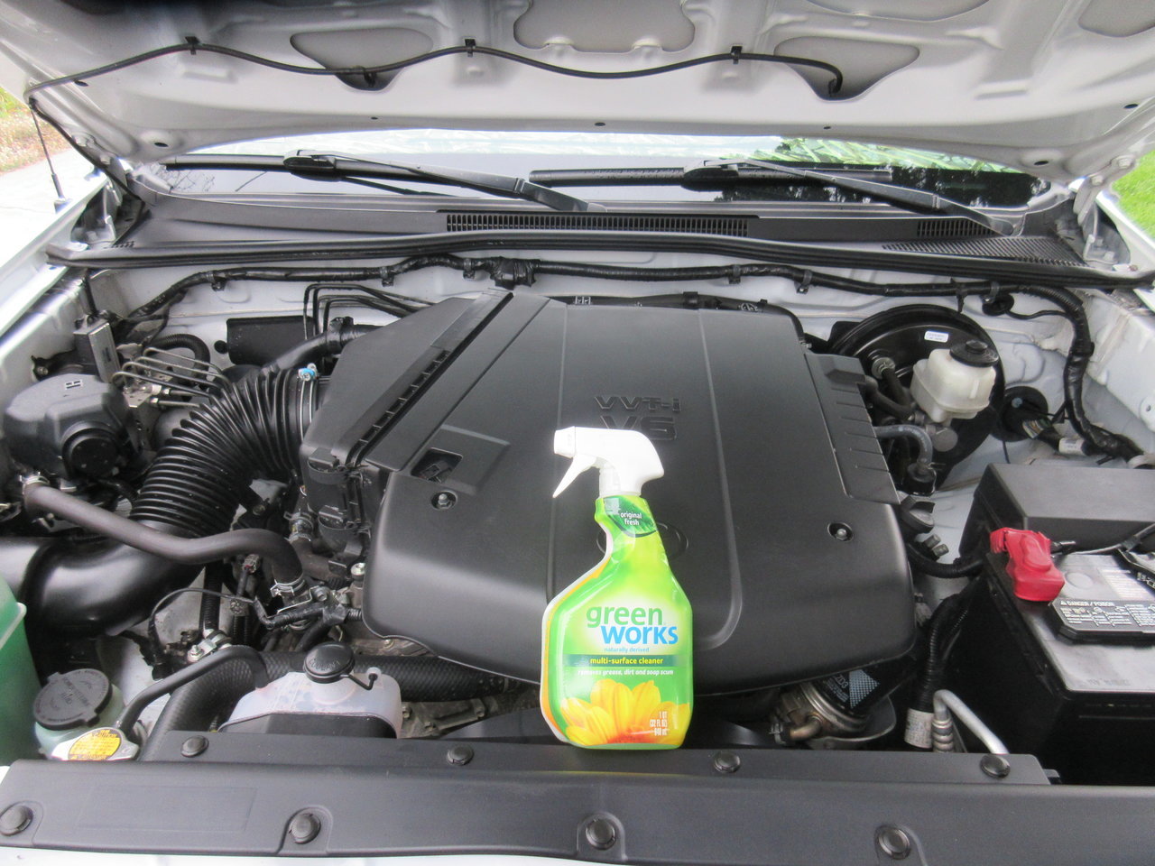

    I personally like Simple Green, or in this case Green Works. Its the same as simple green. Just to be safe, before I started I put a rubber glove over my oil and trans fluid dip stick, and over my brake fluid reserve. Then sprayed the whole bay down (Low pressure) and then sprayed the Green Works on. Let it sit for a couple minutes and then hose her down. I hand dried mine instead of letting it drip dry. No more Mud!!! Pretty clean for a '15

    Cleaned mine the other day...I used Super Clean on the aluminum intake plenum, man... it does wonders. I rinsed it off immediately though after scrubbing pretty good to get the pores in the aluminum. Sorry, no pics.
