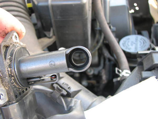

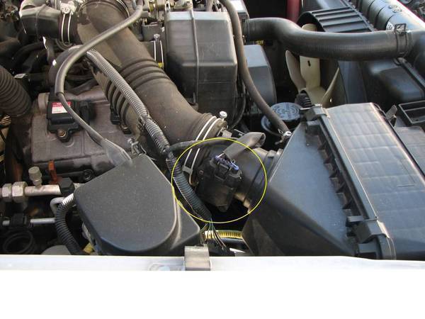

    Right after your air filter box (circled in yellow below)
    This is what it looks like. Spray with MAF cleaner, don't touch it.

    Thanks so much guys, very helpful.
