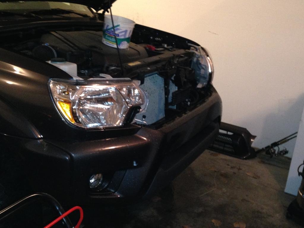

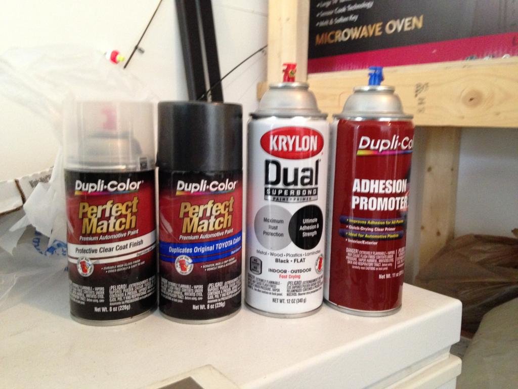

    Make sure you have the following- 10mm socket and wrench, flat head, torx bits, 3m window weld, adhesion promotor, krylon super bond primer, MGM Duplicolor, Duplicolor clear.
    663E1BD7-D984-4E57-8EF4-E4B6771CC9A1_zps_fba61e4a65a21fd042798723ae060826a63f9eea.jpg

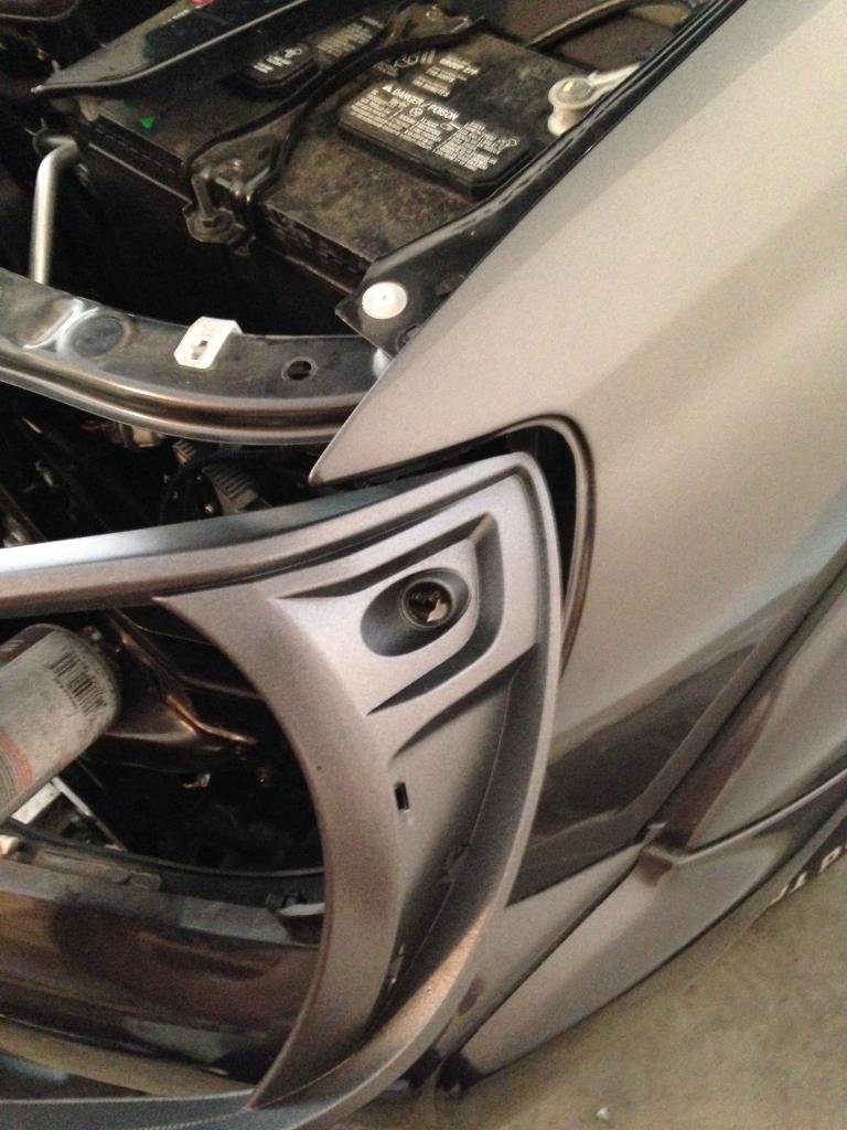

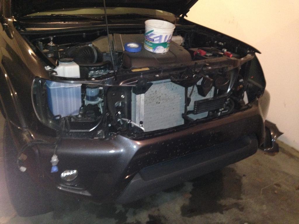

    Take your grill off, there are other guides for doing this
    02CB070D-75CA-4DA2-8479-89D206F202D1_zps_78e6042f035709335667e6cd716ac325b6ed3488.jpg
    Now for the headlights. Use this video as a guide
    http://youtu.be/NNo__Lx20y0
    82F5CE77-E771-4FDC-877C-529C16FB88E2_zps_4955e041eb0e1405b93a626a10283133d7ef9ba5.jpg

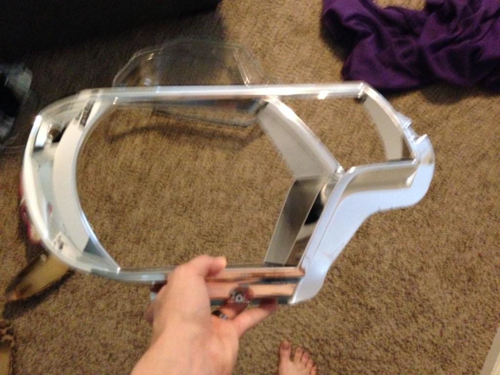

    Now to bake your lights and separate them. Remove all bulbs, rubber, and plastic from the lights. Bake them on a piece of cardboard. 320 for 11 min seemed perfect for me. Make sure to turn the oven off before putting the lights in.
    http://www.tacomaworld.com/forum/lighting/65226-how-black-head-light-mod.html
    Get the chrome bezel separated.
    5A79336B-FF3E-4901-AFB7-224C5826739A_zps_364d408c1fce918bc0798e01b1e0b0e01e8dad73.jpg

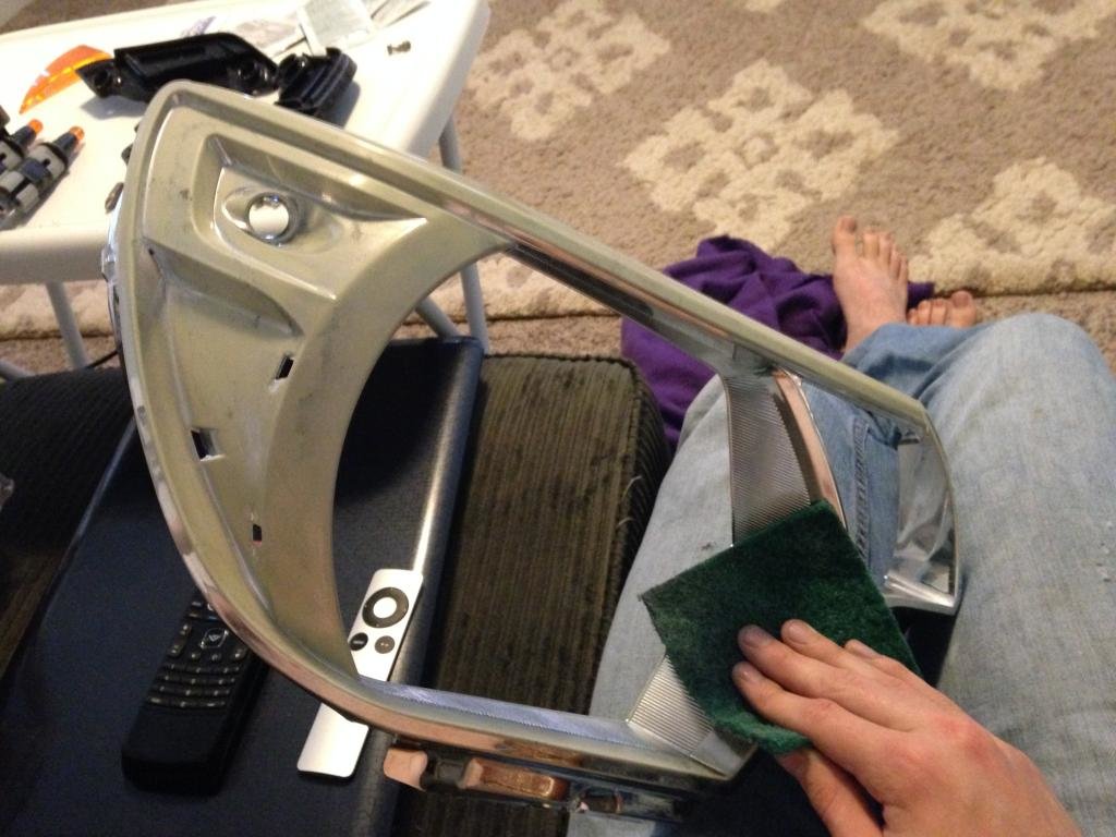

    Scuff the surface with a scotch bright pad. I tried to get off most of the chrome.

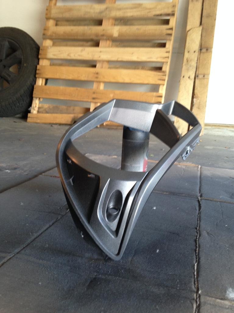

    Let that dry for about an hour. Now for the Duplicolor MGM. I did 2 light coats and it still turned out a bit too bright.
    7F603036-810E-45AC-9FA2-B91B3D0FAE80_zps_151a2e0ac4eb67c2830c920f58275058e98d4f70.jpg
    Dry for 30 min followed by 2 coats of clear. 1 light one medium. Let dry for 2-3 hours.
    30611F1A-C85B-4C0E-AAEC-1EA4DB14DD40_zps_c55f9eb93ed0e2b82a8a1df63f56f86b2662169f.jpg

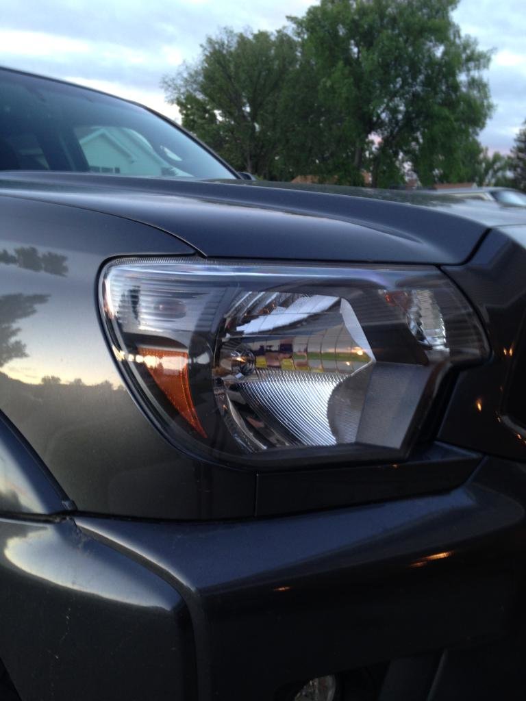

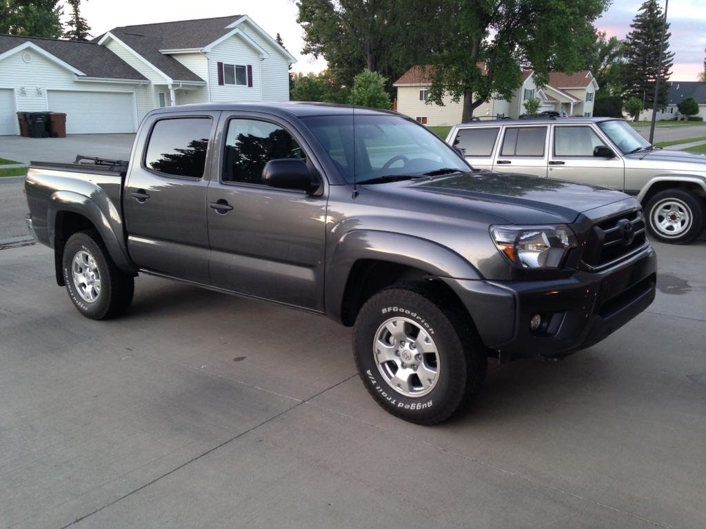

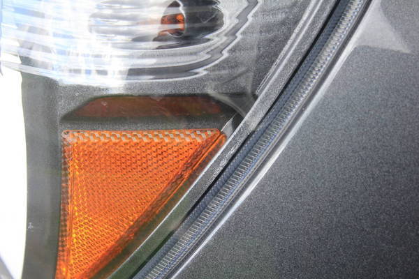

    Pop the reflectors back on, reassemble the lights, and install!
    2E706088-AE06-4D40-9F71-5504C742E4E6_zps_87bfade98360e765d3dc8f3ac116d75e9bfb9041.jpg
    FEC7DC8E-F1F7-46F9-99C9-9D4E68B0BABF_zps_1c4259d0b3db34f9c09729bddcc86dddd45d05d1.jpg
