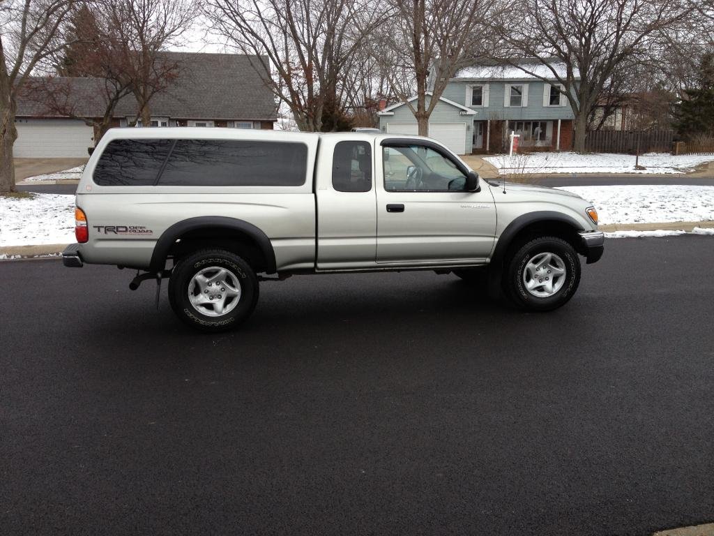

    I'm bumping this old thread because I just bought a 2001 4cyl automatic PreRunner with the TRD package. The guy I got it from is a mechanic and he said for sure it has the locker.
    However there is no button, no sticker on the door jam etc. How can I tell for sure if I have it? (Without checking the capacity of the rear end fluid?)
