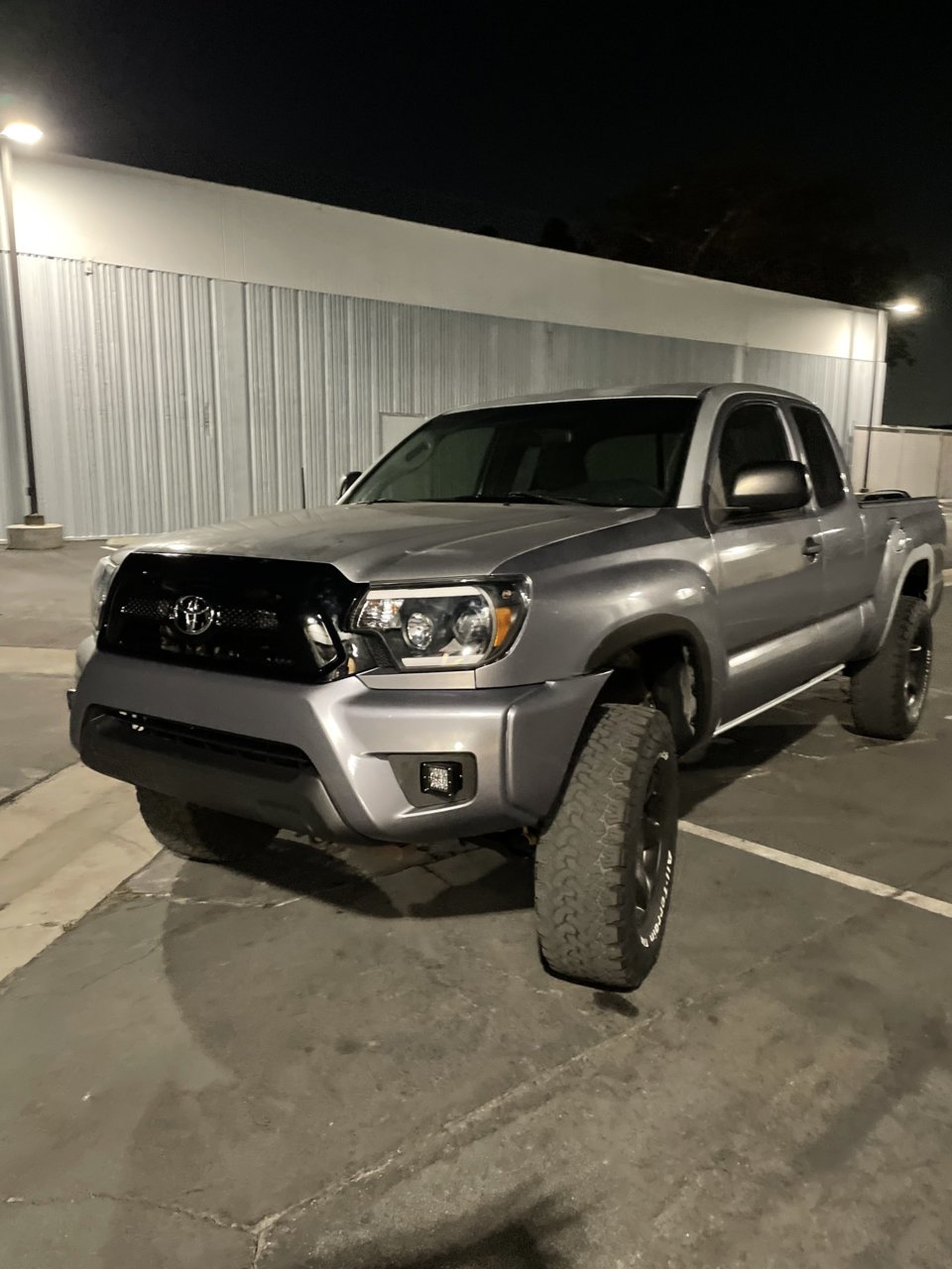

    Before:
    After: Still need to finish the flares, wrap the grille bezel and wrap the hood but this gives you a good idea of the changes

    Let's see dem pics

    Just added them to the post. When I finish the flares and everything I'll take more!

    Where is the final product?
