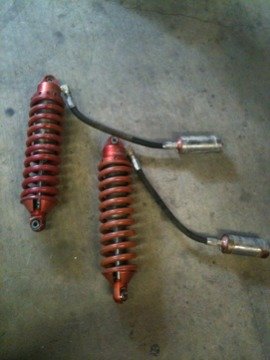

    What lb springs did you order? The 600lb springs on my girls truck is still pretty soft so we're gonna try 650 or 700lb

    I went with 650, ill probably do the 700's when I put the bumper and winch on.

    Is a 14" coil best for 2.5x6 shocks?

    nice, 650 should be perfect.
    We had 12" coils and I had to crank them down a shit ton for a good ride height, but then again, they were 500lb springs.
    The 14" coils are really nice but because of the raised spring cup, you need to compress them a little bit for them to fit, about half an inch.

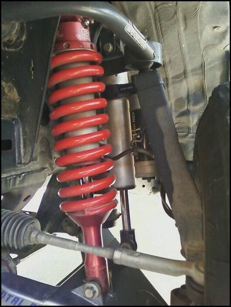

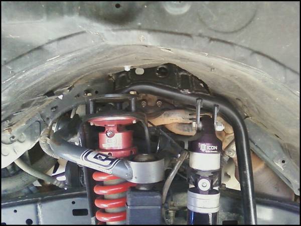

    iv'e been thinking of getting some king 6in. coilovers with res. i currently have camburg coilovers on 700# springs with no pre load. when i order my new shocks would 600#'s lower me down some? + what would be a idea valving set up for dual shocks up front? here is pic of front ride height

    600lb will definitely lower you compared to 700lb. How low do you want to be? How long are your 700lb springs right now, 14"?

    yes, the coils i have now are 700lb 14's, they have always seemed a little stiff even with no preload. i would like my ride height to be a inch or so lower.

    yeah 600 should be good....you have the defined rear right? how do you like it

    going spring under is the best :burnrubber: did 40 miles last time i went out and there was no problems
