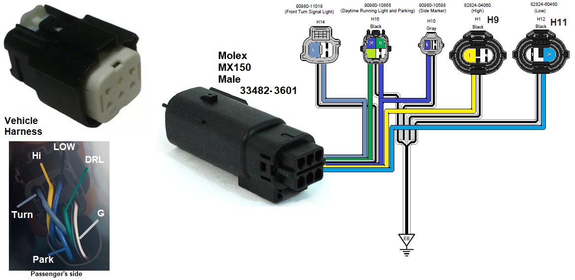

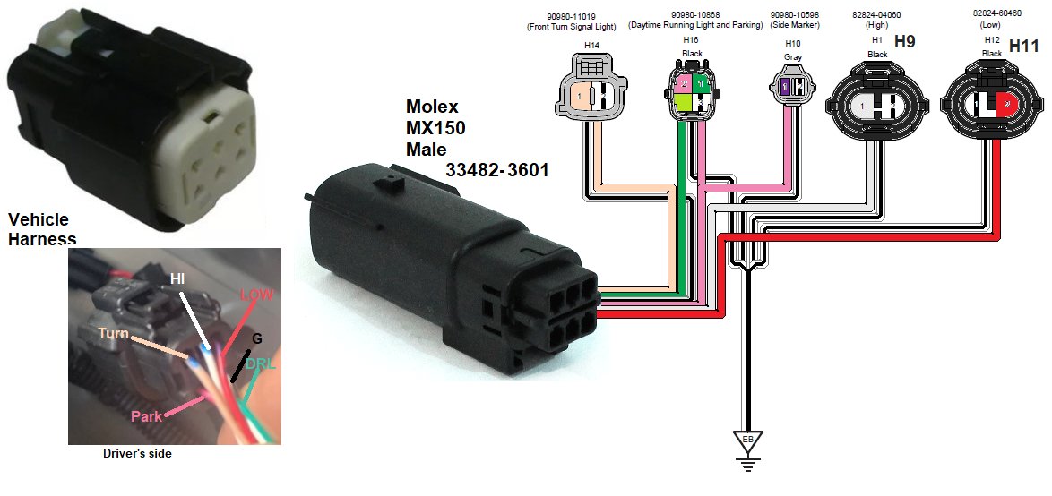

    I have made a few for this reason. Most of it is pretty straight forward, like Caribe shows here:

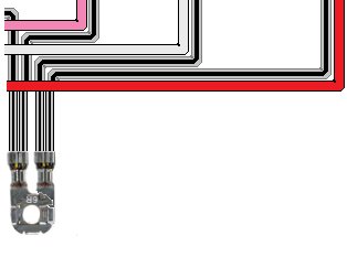

    The worst part is the grounds. The stock wiring only having the one ground spot means you need to ground to the body. So not terrible, just an added step. I brought the grounds together exactly like @caribe makaira shows, using the stock ground for the turn signal and then using 18g for the rest, tying them together into a 12g with a loop that can be used on the grounding body points by the headlights.
