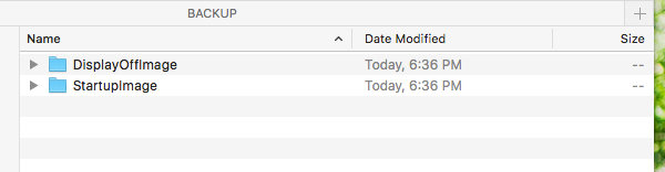

    Works like a charm. The key is the exact name for the folders

    For anyone having issues getting their usb storage device to be noticed by their truck and formatting their USB device using Disk Utility on a Mac/OS X, I realized that mine wasn't being mounted because the "Scheme" I was using wasn't supported. The default "Scheme" is set to "GUID Partition Map" when it should be "Master Boot Record".
    I used the following formatting settings and folder names to get things to finally work:
    NOTE: Those formatting their usb devices on a Windows PC would have likely been using "Master Boot Record" by default.

    Three things that have been said, but make sure you've done.
    1. Format to FAT32
    2. The folders say: StartupImage and DisplayOffImage
    3. Only have three images in each folder.

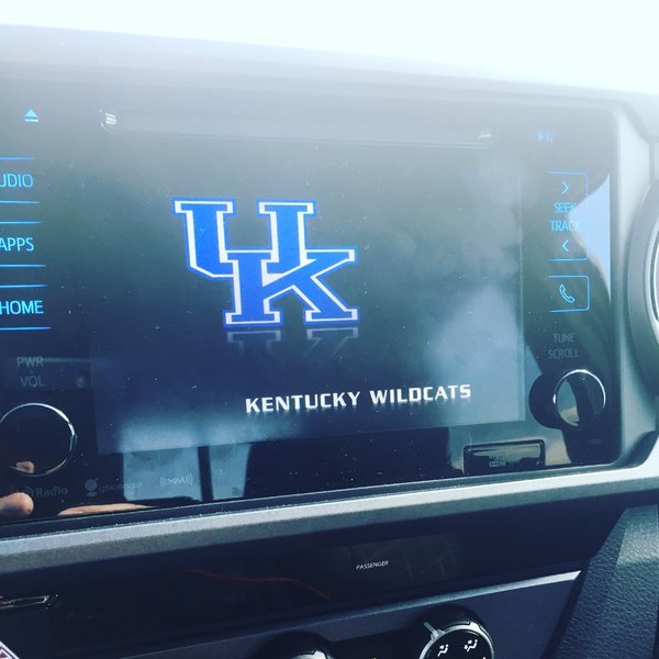

    I have attached the three I loaded that look great! Also how they look in the truck
    A couple more...

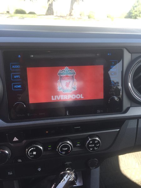

    image.jpg 2nd try it worked. Had to format to Fat32. This is my off image, have yoda as my startup
