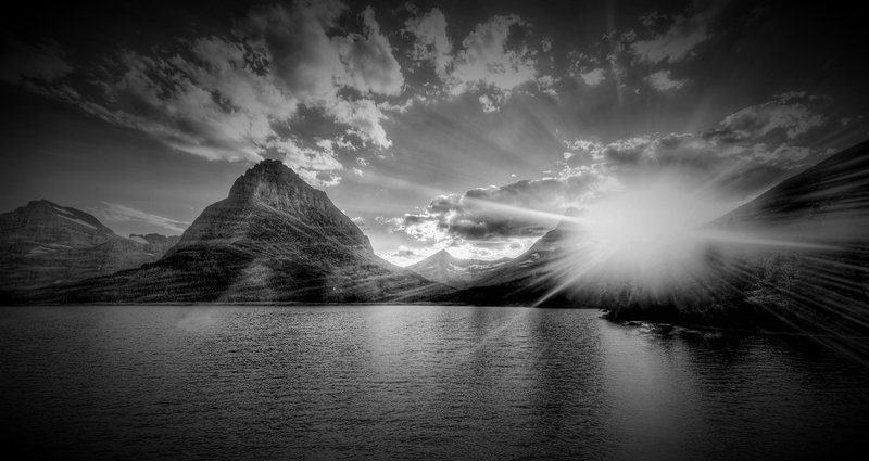

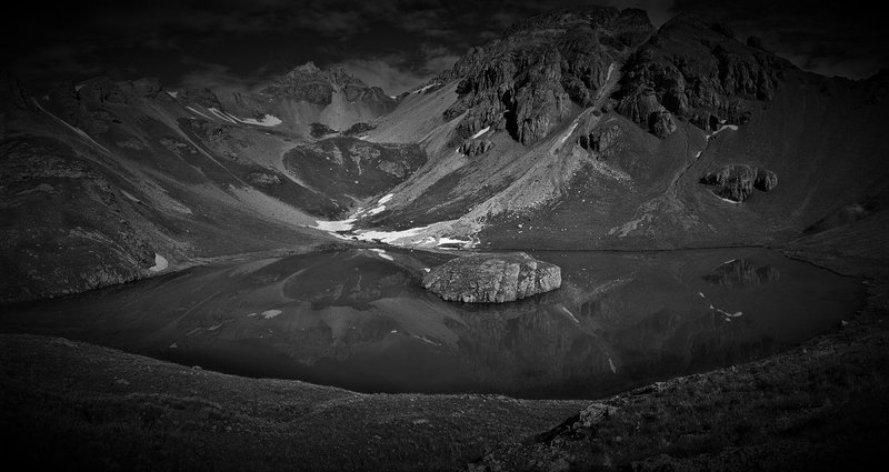

    Startup:
    Screen Off:
    Added the black vignette so the images blend a little better. Also like the look of B&W. I cropped them to 1280x680, but there's some vertical space leftover. Maybe 1280x740?? Just a guess.

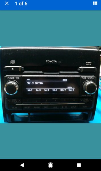

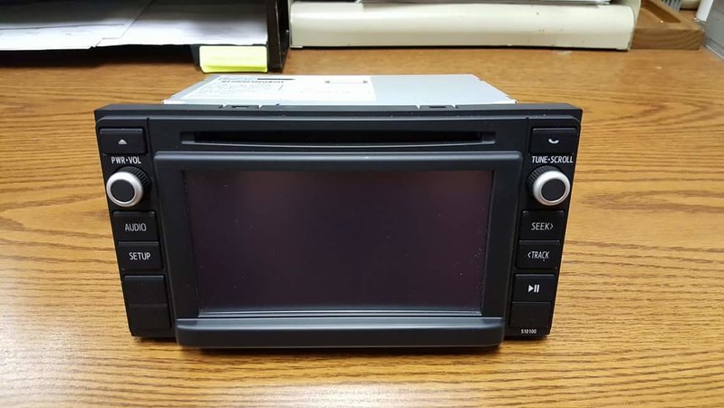

    Does anyone know if a touch screen will plug and play into a 12 I have a regular CD player right now the black one and wanting to put screen in it but didn't know if there was something I needed for it to fit thanks. Pictures below is the CD player I have right now and of course the screen in the other picture and it does fit perfectly just seeing what else I'll need to plug it in.

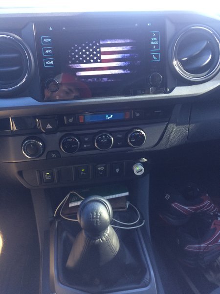

    IMG_2184.jpg Just did this to mine yesterday. Love it. Merica!
