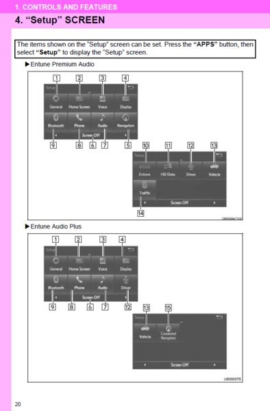

    You cannot disable the warning or make the startup go longer.
    The other isn't a shutdown image, its screen off image. Go to setup and hit the screen off button, the image will display

    For the startup image, no, it's only going to display for a second and then fade away.
    For the screen off image, go into setting and press Screen Off. The image will be permanently displayed on your screen until you turn it back on. You can still use steering wheel controls to change the audio, volume, etc.
    Also, there is no way to make an image display on the screen when the truck is off. You turn the screen off to see that image (not the truck).

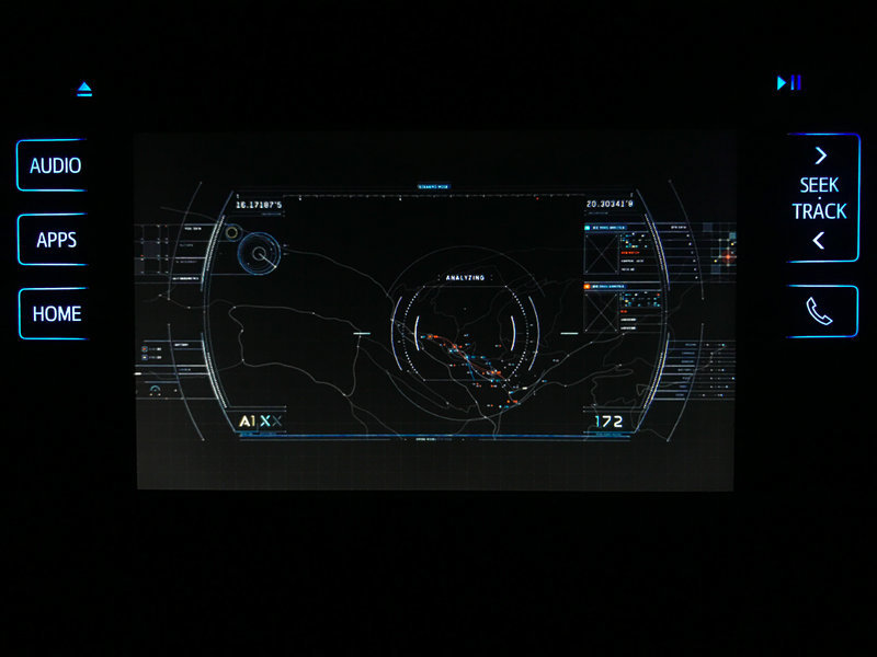

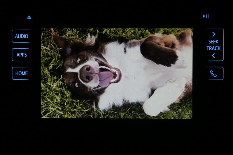

    Changed the start up and screen off images again! :goingcrazy:
    Start up:
    Screen off:
    You can follow this guide to change the images which is super easy. Other tips: resize the photos to a 1.669:1 aspect ratio (1803x1080, 4032x3024, 2722x1631, 885x530, etc), ensure the photos are under 5mb in size, save the photos as .jpeg file type, and format the USB drive to MS-DOS (FAT) for Mac users. Here's a link to some minimalistic HUD/GUI-type images that I compiled that can be used.
