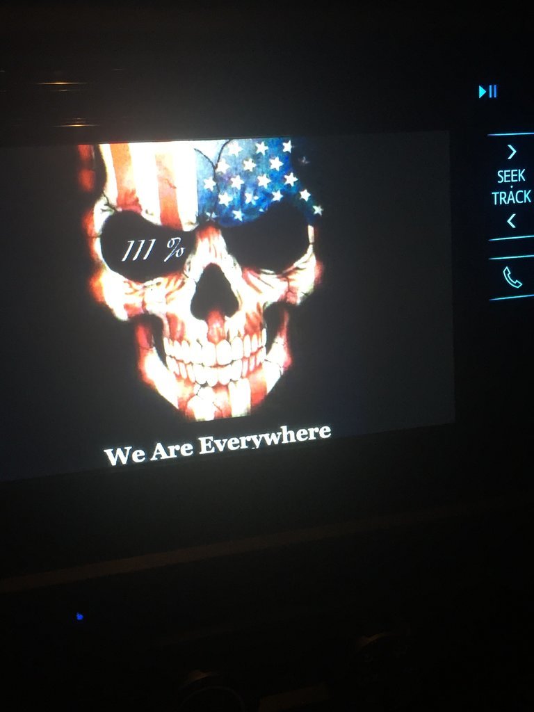

    Got it to work

    Do you have the actual picture? I would like to use this as well.
