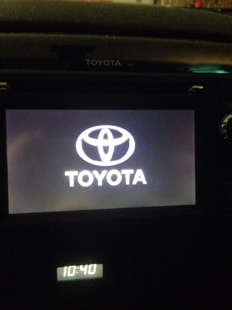

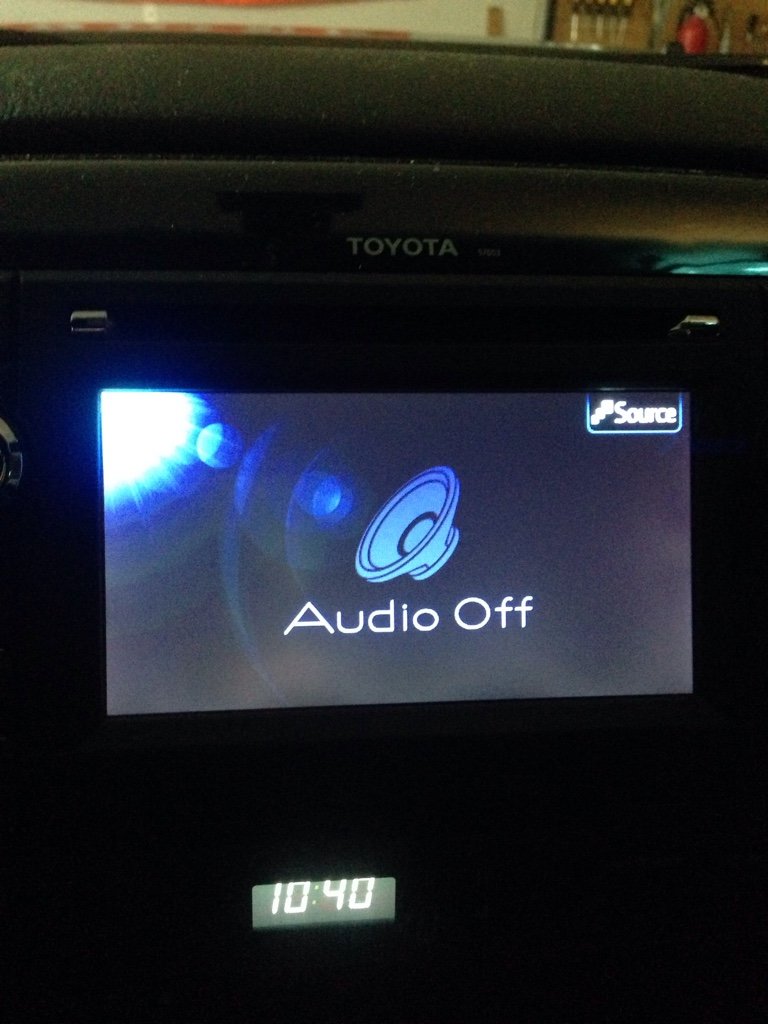

    Why don't we at least have the option to see the startup screen anytime:
    ....instead of this crap:
    I mean, the image is already in there, shouldn't it be possible to display that image, not just at startup?

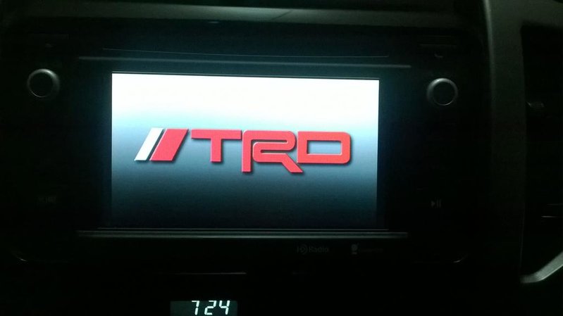

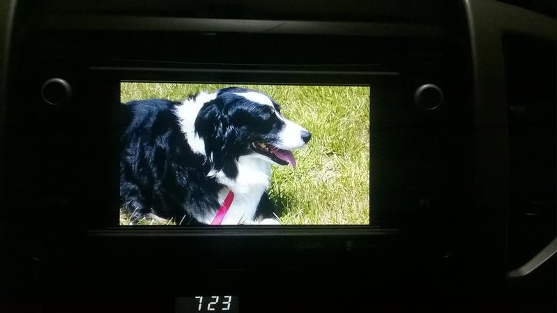

    For my startup screen I used semoak's original (post #100 in this thread), upsized it to 1280 x 720 and added a few things, like the red TRD and added a gradient background and drop shadows. Looks pretty good. I used my pooch for the audio off screen.
    I don't have flash so the dash and HU aren't showing up but you get the idea. Nice little mod for 14 and up models! I know people in this thread have suggested 50K and below file size, but the TRD one above is 60K and the one of my dog is 315K :eek: and they uploaded fine.
