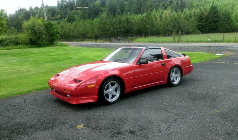

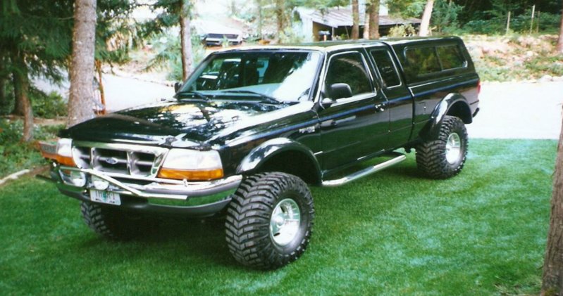

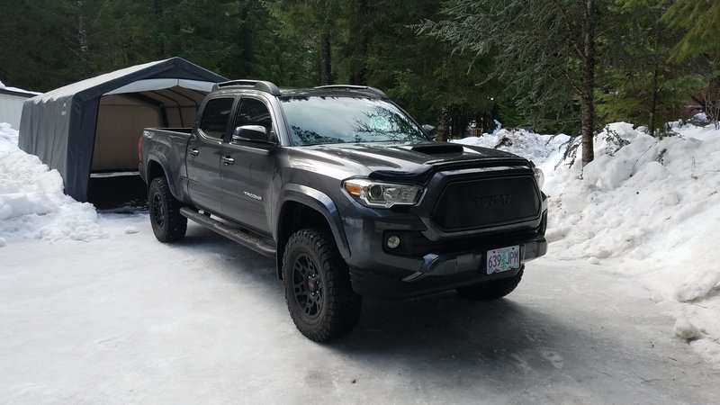

    Won't be able to get pics for quite a while. Mostly only noticeable in the sun. Won't be much sun here till spring. These are the vehicles. I think the different colored pads are first different levels correct..20161230_205937.jpg 20170122_174220.jpg 20170126_123023.jpg

    Good looking Ranger

    Thanks, that was my first build almost 20yrs ago. Too much money to finish the way I want so it's been neglected...
