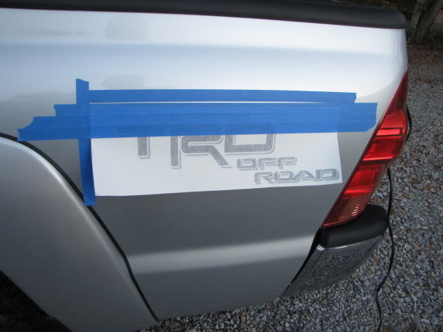

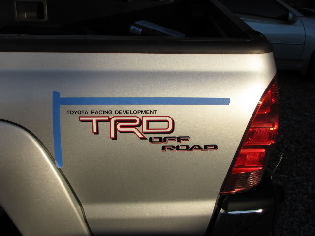

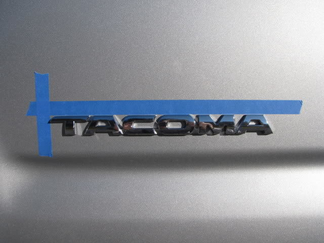

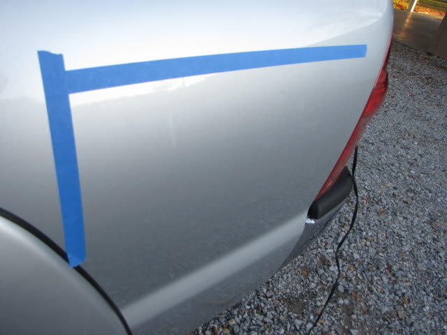

    The first thing I did was put masking tape along the front edge and top edge of the old emblem. If you aren't reapplying any badges then skip this step. This is your guideline for rebadging. I noticed on TACOMA that the C and O are slightly taller and that the emblems arent' always applied completely straight. So you may have to readjust the tape to make it striaght.

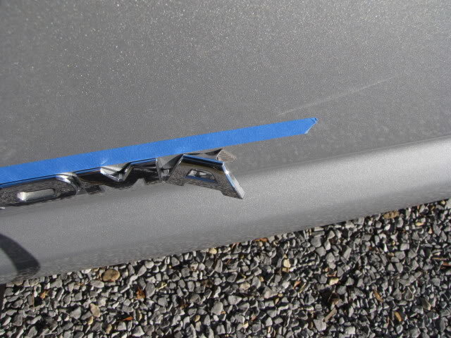

    If you are throwing away the emblems then it doesn't matter which method you use to remove them. If you plan to reuse them like after blacking them out then stay with the fishing line method so they don't get damaged.
    Fishing Line Method- run the line or dental floss from one side to the other using a sawing like motion and cutting through the tape.
    Pull Off Method-Take a smaller flathead screwdriver to pull up on the emblem. I found that each individual letter had to removed individually.

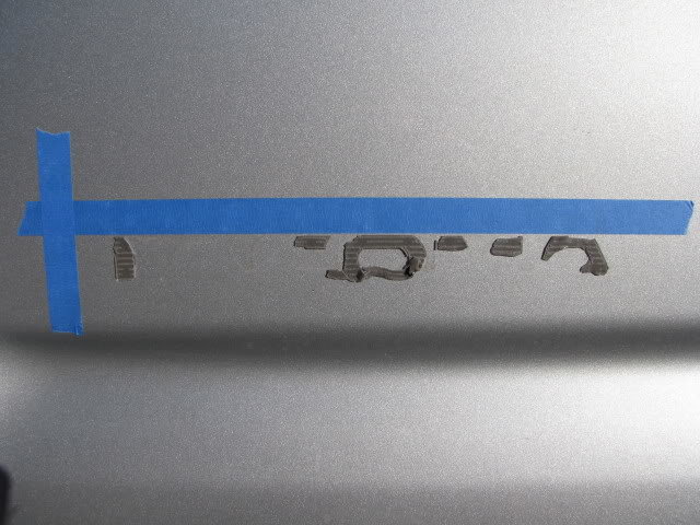

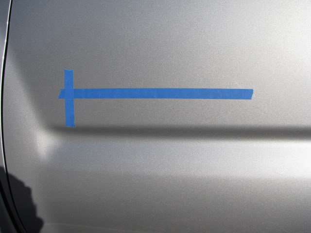

    You will be left over with double-sided automotive adhesive. This can be "rolled" off with your fingers.
    Now just take your adhesive remover and wipe off the left-over adhesive
    If this is all you want than enjoy!!!

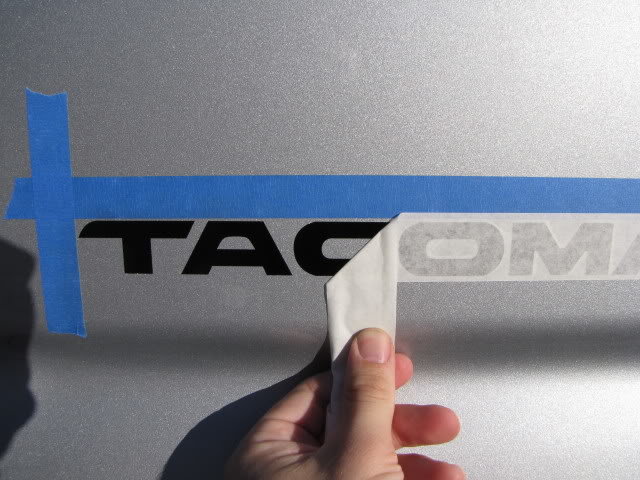

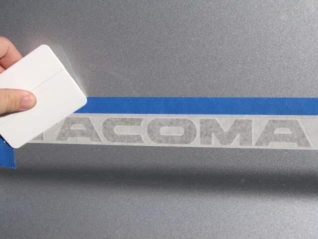

    If you have some new emblem stickers to apply then clean the area with glass cleaner and make sure the paint is squeaky clean.
    There are 2 methods for adding emblems.

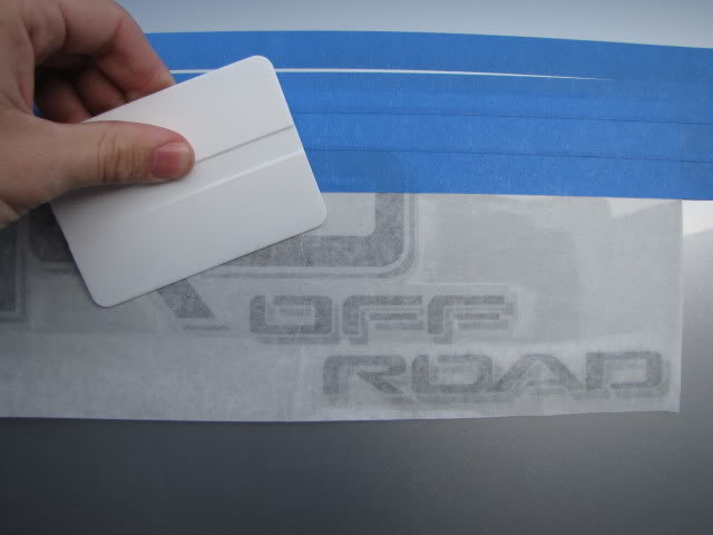

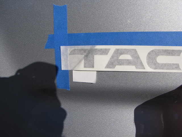

    Wet Method- this involves taking the spray solution and spraying the area then spraying the adhesive side of the emblem and applying it. Line up the emblem wherever you want. Then use a squeegy thingy and smotthen it out and remove all the air bubbles. It will stick and stay put after all the water is out from behind it.
    Dry Method- this is the way I did it. I lined up the front top corner with the tape and slowly worked my way to the other end with the squeegy thingy in hand smoothing it out as I applied it.
    remove the paper backing slowly and at a high angle. The angle will help keep the any letters from sticking to the backing.
    Remove the surrounding tape and remove any left over residue surrounding the emblem and BAM your done.

    TRD Stickers

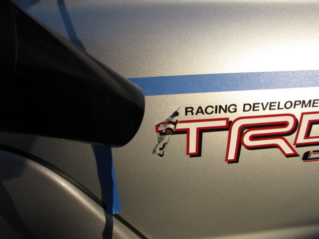

    In order to removed these stickers you will need a heat gun or blow dryer. Or if your lucky and its hot as balls and sunny outside you can let the stickers soften up in the sun a few hours and you won't need a hairdryer or heat gun.
    If you need to apply heat, a heat gun only needs to be used for maybe 10 sec. You can burn the paint. Not a good thing to do. I used a blow dryer on low, its a little longer but safer and more control of heat.

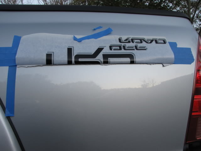

    If you are reapplying new stickers then make sure to use guide tape.
    Warm up the corner you are starting in and just peel it up with your finger nail. Someone was brave enough to use a razorblade layed flat against the paint without any problems. Not me.
    Keep the sticker warm where you are peeling and keep pulling. The warmer the sticker the better. I also noticed if you got to slow the more adhesive left behind. The faster you go and it will probably tear.
    Wipe away the adhesive BAM its done. If your putting on new stickers then clean it with glass cleaner for a squeaky clean.
    If you apply new stickers than I would not recommend the hinge method. This did not work well only because you have to tear the paper backing in the middle. The small paper flakes where the paper is torn made a line of paper stuff that couldn't be removed and ruined the entire sticker. :ugh3: Here are pics of what not to do. You can barely see the white line through the middle of the sticker.
    I removed the sticker after the pics because I was about to lose sunlight. I ended up applying the 2nd TRD sticker using the same method as the other emblems. Starting in one corner and working my way to the other end. Worked well for me.

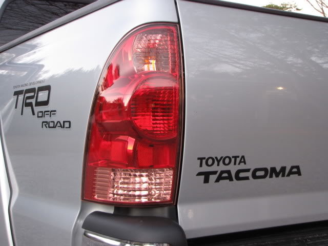

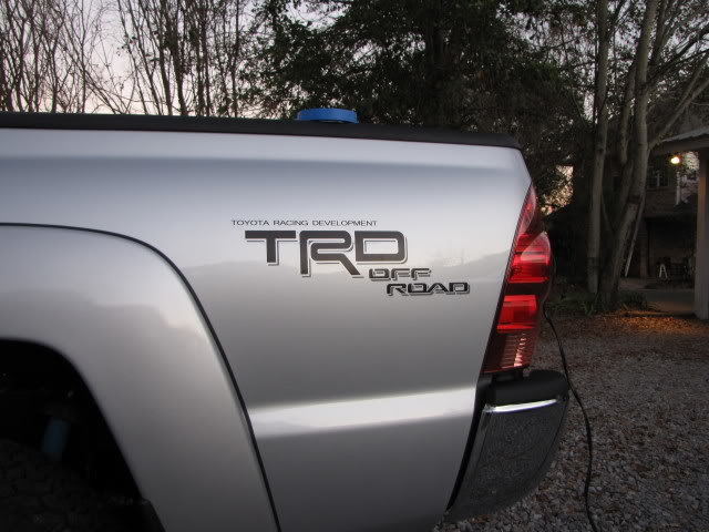

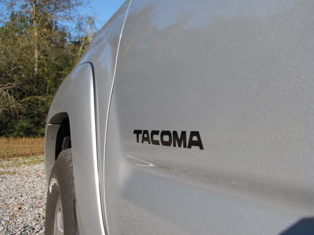

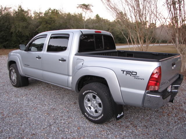

    Here are my final pics
    BEFORE
    AFTER

    i too, do not recommend the "hinge method".
    it works best to remove all of the backing paper at once and use water to prevent from sticking prematurely (premature stickulation....eww)
    it will allow you to reposition
