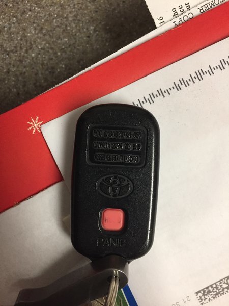

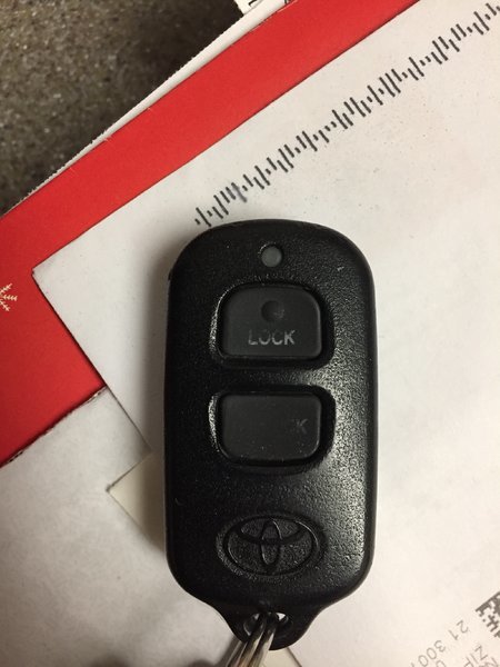

  16. Dec 8, 2016 at 5:03 PM
    #16
    TacoRMZ
    TacoRMZ Well-Known Member
    Dec 7, 2016
    #204278
    46
    Brady
    2001 Toyota Tacoma
    I have a 2001 Tacoma, power windows and locks but i'm not sure if it has the option of keyless entry. Anyone know?
  17. Dec 8, 2016 at 6:44 PM
    #17
    Sicyota04
    Sicyota04 Slowly but surely.
    Jan 9, 2015
    #145940
    2,629
    NorCal
    04 Tacoma DCSB TRD 4x4 V6
    Icon 2.5 Ext. travel coil overs, Camburg UCA's, rear Icon smooth body 0-3" VS 2.0's and a 2" AAL. Custom color matched retrofit HID 4.0 d2s projectors, dual switchback halos w/ RGB Demon eyes. Deck plate mod. Flow master 40 series. 4D optic 22" light bar & 4D optic Pods. 16x8 Method double standards w/ machined lip, wrapped w/ BFG KO2's. Steel grill insert by DB Customz. TG Front & Rear bumpers and sliders. Tundra Brake Upgrade. Complete Interior LED Swap.
    When I bought my Tacoma the Key FOB that came w/ it was broken to where you couldn't put a key ring on it. I just went to the dealer and bought one and they programmed the new one for me. I didn't want to chance buying the wrong one online. My FCC ID on my remote is the same as the red letters you provided besides the last 3#'s. Instead of -022. Mine is -056. But I don't have the Factory alarm w/ the blinking red light. For those of you who are wondering about if you have keyless entry, just go by the dealer & have them run your VIN#. I'm not saying you have to buy the Key FOB from them. But at least you'll know and they can tell you which one you need.
