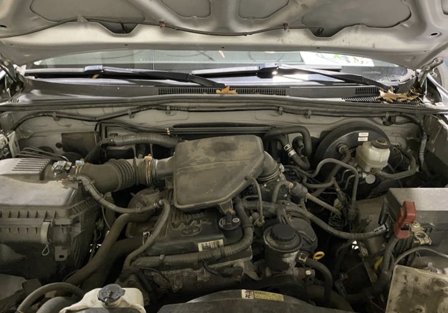

    I was Replacing my battery and noticed the engine cover was sitting off from level. A guy said it could be a broken mount. How do I determine if it’s true? Should I take it to a mechanic? Always questionable of mechanics?

    There's no engine cover on the 2.7
    That said, the black box on top the engine is supposed to sit at an angle. There's probably nothing wrong with your vehicle.

    Thanks guys! That black box is at about 10degrees. Just noticed it. THanks again. There isn’t any “clunk” so I’m in the clear
    I even wiped down the engine bay this past fall. H well.

    The 2TR sits at an angle - lower to the passenger side. If the engine lunges when cranking it, the motor mounts are loose - YouTube has many videos on what failing motor mounts look like.

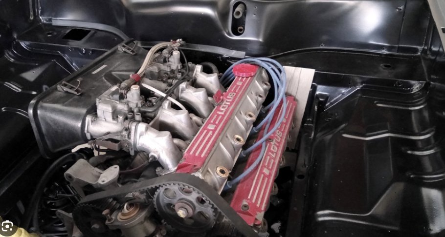

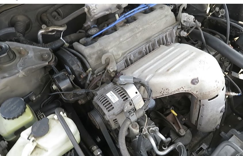

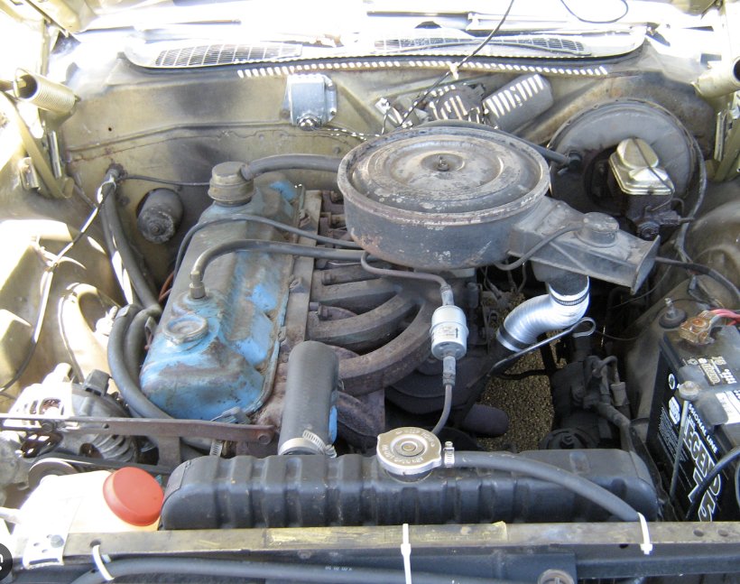

    Passers by always say that with slant engines.
