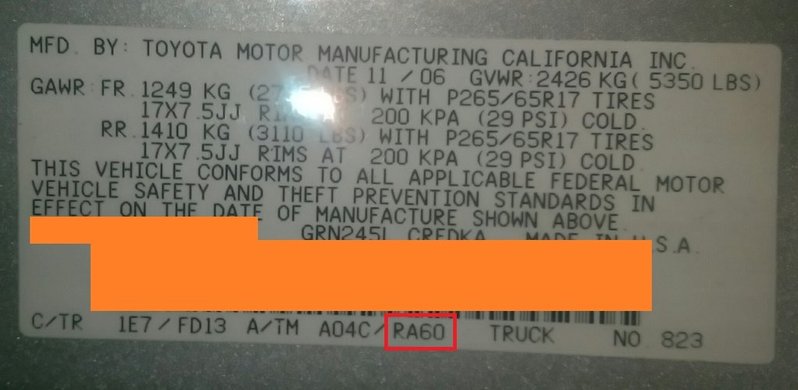

    It's also in the door jam on the sticker denoting the GAWR/GVWR, on the bottom edge below the barcode. You should see "A/TM" and then the next set of numbers/letters should tell you what it is. Mine had "RA60," but no "F" to denote the fact that it's a 4wd.

    You were right. Mine is RA60:
