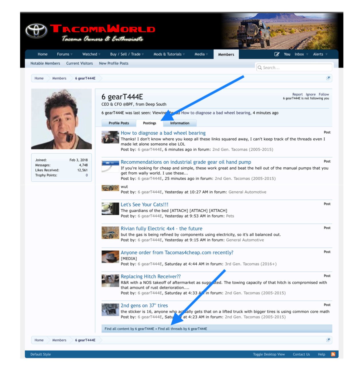

    If you can remember who posted stuff, it’s not too hard to find.
    You made it easy. All I had to do was find the thread started by you:thumbsup:
    And that was really easy, since you’ve only started 7 threads.
    I went to your user profile, then postings, then all threats started by you.
    6 gearT444E[QUOTED] likes this.
